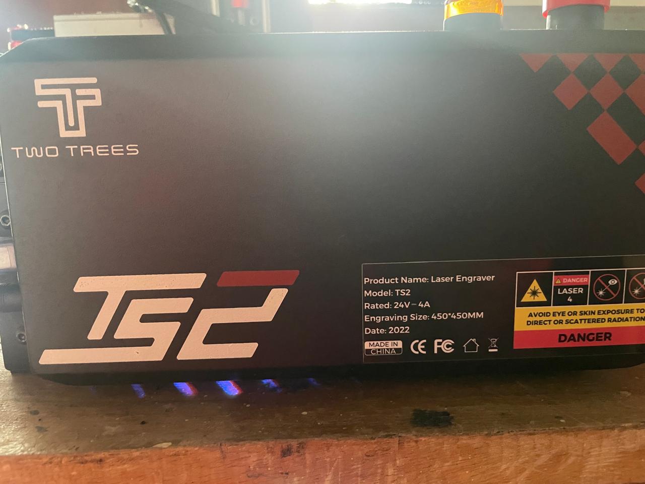

this is the specification of our mechine..I want to change the 10W diode heat to 20W diode
The Two Trees website shows the TS2 is now fitted with a 20watt laser, so it might be possible. Have you contacted them to ask if they’ll supply the 20w laser? https://twotrees3d.com/pages/contact-us
This is your best path to a valid answer is it is compatible.
