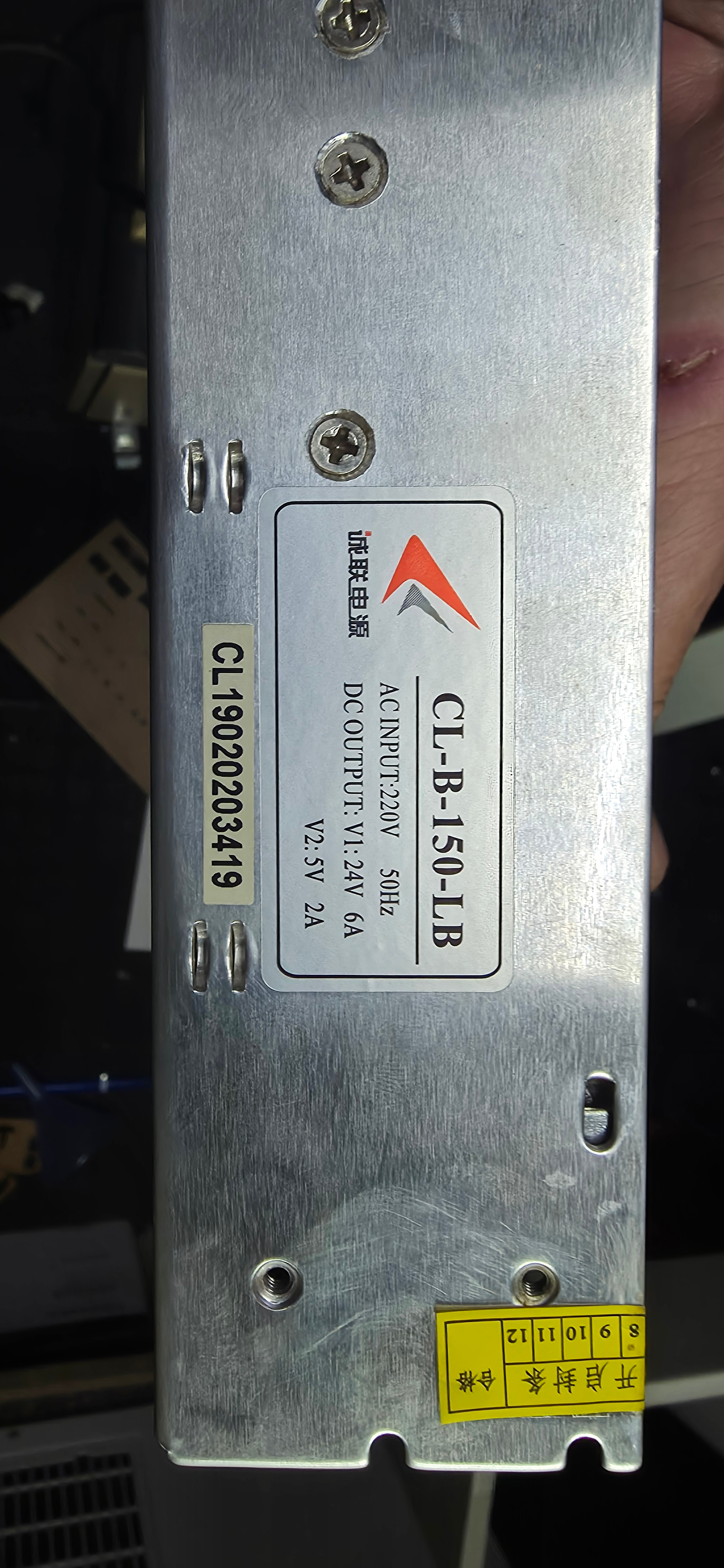

150w duel output 24v 6amp and 5v 2amp power supply
Hi. I am struggling to find a similar power supply. Can I use a larger supply. I have a 50w CO2 tube. Any help would be appreciated. I am in South Africa :south_africa:
Something like this?: https://www.aliexpress.com/item/32791950479.html
Or if you have space in your cabinet you could use two power supplies, one for the 24V and one for the 5V e.g.
24V : Mean Well LRS-150-24
5V : Mean Well RS-15-5
What was the larger supply you were looking at?
Similar unit.
200w
24v 10amp
5v 4amp
Yeah, that will be fine.
Okay thank you for you assistance
