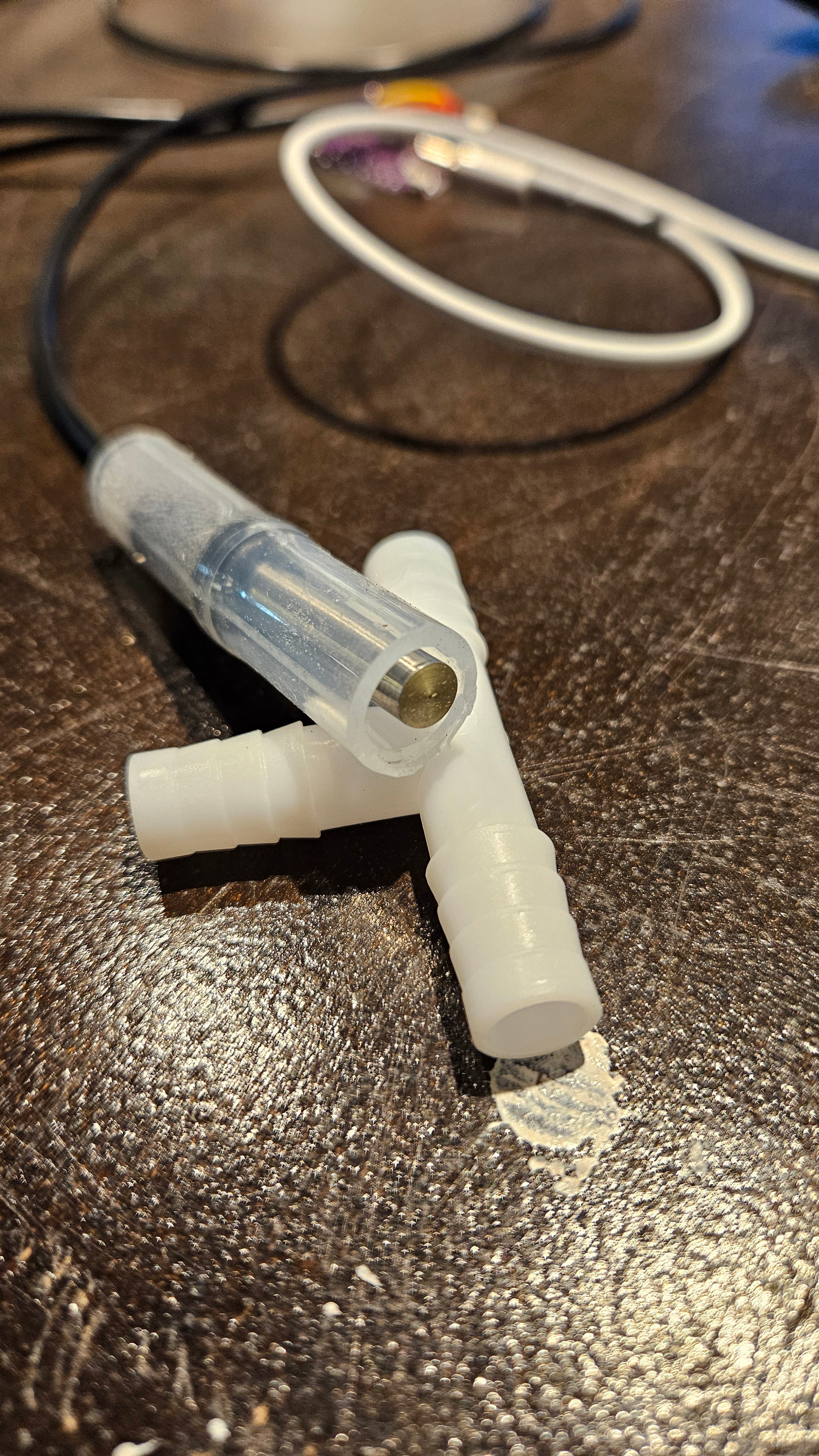

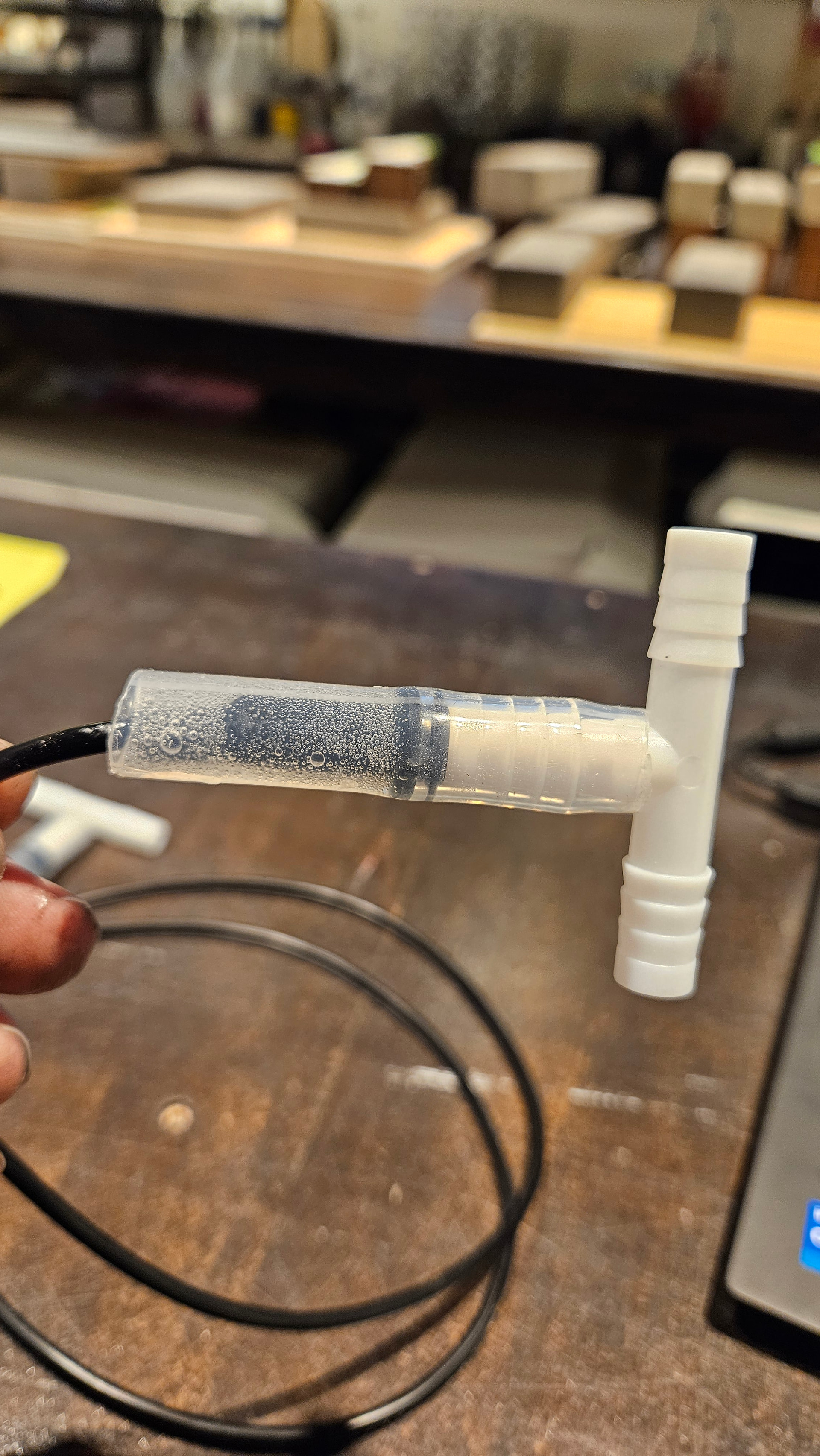

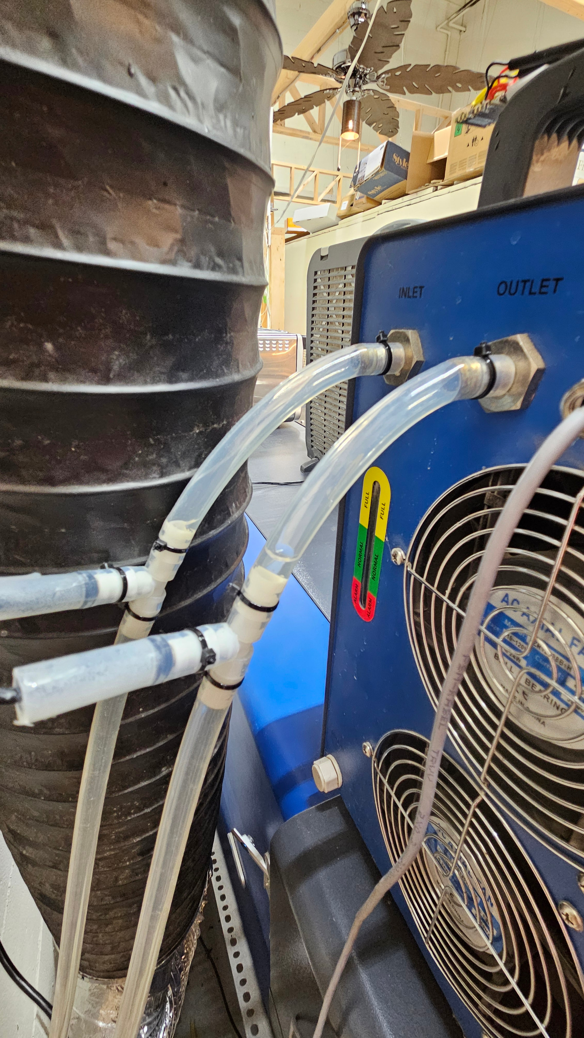

I installed my own temp sensors on the input and output water lines using ds18b20 sensors siliconed into T fittings. Now logging into home assistant (more on the later).
During this process, i cleaned the air filters on the chiller and raised the chiller up about 4 feet to sit on top on the machine, so i could see the display. I’ll probably move it back down later.

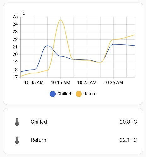

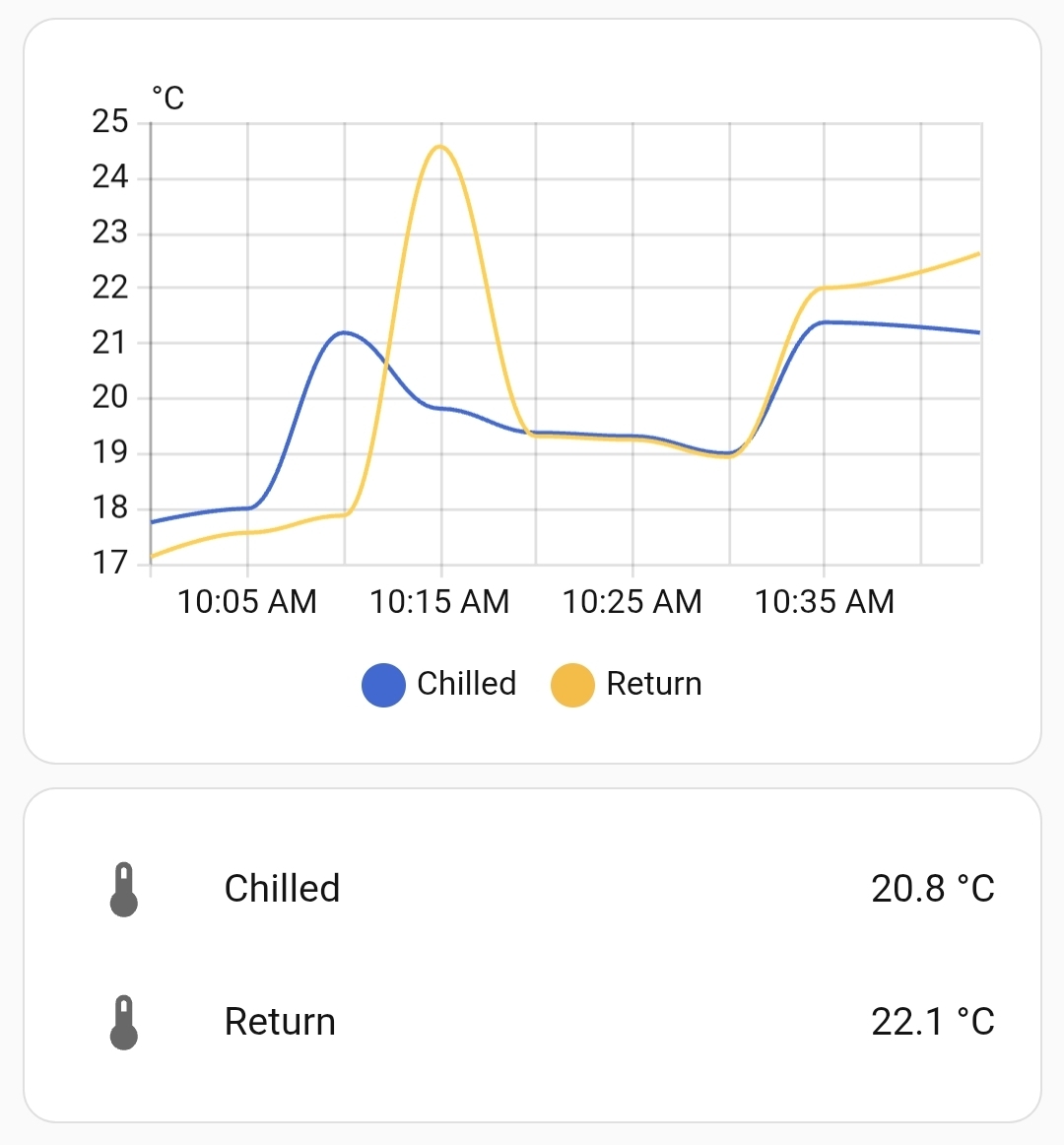

Now, as for the temp sensors, i installed them on 3 machines. It’s worth noting that there is a delay when the machine actually reverses the temp direction, and the return water is hotter than the chilled, obviously.
The point here is the water exiting your tube can be several degrees C hotter than your set point on your chiller!

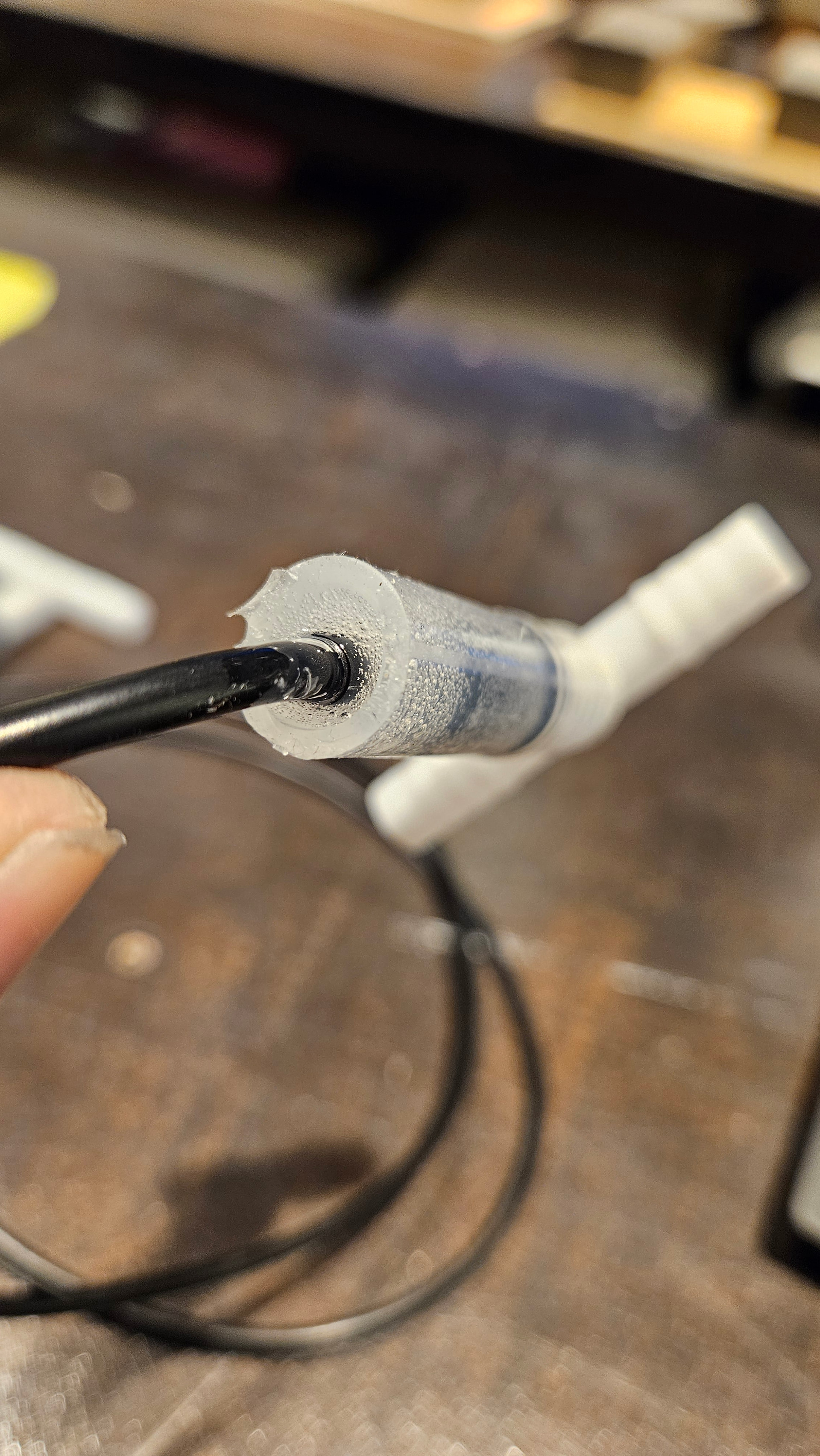

Here are some photos of the water temp logging and install.
FYI, this graph is not real world. The first spike was before the install. when the lines come together the cooler is flowing but no laser running. When the return deviates upwards, the laser is running the test run.

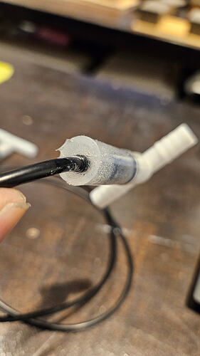

Temp sensor install. The temp sensor has a gromet around it, shoved into silicone tube and filled with 2 part epoxy silicone, behind the gromet only. The tube is then installed onto the barb T fitting, and the temp sensor (inside the stainless probe) slides into the T, making sure the sensor does not go in so far that it blocks water flow. The water just passes by and can flow slightly around the temp probe.
