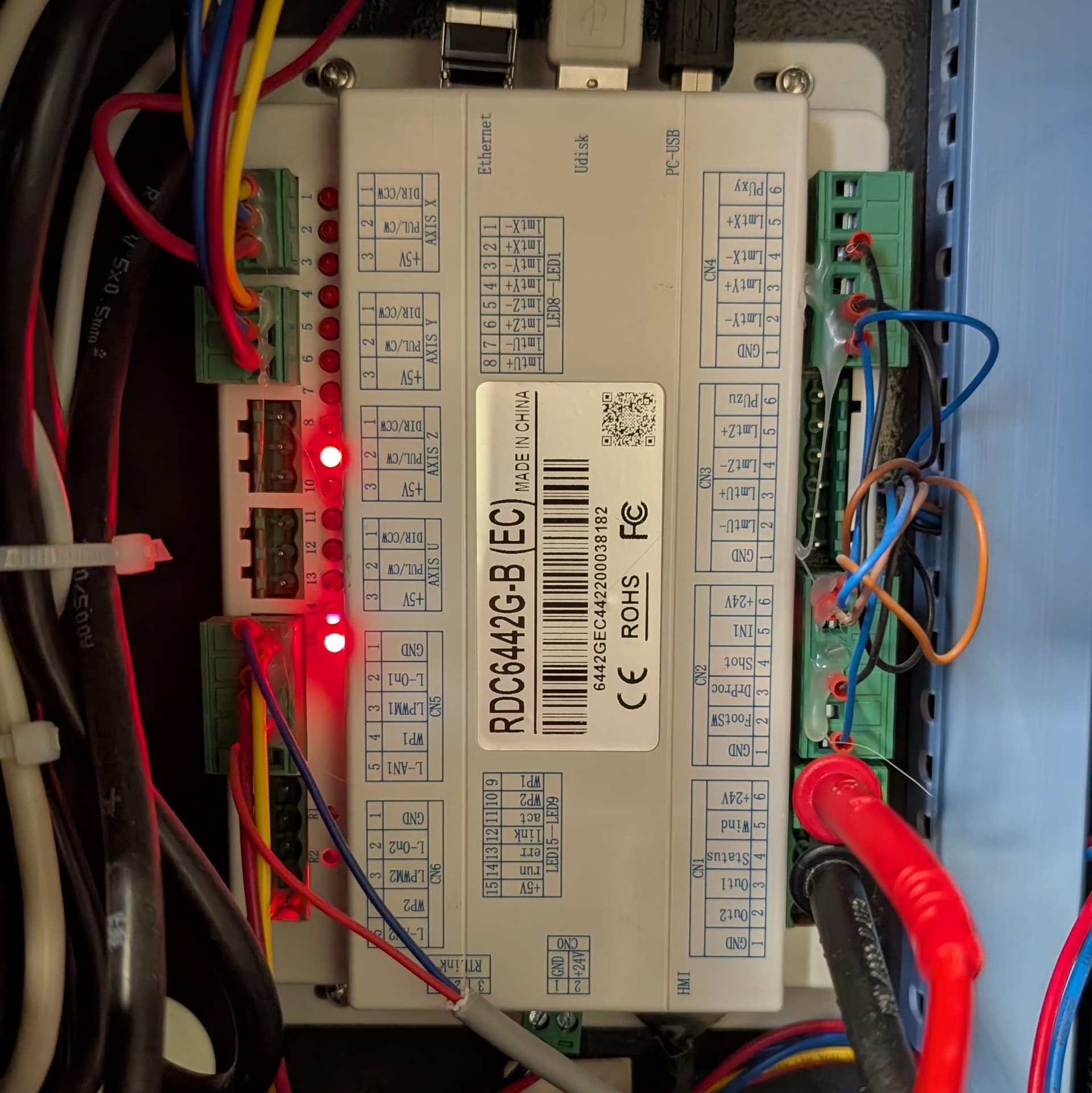

So currently i am trying to setup an external air assist with a 24V solenoid valve on my 80W Co2 (Ruida RDC6442G).

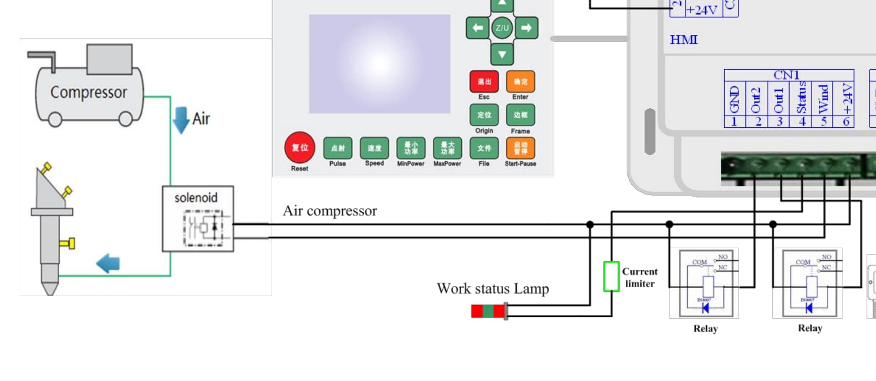

As the documentation indicates, the solenoid valve needs to be connected between the 24V pin and the wind pin.
I am measuring around 16V between 24V and “Wind” at idle. When i start a job with Air Assist turned on (in layer settings and in vendor settings) it drops to around 14V. That does not seem right. Between 24V and Ground i am measuring 24V. Between 24V and “Status” im measuring 0V at idle and 24V during operation.
So should i hook my solenoid between 24V and “Status” instead? Or is my controller broken. Because the documentation clearly shows hooking the solenoid up to 24V and “Wind”, which also makes more sense, but the solenoid valve obviously will not work in this configuration.
I tested the solenoid valve seperatly with an external 24V source, and it works fine.
Anyone knows something?
And it’s not.
The RDC6442G manual says the output current on each pin is limited to 500 mA.
If the valve draws more than 500 mA at 24 V or if it does not include the clamp diode shown in the diagram, then it may have damaged the controller’s output transistor. If so, then the output will never work correctly again.
A DC-DC solid state relay requires much less current and can handle a robust valve without trouble. The reduced drive current for an SSR may allow a damaged transistor to “work”, although that’s not guaranteed.
You wire the SSR’s input terminals to the controller the same way as the valve. The valve then goes between +24 VDC and the relay, with the other relay terminal to GND. You can also wire +24 VDC directly to the SSR, the other SSR terminal to the valve, and the valve to GND.
Perhaps the sketches of what I wired up for high-low air flow will help.
It’s certainly worth trying, because right now the valve is beating the poor controller output to death. :frowning_face:

The difference between status and wind is that status goes low anytime the machine is in run mode or executing a layer. Wind only goes active low when the machine is executing a layer with air assist enabled.
I’d plug it into Status and see if it works.

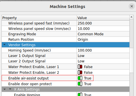

If I remember correctly, Wind output has to be enabled within the Ruida. Did you do this?

Yes. Air Assist is enabled in both the vendor settings, and the layer settings.

But i’m still confused: To my understanding, if the machine is in idle, I should measure 0V between 24V and Wind. And when start a new job, i should measure 24?
Or am I very confused right now…
Both are correct, give or take a few volts.
Assuming the output transistor is damaged, it cannot conduct enough current to pull the low side of the valve coil to GND as it should. As a result, the voltage remains higher than it should and the valve does not work.
If it were completely destroyed, it would conduct no current at all and the voltage would not change. I hope it’s not in that condition, but the only way to know is to use an SSR to see if the transistor can conduct enough current to run the SSR.
Ok, but why does the voltage drop, when I start a job? Shouldn’t it rise, even if the transistor is damaged?
Currently im only measuring with no valve connected. 16V when idle, 14V when running.

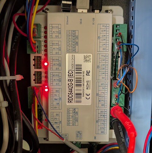

I see. And if i measure with no valve connected the same happens?
I believe there is a pull up resistor to ensure the transistor switches.
Ah. That changes things. I assumed you were measuring the behavior of that pin with the valve connected.
The controller output is a transistor operating by switching current, but you’re measuring with an instrument designed to pass essentially no current at all. As a result, the voltage on the controller pin doesn’t behave as it will with the current through a real load.
If you have not yet connected the valve, you may choose believe either Jack or me concerning what you should do next. :grin:
I believe these to be open collector outputs with pull up resistors, so they should work and show correct voltage values, either on or off.
Mine read full rail voltage and go to zero when active.
Yours doesn’t work the same?
It surely depends on the controller, but the RDC6442G manual says “All outputs are isolated through the optocoupler, and 500mA current for each, OC gate output”. I assume the output is a bare optocoupler transistor without a pullup, but I have certainly been wrong before. :grin:
If it has a pullup, then the voltage to ground should behave properly. Obviously, it doesn’t, but I can’t say whether that’s a damaged output transistor or a side effect of using a high-impedance voltmeter as a pullup resistor.
