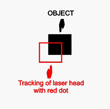

Imagine any given spot on the template that I’ve drawn a 1" square in the software as a vector. I’ve placed objects inside the bed that size or larger or smaller. Used the camera view to place the square vector around that object and activated the Framing function. The route taken by the laser head if off in the direction by about a half inch or so both to the left of the object (-x) and (+y).
Laser homes in upper left corner.
Making changes in the offset of the camera view (and taking screenshots of the changes) has no effect on where the laser head tracks around said object regardless of where it’s at on the laser bed.

I’ll draw it up in LightBurn and post a detailed description in that picture.

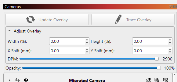

If possible, do this thest:
  • Change the Start From value to Absolute Coords
  • Engrave a simple rectangle on a piece of wood
  • Capture Overlay in the Camera window.
  • Check whether you have any offsets under “Adjust Overlay” here. Set them to 0 if they aren’t already
  • Send us a screenshot of the entire LightBurn window, so we can see how far off the overlay is.
I had tried that before as well but it didn’t have any effect on it being off. I came to the realization late last night that everything should actually be zero’d to start with and work from there
Shut everything down as I normally do at the end of the day and went to the house.
So before I read your post just now, I’d already set everything to 0 and then I moved the square directly over where the item was that was laying on the bed. Then framed and it worked.
