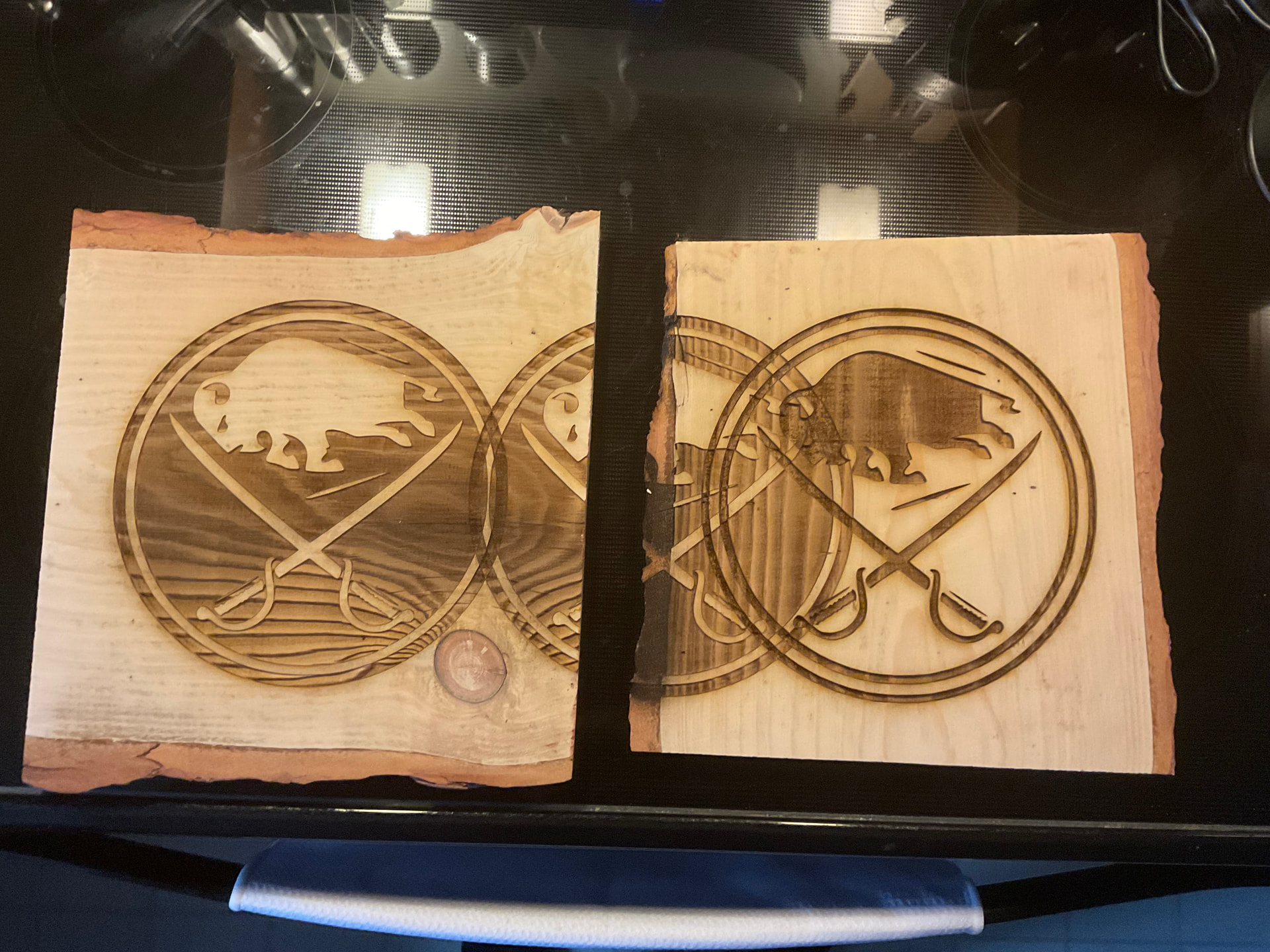

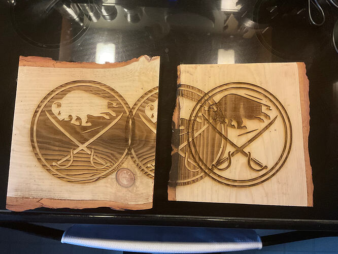

I am having an issue when I try to do multiple passes on a project. See photo. I am using a monport Reno 65 co2 laser and this issue will arise after running maybe 10 different jobs. The second pass seems to be off by half the size of the image. The photo shows the right side worked ok but when the machine went to the left it was misaligned. If I delete the machine from lightburn and then reinstall it, it works ok till it doesn’t. Any help would be appreciated

Explain to use, what you’re trying to do. From what I can see you’re lasing an image or design and the second lases over the open spots…

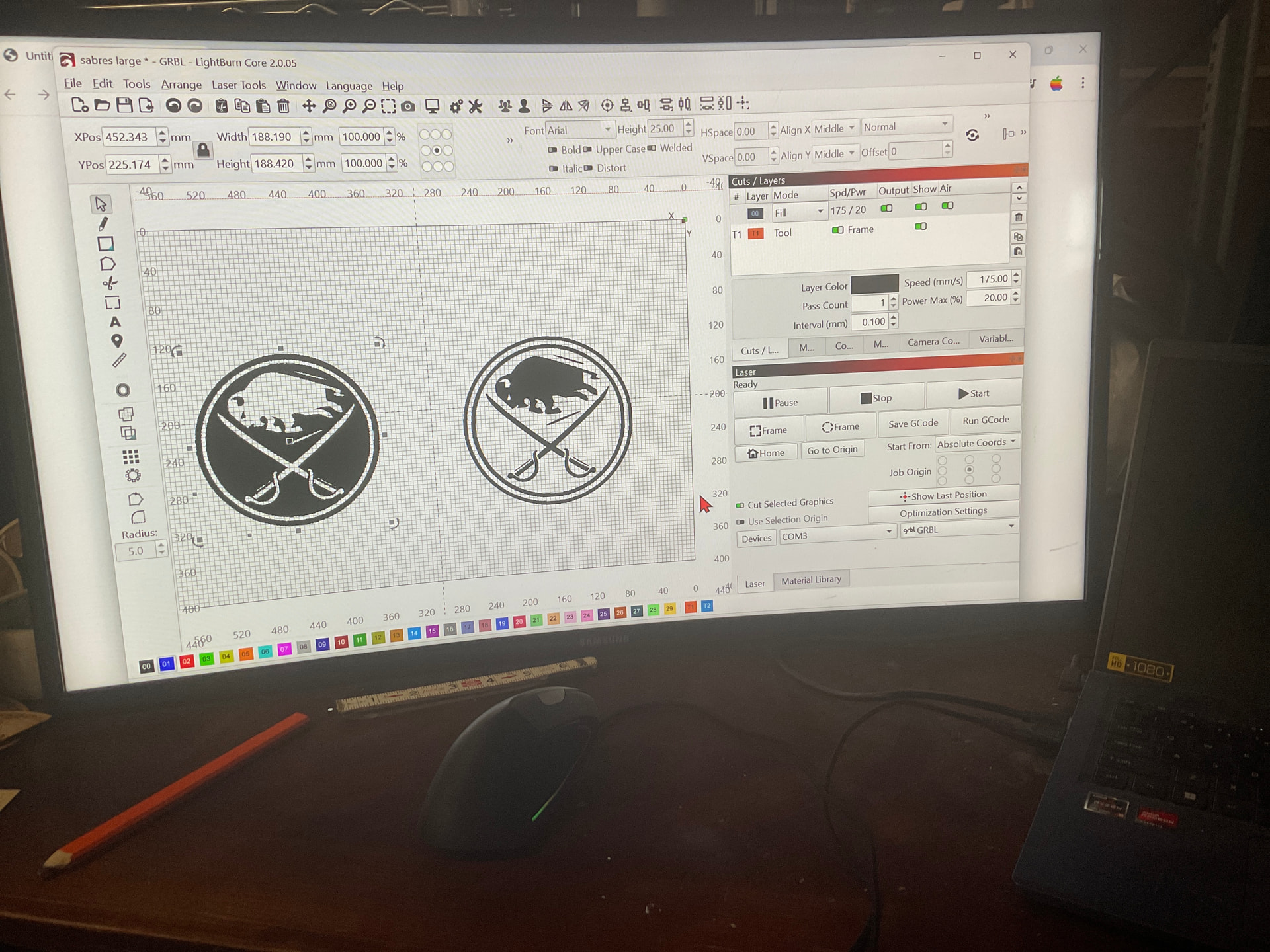

This is the two images and how I have them setup. I have never used anything but absolute coordinates. I don’t really know how to use the others. I am not using a jig as the material I am engraving on is irregular shaped. Ever one is different. I also just tried to frame the highlighted image (left side) and the machine frames to the right
Turn off the Frame switch for the Tool layer and see if that helps.

I removed the frame tool as it wasn’t needed. I homed the laser and used the rubber band frame and was able to frame just the left design as it should. When I framed the same with the square frame tool from the finish point of the rubber band frame it worked fine. So I homed the laser and ran the square frame tool and it outlined where the right image is, which isn’t highlighted. I hope I’m explaining this so you understand and thank you for your help

There is something strange about that file. I causes my laser to do strange things like home in the wrong corner, although front left is selected in the Origin part.

I played with it after fixing my machine size parameters. Your design just barely fit side by side in my setup. I did not resize anything, but I did move them onto the grid.
In the file I attach below, I cannot duplicate what you say happens. Click on left logo, it frames left. Click on right logo, it frames right. Select both, it frames both.

It has a draggable Guide line parallel to the X axis that’s 20 meters long with the Tool layer’s Frame switch set On, which will certainly cause problems if the Ignore out of bounds shapes switch is set Off.
I tried my original file again and the framing worked as it should. right framed right and left framed left. this is what makes this issue frustrating, I may be able to run the engraving of both images together and it will work but then if i try a second pass it does what my original picture showed, wasting time and materials.
I see that guide line. I didn’t put that in the file but I have had that appear on other files i have created. Don’t know how but the ignore out of bounds shaped is on.

I am sorry, but I could not duplicate what happened to you. I had to reduce the designs to 3”, so it would run in 30 minutes, because there was no way I was going to wait 2 hours+.
When finished, I did a circular frame on the left side, then the box frame. I then selected the right side and did a box frame. It framed properly.
Based on your later notes, I am wondering if this was a one time incident, and it did not repeat with the file I uploaded?
