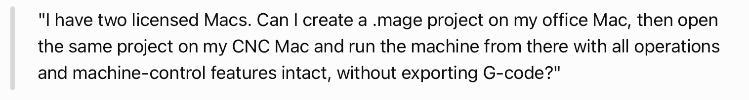

2x iMacs: one in office for design, 2nd at the CNC to run the job
Hi there!
Yes, if both machines are synchronized (easy using Bundles), then a Lightburn .lbrn2 file created on one will run the same on the other.
Yes but I’m talking .mage ?? Should be the same?
Yes, you can transfer the mage file from one to the other. I have done this many times. The tool settings are saved in the file under Project Tools.

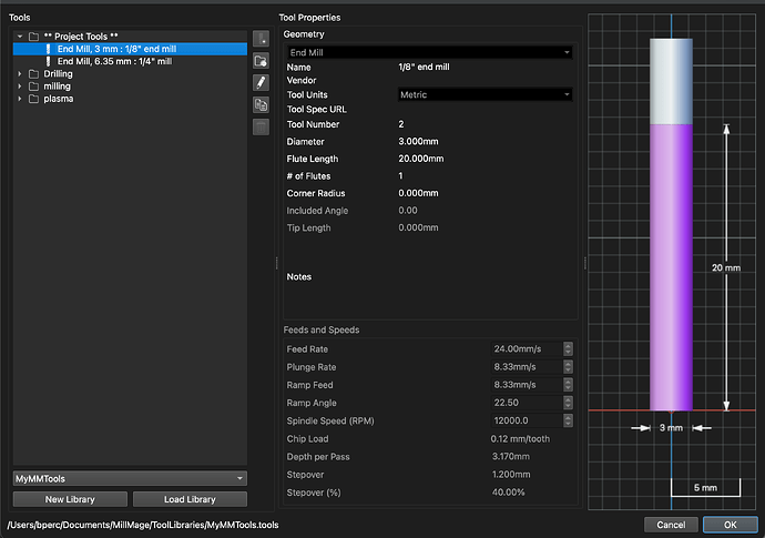

cant find project tools any where ? can you point me in the right direction please
Pat
Sure Pat. Click on Edit Tools and then you will see it in the upper left.
A mage file will have all the operations and tool parameters it needs embedded in it (**Project Tools**) at the time it is saved, so in essence that’s all you need, however;
-To create a mage file, you will need your device profile, and your tool library present.
-To run a mage file, you need a device profile also - preferably the same one used to create it.
