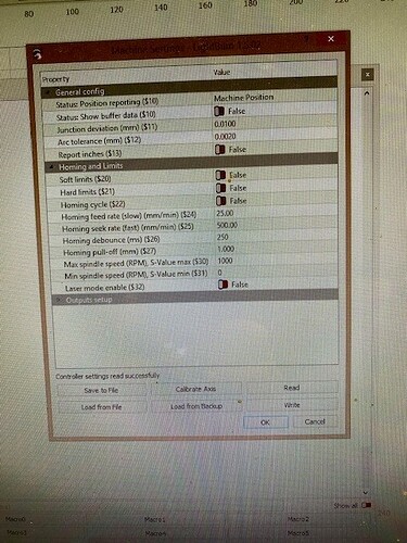

Hi there - relatively new to lasering - when i set $32=1 i do not get any output onto my stock (ply), but when i $32=0 i do get output but also the travel lines - it did work some time ago but i have somewhere (i dont know where) changed a setting and any help would be much appreciated - using Grbl, small 3 w laser - screenshots of setting attached - many thanks in advance!
my $$ settings are:
$0=10
$1=25
$2=0
$3=2
$4=0
$5=0
$6=0
$10=1
$11=0.010
$12=0.002
$13=0
$20=0
$21=0
$22=0
$23=0
$24=25.000
$25=500.000
$26=250
$27=1.000
$30=1000
$31=0
$32=0
$100=800.000
$101=800.000
$102=800.000
$110=2000.000
$111=2000.000
$112=600.000
$120=30.000
$121=30.000
$122=30.000
$130=200.000
$131=200.000
$132=200.000

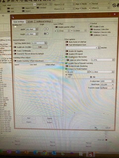

What is it set to in device set up. Should be just set to GRBL.
Did you update any software?
hi there - thanks for the reply - running latestr lightburn, think set to Grbl - not sure how to check!
Click on devices in laser window.
