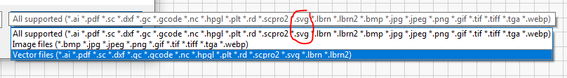

Does that mean we will be able to import svg files sometime in the future? I.E. is this planned?
3D Sliced mode exists today:
3D Sliced Engravings - LightBurn Software Documentation
You’ve been able to import .SVG files for a LONG time.
My goof… I meant stl files, for 3d … sorry guess the fingers are use to svg…
The 3D slice mode for galvos works with grayscale depth map bmp, png or jpeg images, not STLs.
I can only guess, but I’d assume that at some point they will, but that’s ultimately a question that only LightBurn developers can answer.
