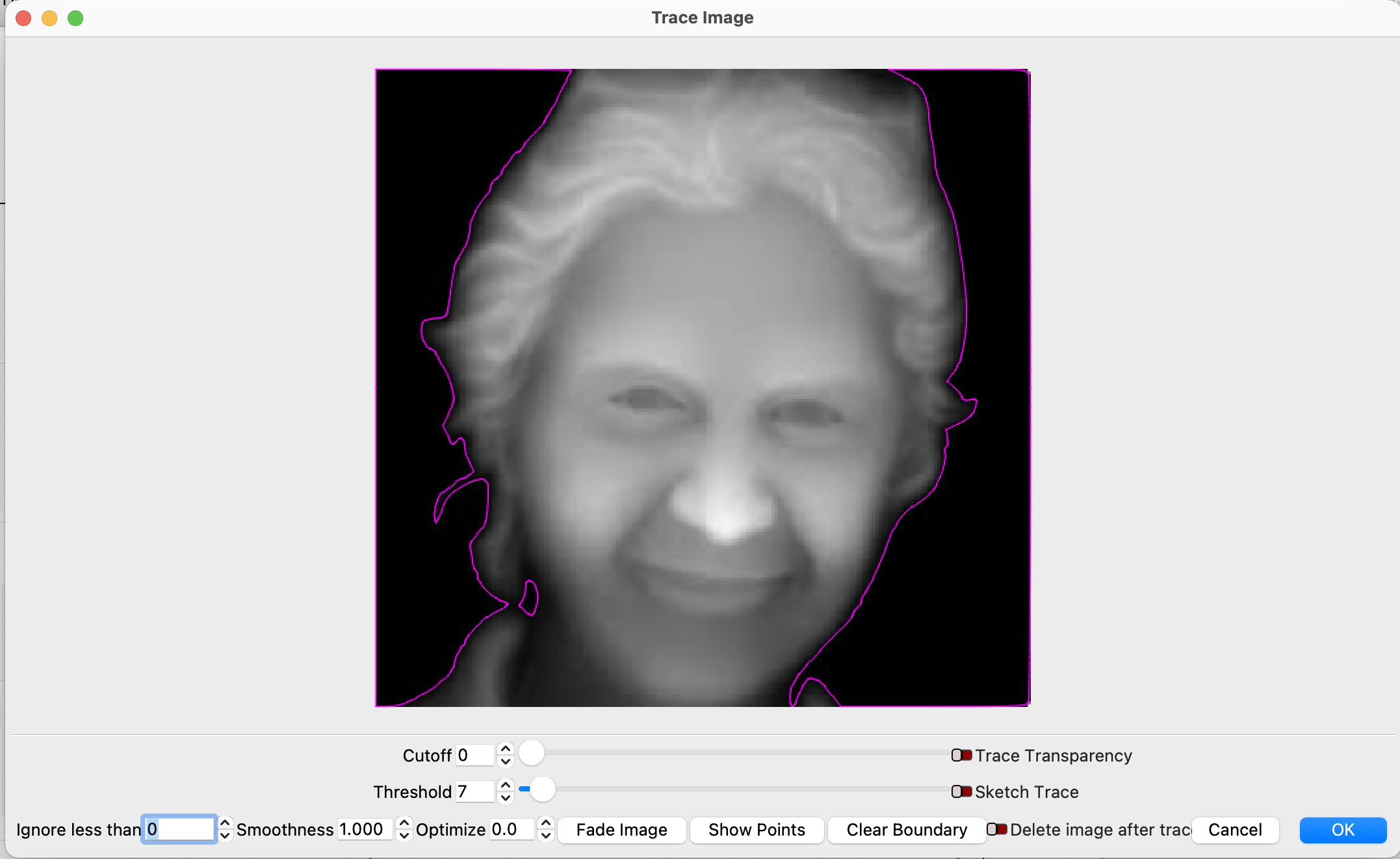

When 3D Slice a depth map for coin engraving and setting passes to 255, the last pass (level 255) is the deepest and the “background”.
Since LB creates 255 images to engrave, after it’s done, I don’t see a way to go to the LAST level (255) and just ask LB to redo that one again BUT i want to do a different setting (BLACK to make the background the best black possible)
How can I get LB to provide that last image so I can use it again for my final engrave to make the background the blackest possible.
\*Please note, I’m not asking for a fill over everything.. I need the image LB creates in the last (deepest) level of 255 to only engrave those areas.
I hope this is possible.
Thank-you in advance.

There is an existing feature request in Fider that I would encourage you to upvote:
[Access to the slices created by using the 3d slicing feature · LightBurn](https://lightburn.fider.io/posts/2342/access-to-the-slices-created-by-using-the-3d-slicing-feature).
To select a near-equivalent of the last pass, use the [Trace Image](https://docs.lightburnsoftware.com/1.7/Reference/TraceImage/) tool and move the ‘Threshold’ slider all the way to the left to zero.
Move the slider to the right to include more in your background.
If you had a 3-pass 3D Slice job, then you would move the Threshold slider to 1/3 of 255 to get the last pass.
 ![image](https://forum.lightburnsoftware.com/uploads/default/original/3X/e/6/e6adaa9546c56bffa89189d004949882993aba55.png)
Use the resulting trace as a fill and re-process the last pass however you need.

> [@jkwilborn](#):
> How do you suggest handling a 512 pass image? Or more likely 256 passes.. How do you adjust the preview?
Adjustment of preview? That would be difficult to do with many passes.
(As a new feature, it might be neat if the preview could somehow include a spin box showing the pass number changing as you drag the time slider “through” a 3D slice operation, and allowing for manual fine tuning so you can ‘start here’ at a specific pass.)
I had suggested using the Trace Image tool, where you can fairly easily select all the pure black pixels that would be the target of the last pass of a 256+ pass job.
Using Trace to visually select the pixels that represent the background will allow you to setup a final layer for your “BLACK” fill strategy.

It think it’s if you have two passes, you move it 1/2 way, 3 passes move it 1/3 of the way from the end, 256 passes then move it 1/256th of the way from the end.
Easy with a few passes… this could be difficult with more passes. I tried it with one of my scans.
There is a feature request to make all of these generated levels be available to the user. This is probably the best and most controllable approach. Combined with using the _ **threshold** _ will give you more control.
I could not get it to work correctly, but haven’t spent much time trying.
> [@detroit](#):
> 255 levels of black
There are actually 0 through 255 in the way of values, this relates to 256 available steps..
Think of it as a _ **label** _ for each pass, not necessarily low to high power, but created layers labeled 0 through 255 for 256 unique layers that it’s going to build. These resolve to the power, but you can’t ignore zero.
From Oz on how this works in the [beta area](https://forum.lightburnsoftware.com/t/3dslice-operation-simple-details/98681/5) which you likely need access, so I’ll paste it here:
_ **With 3D Slice, each pass is thresholded to the current threshold value, and the result is run as a 1-bit image. If you use 256 passes you get exactly one pass per gray-level in the image. Every pixel at or below brightness 255 for the first pass, every pixel at or below 254, then 253, and so on.** _
_ **If you choose 128 passes, you get every pixel at or below 254 for the first pass, then 252, then …** _
_**It “clusters” the layers together into batches if you use fewer than 256 passes, and will duplicate some layers (with even spacing) if you use more than 256. 384 passes would duplicate every 2nd layer. 512 passes would duplicate every layer.**_
Make sense?

> [@detroit](#):
> Could you explain the math for a moment.
The 1/3 was just an example - to show the math (if your job only had 3 passes), but please ignore the math and just use the threshold slider of the Image Trace tool (not the slider in the job preview) to _visually_ extract the most suitable 1-bit background image as shown in my [post above](https://forum.lightburnsoftware.com/t/3d-slice-with-255-passes-how-to-get-lb-to-provide-me-the-last-engraving-image-from-the-last-pass/174205/5), because the background will likely be better represented by an image that combines the area of _several_ of the most deepest levels.
