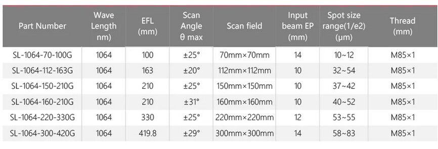

This is from Cloudray, showing lens focal length (EFL) and coverage (scan field) for a few lenses.
 ![image](https://forum.lightburnsoftware.com/uploads/default/original/3X/c/2/c2bf64b8f713fb328d85a20b60cc455cec22c286.jpeg)
It shows the focal length and coverage area. Notice there are two 210mm lenses, depending on your available scan range.
Notice your spot size with one of your lenses, then the other lens. Reducing the lenses focal length will make the spot and the depth of focus get smaller. You can use this with your Raycus manual to compute approximate spot size… The more accurate the data, the more accurate the results.

My spot size of an F254mm is about 30 microns whereas an F100mm lens is about 15 microns. Changing spot size puts the same amount of power over a different size area.
Cutting the diameter in half, going from 30 microns to 15 microns, has an apparent power increase of 4 times. Same power, just a smaller area, but the operator will notice it.
I need room for me to see and have the ability to get in there, so I pretty much use an F254mm most of the time… It’s got a pretty small are and a good depth of focus.
