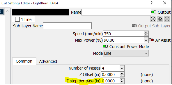

I ran a cut test on 4mm Baltic-Plywood from Menards. Running at 90% power, and if I remember correctly, at 500mm/m. To cut through this plywood it took 18 passes to start seeing flicker of the laser underneath, and 20 passes to be able to push the cut free with minimal strands of wood holding it in place.

Assuming this is about a 5watt laser, 20 passes seem like a lot. I would slow speed down and up the power. Also, you have a cnc so assume also that Z axis is functional. So, I might try moving z down a small amount with each pass.

Z axis adjustment by how much? Any guidelines?

Z step per pass. I would move it down as much as depth of cut on each pass.
So it shows the following…
“When doing more than a single pass over a shape, the Z step per pass setting allows you to tell LightBurn to raise or lower the laser with each pass by some amount. This is most often used for thick cutting or deep engraving, allowing you to shift the focus point deeper with each pass to help maintain efficient cutting.”

In my version of Lightburn 1.4.05, I show the Z Offset line, but no “Z step per pass”.
Why is that?
Correction, on my laptop it doesn’t show, but on my desktop, it shows.
