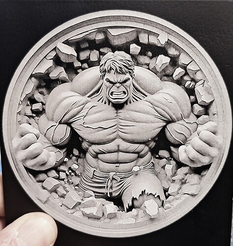

60 watt MOPA Fiber 150 mm Lens engraving Wood
sand wood 400 Grit
1 coat Flat White \_Dry
1 coat Flat Black \_Dry
2 passes
1000/13%/800kHz/100 ns
Stucki Dither 423 DPI
