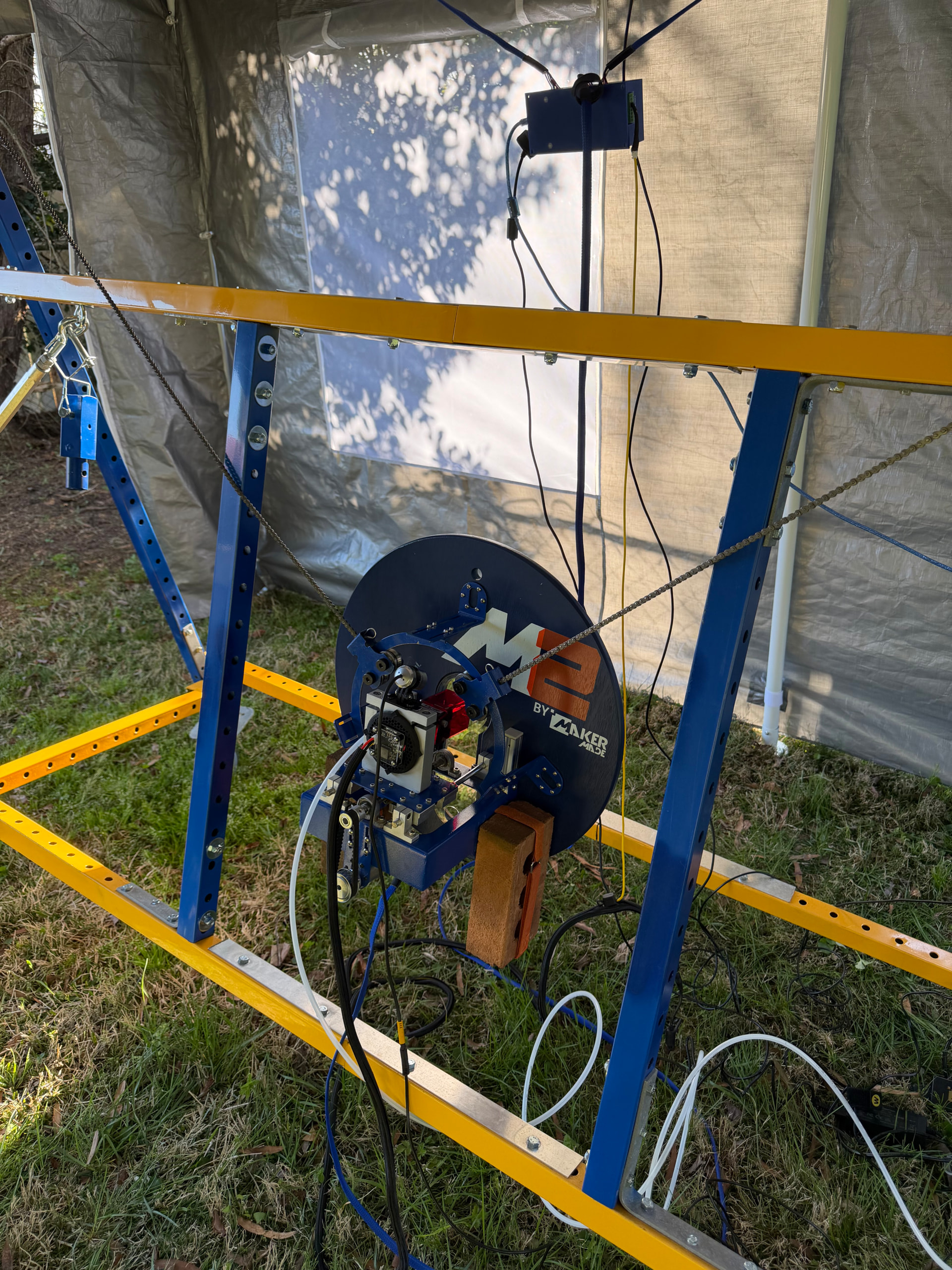

I’ve recently purchased a MakerMade M2, vertically mounted CNC setup. I’ve finally gotten my frame built, the machine mounted on it, and everything wired up.
Instead of beginning with a router, I’ve installed an 80 watt CO2 laser module (model # D-BL10WF).

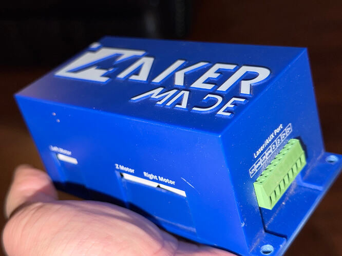

It did seem like I was able to connect to the laser, through the MakerMade Arduino controller, using LightBurn. At least it did acknowledge that it was connected through the laptops’s COM 3 port anyway.
However, I just kept getting the “Waiting for connection…” message in the Console window, with no action from the laser/CNC. I did try “jogging” the machine using the directional buttons in the LightBurn Move window, with no success.

Here are some photos of my setup…

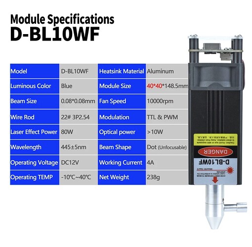

The laser head’s specs indicate it’s really a 10 W optical output power blue-light diode laser with 48 W DC power input, so effects similar to an “80 W CO₂” will be aspirational, at best.

The vertical layout will illuminate everything on the far side of the cut sheet with a laser beam sufficiently powerful to instantly blind anyone glancing at the bright shiny moving thing.
The energy from a visible blue-light laser is focused on the retina and, because we look directly at shiny objects, directly on the fovea where the retina has maximum resolution. Damage to the fovea means you will never read another word; think of it as instantaneous macular degeneration.
Putting the machine inside plastic tent is a Good Idea, but specular reflections from that plastic can carry enough energy to do serious damage to human eyes.

According to the manufacturer’s specs (see the image that I previously uploaded), this particular laser module only requires DC 12 volt input. That’s the way I’ve wired it anyway, and it came on normally with the attached fan running as well. So, for now, I’ll leave it at that and see how it functions moving forward. But you’ve got me thinking about it now!
