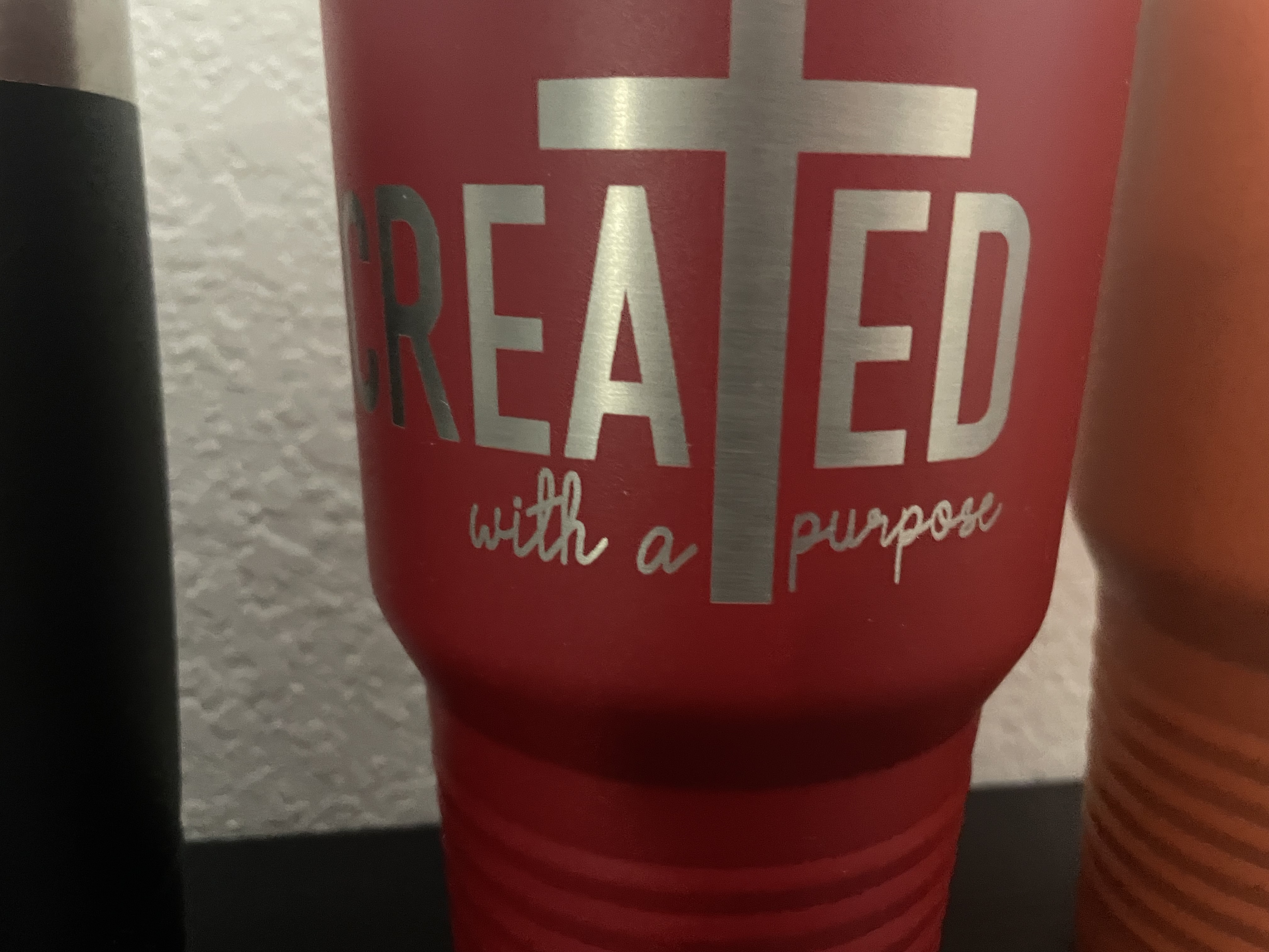

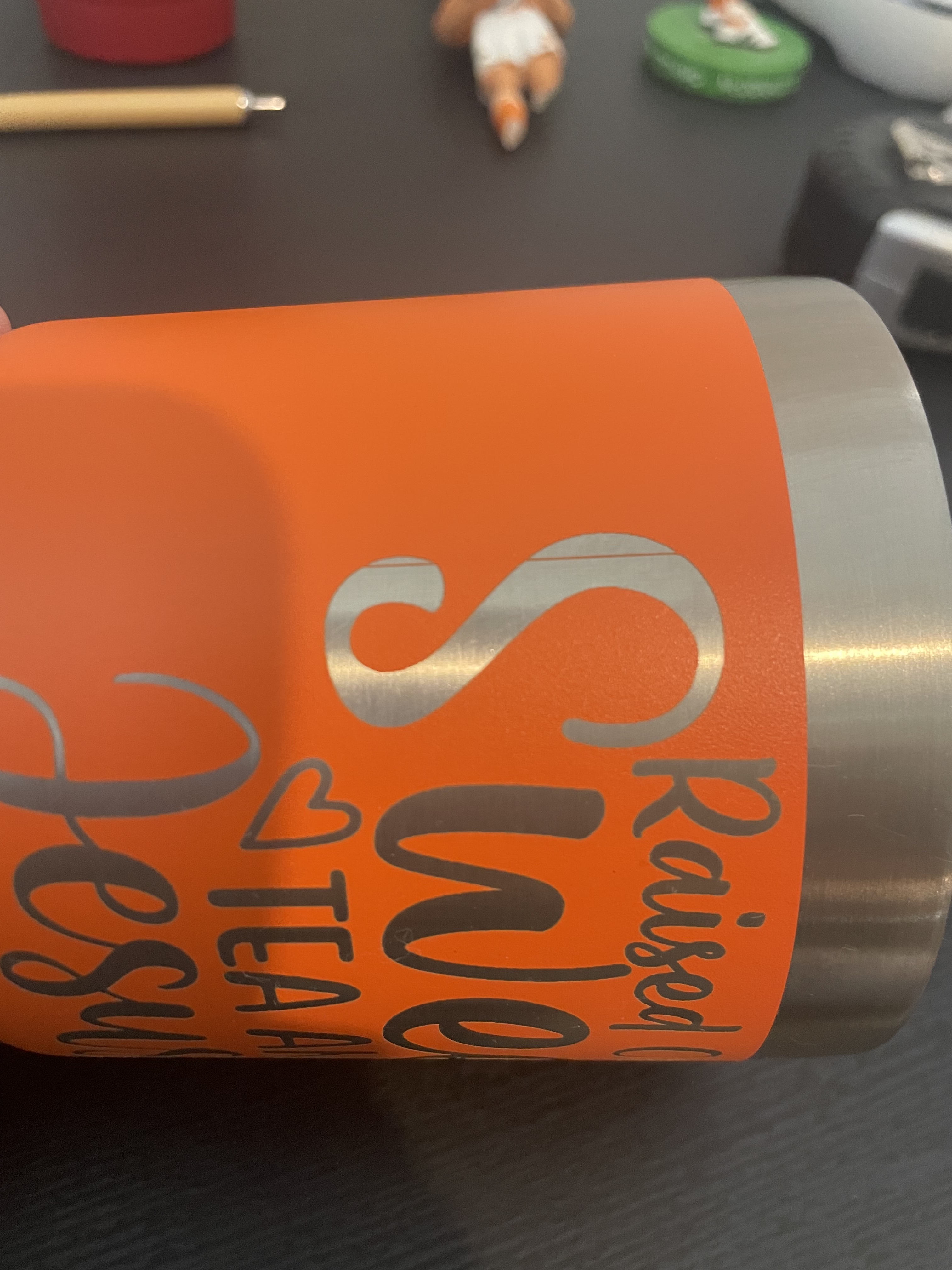

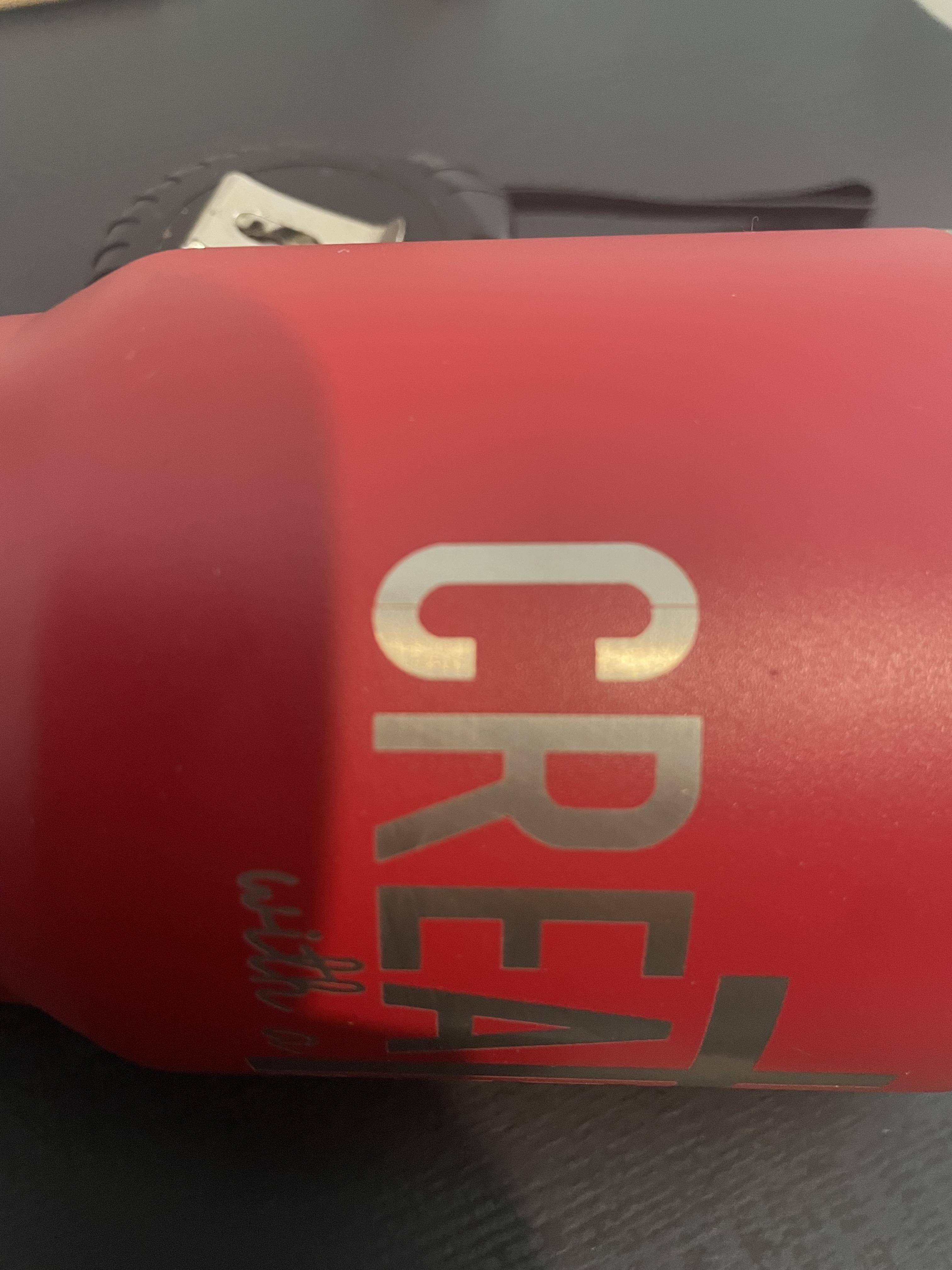

I have finally got the rotary working! I still have more to learn, but parts of the engraving skip a line on the same area of the text. If you look close enough its the C on the red tumbler and the S on the orange tumbler.
Is this from a slip or something else causing it?

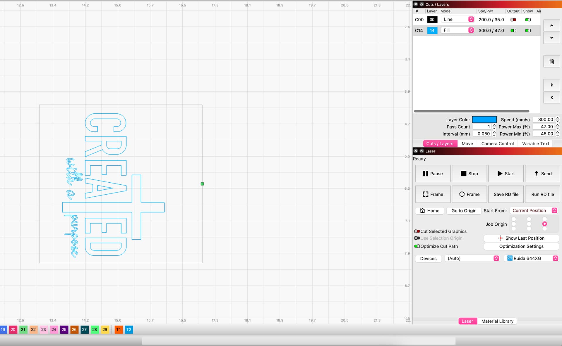

What does your preview look like? Also include your lightburn file.
Are you on roller or chuck type rotary?
What are your settings for rotary setup and for the engrave? Speed? Acceleration?
Does that still happen if you shrink the graphic by 20%?
There is a mismatch in the settings, somewhere.

Speed = 300
Power Max = 47
Power Min = 45
Interval = .05
I thought maybe slowing it down and doing a lower power may also help.
As far as other speeds, I did change two of them in the machine settings based on a video I saw. I changed Idle Speed from 300 to 20, and I changed Line Shift Speed from 100 to 20. I don’t know enough about acceleration or any of the settings to just go in and change them lol.
Also to give a little more insight, my “boundaries” or box size is based on tumbler diameter and engrave space. In this case my tumbler diameter is 3.96" for height of box and width of box is 3.85" to make sure I don’t go down too far on the tumbler.
I set Start From as Current Position and Job Origin is Center Right. Those were also suggestions from a video I saw.

What is your interval set to (lines per inch)? If the error is persistent across different speeds, then I assume you have an issue with the line spacing
For giggles, try the same graphic with the same settings at a 90 degree angle, see if there is still a line in the output.
My Line Interval(mm) was .05
I will try another tumbler soon, and test it with the scan angle at 90 degrees with the same tumbler and design. I will let you know!
Do you need 4 passes over the same area? The normal spot size of a 50.8mm (2") lens is just over 0.20mm on most machines. If your interval is 0.05mm then you will cover the 0.20mm beam or spot size in 4 passes. Is this what you want to do?
Is there only one occurrence of the issue on each job?
Suggest as a start
  1. a change in interval, even a minor one
  2. slow down the jump off speed and acceleration for the Y axes
Sometimes you can get an interval that doesn’t work out right for the stepper motor… it doesn’t step then it steps too far. This has to do with rounding or just going from a floating point number to something fixed and digital.
In the machine settings you can slow down the jump off speed (how fast it starts turning) and the acceleration. It doesn’t look like you have a grip problem from what I can see.

If it doesn’t show up in the preview or artwork, it appears to be a mechanical or interval setting.
Usually if it’s slipping, there is more than a single flaw, but about anything is possible.
So I am still learning all of this stuff with lightburn. I went smaller on the interval part just because I have the smaller lettering. I usually get better results on smaller lettering when I go to a smaller interval. So that is my reasoning on doing the .05mm
