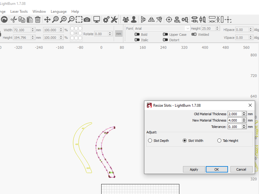

![CaptureFDF](https://forum.lightburnsoftware.com/uploads/default/original/3X/9/4/94eb097f29495b8596eb9ab7e29ab6230f88531a.png)
 ![CaptureOK](https://forum.lightburnsoftware.com/uploads/default/original/3X/8/7/8765012e3f958ad636637cb43f894015874f9737.png)

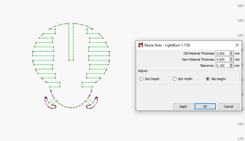

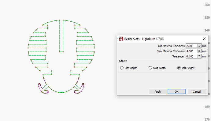

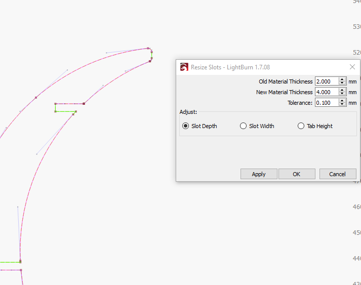

A lot of files experience the same problem
 ![Capture](https://forum.lightburnsoftware.com/uploads/default/original/3X/e/4/e47c95745d0a3231c84444a8b959d0ae6d76f39c.png)
 ![94650_3mm_original_SVG](https://forum.lightburnsoftware.com/uploads/default/original/3X/7/7/77f2e125b2832b7ecbec64dbf86a2d287d688232.svg)

You will need to select ‘ **Slot Width** ’ and make sure your ‘Old Material Thickness’ value matches (or is a close enough measurement with a +/- Tolerance value) the actual length of this segment:
 ![image](https://forum.lightburnsoftware.com/uploads/default/original/3X/3/9/390c71d781437bd0f904483221efd35ae9c832a3.png)
Use the [Measure Tool](https://docs.lightburnsoftware.com/1.7/Reference/Measure/#using-the-measure-tool) to check the size of this.
But first, your file might need a bit of a clean up - as I’m seeing what looks like open lines and and possible overlapping line segments? The tool doesn’t detect slot features if the shapes are not [closed](https://docs.lightburnsoftware.com/1.7/Explainers/OpenClosedShapes/), clean and simple.
