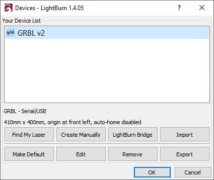

That’s interesting. Confirm that the device is indeed configured as “GRBL” by pushing Devices button, then click the name of your laser. The specific device type will be listed at the bottom of the window.

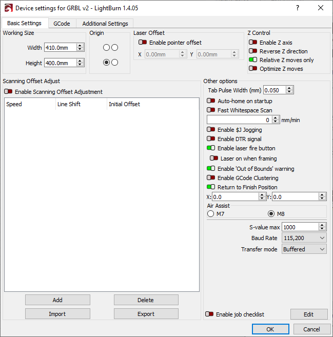

Additionally, can you take a screenshot of Edit->Device Settings?
Device type:
Device settings - I notice the baud rate doesn’t match the info in the driver:
Try toggling “Enable DTR signal” in Edit->Device Settings. From what I recall, your laser shouldn’t require that but worth a shot.
