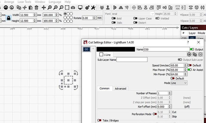

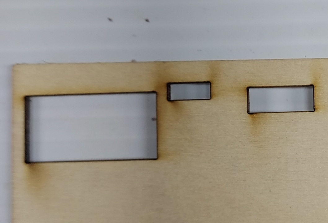

I got my tumbler / rotary stuff dialed in, and I thought let’s burn a piece of bass wood.
Any suggestions on why I’m getting rectangles instead of squares?
This is becoming ridiculous…
You remember to turn off ENABLE ROTARY? My set up shorts the Y axis if I forget to flip that switch…
Jim… That was it. I didn’t see the green indicating circle on the icon, so I “assumed” it was off. And assuming, well , you know…

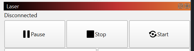

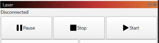

How about this:
vs

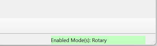

It’s still subtle enough that people might not notice it, which is why we have the “Job Checklist” thing, in addition to the green rotary dot on the modes, and the bright green “hey, you have rotary enabled” thing in the status bar, but maybe this helps.
As with the Print and Cut notification in the same area, that seems to vanish when the new news arrives.
I like the changed Start button, which will appear in any screen shot we ask for.

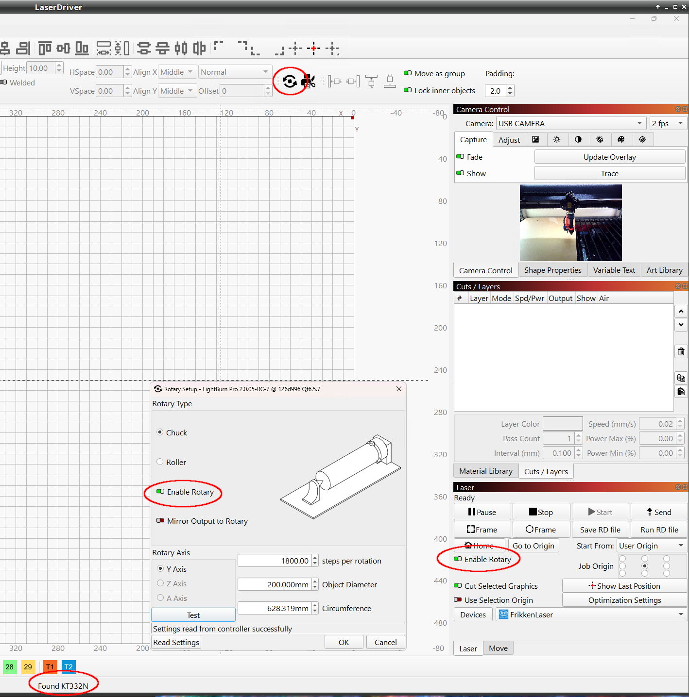

As part of setting up a chuck rotary on a KT332N, I ran into this situation after the obligatory Reset/power cycle:
More pondering is in order, but I have the uneasy feeling something is wrong with LightBurn’s KT332N handling, because the Test button moves the X axis, not the Y axis.
