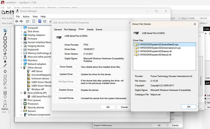

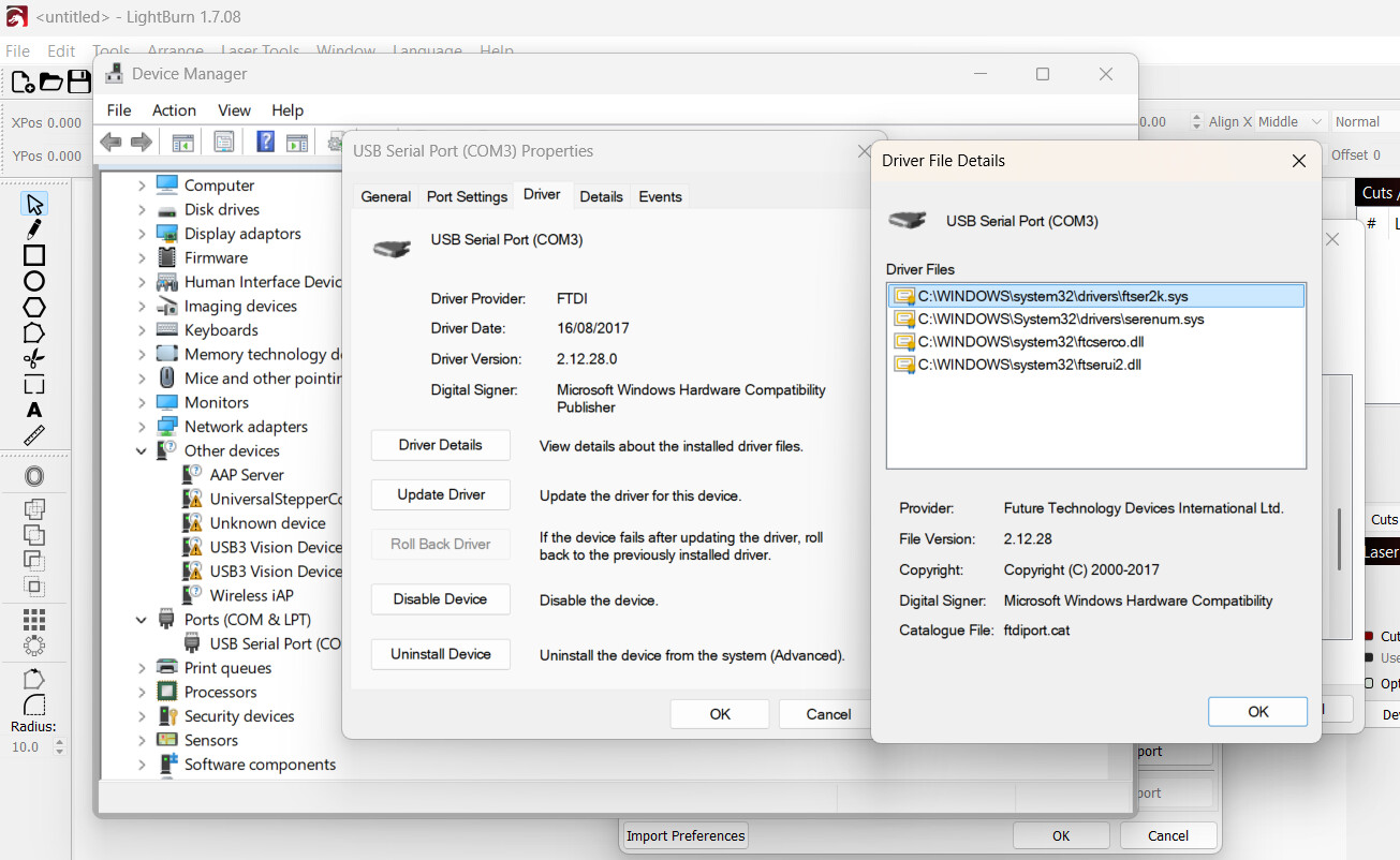

I have tried to see if works with Lightburn trial version, but it doesn’t reconizes the machine.
Thank you Danilo
That is interesting.
I have never seen a galvo on FTDI drivers before.
Can you confirm if you unplug USB the FTDI driver closes off?
This means the controller is not a EZcad or BSL compatible and something, probably custom.
I will inquire internally to see if anyone in the Dev team could shed some light. But the probabilities of out-of-the-box support on LightBurn are slim.
Thanks for your analysis. Yes I confirm that once the USB wire is unplugged the ftdi driver closes off. Same for two other ports for the cameras.
