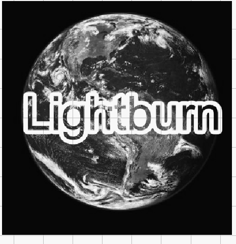

Sorry to step in.
You’ll want to use [Image Masking](https://docs.lightburnsoftware.com/ImageMasking.html) but with a twist, which isn’t explained very well or I and a few other users didn’t understand the explanation.
- The trick is to create a rectangle larger than the image,
- select the rectangle and the text and assign a layer (T1 or T2),
- select the rectangle and the image and center them on both axes then place the text in the places you want.
- press shift and the layer of the text and the rectangle in cut/layers window and group them
- apply mask and flatten image mask
(sorry correct file has 7 Meg)
 ![result](https://forum.lightburnsoftware.com/uploads/default/original/3X/9/f/9fbeeffb544793e32897228a990bcae5e764e521.png)

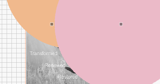

You can also assign an offset to the text to achieve the following effect:
 ![Mask_offset](https://forum.lightburnsoftware.com/uploads/default/original/3X/c/0/c0ee6216c8ae25b07de1d0eab9c655e7266f02db.png)
