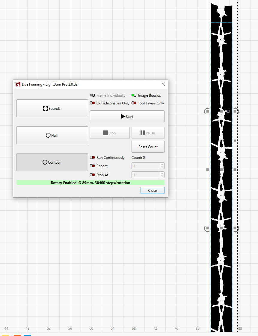

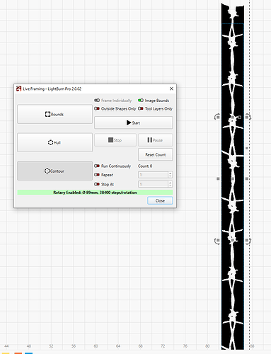

You can position and scale while “Live Framing” with rotary just like on the flat, using page up, down for scale, and arrow keys to move. Shift and CTRL to make the jumps smaller.
This works in “Live Framing” modifying position, scale:

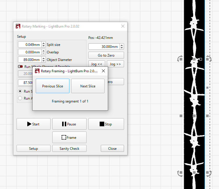

Once you are in rotary window> rotary framing it won’t work, probably because the software is displaying slices.
This doesn’t work modifying position and or scale in Rotary Marking>Rotary Framing:
