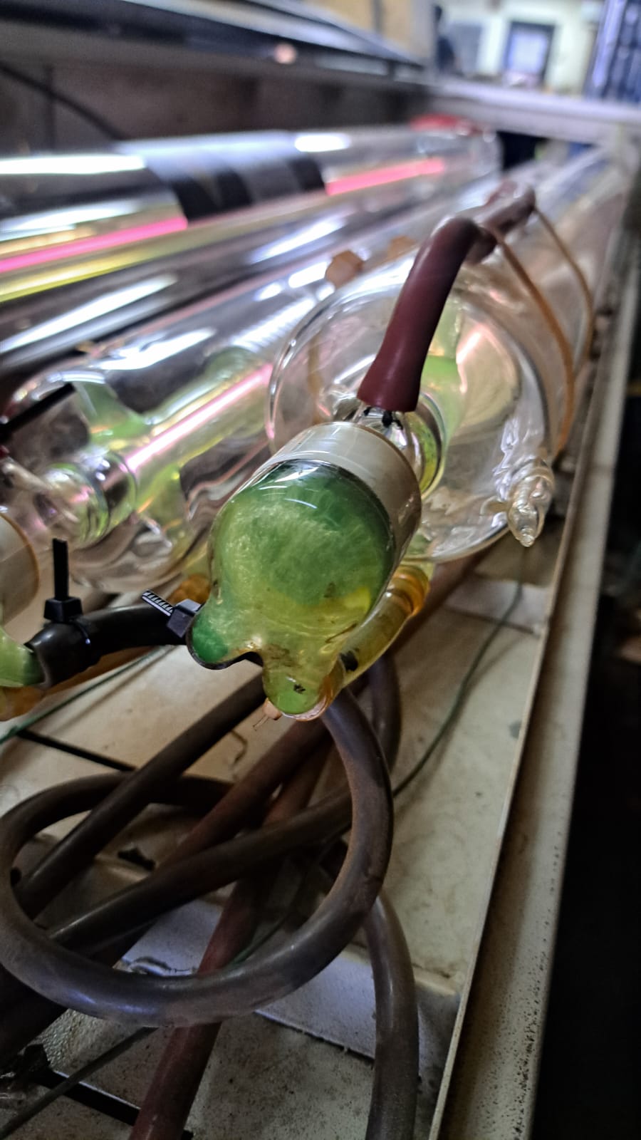

Hello friends, I come with another question, in one of the machines I observed a turbulent flow and bubbles, in a previous post I read that bubbles and a turbulent flow affect the useful life of the tubes, my question is what damage a tube can suffer by not solving this. In my case I only added coolant until the amount of bubbles was minimal.
Bubbles isn’t a tube killer, when they stick and prevent the coolant to touch the inner tube, they really become a problem.

I have bad experiences with air bubbles in cooling systems, if the bubbles hang the wrong place they can overheat and it can lead to a kind of micro pitting that attacks the surface.
I allow no air bubbles in my system, it takes no time on my little machine getting rid of the bubbles, so that’s what I do, always.
to avoid bubbles (cavitation) try to put your tank higher than the laser tube, but not too high so that your pump has enough power to raise the liquid, at the outlet of the laser tube, put a connection T, with a piece of vertical tube of at least 30cm, at the end put a stop valve, this works a bit like on a car or an aquarium, will allow you to purge the air, if possible when filling, try to tilt the laser to chase the bubbles towards the outlet.
Turbulent flow is often a good thing. Laminar flow has an almost stationary layer of liquid next to the glass. Turbulent flow on the other hand has better contact with the surface. Rotating the tube and /or tilting the laser should get rid of the bubbles (add a couple drops of dish soap to decrease surface tension and assist in getting rid of the bubbles. If there are no holes or leaks on the intake side of the coolant pump, then once the bubbles are gone, you should be good to go.
