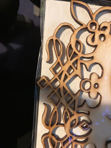

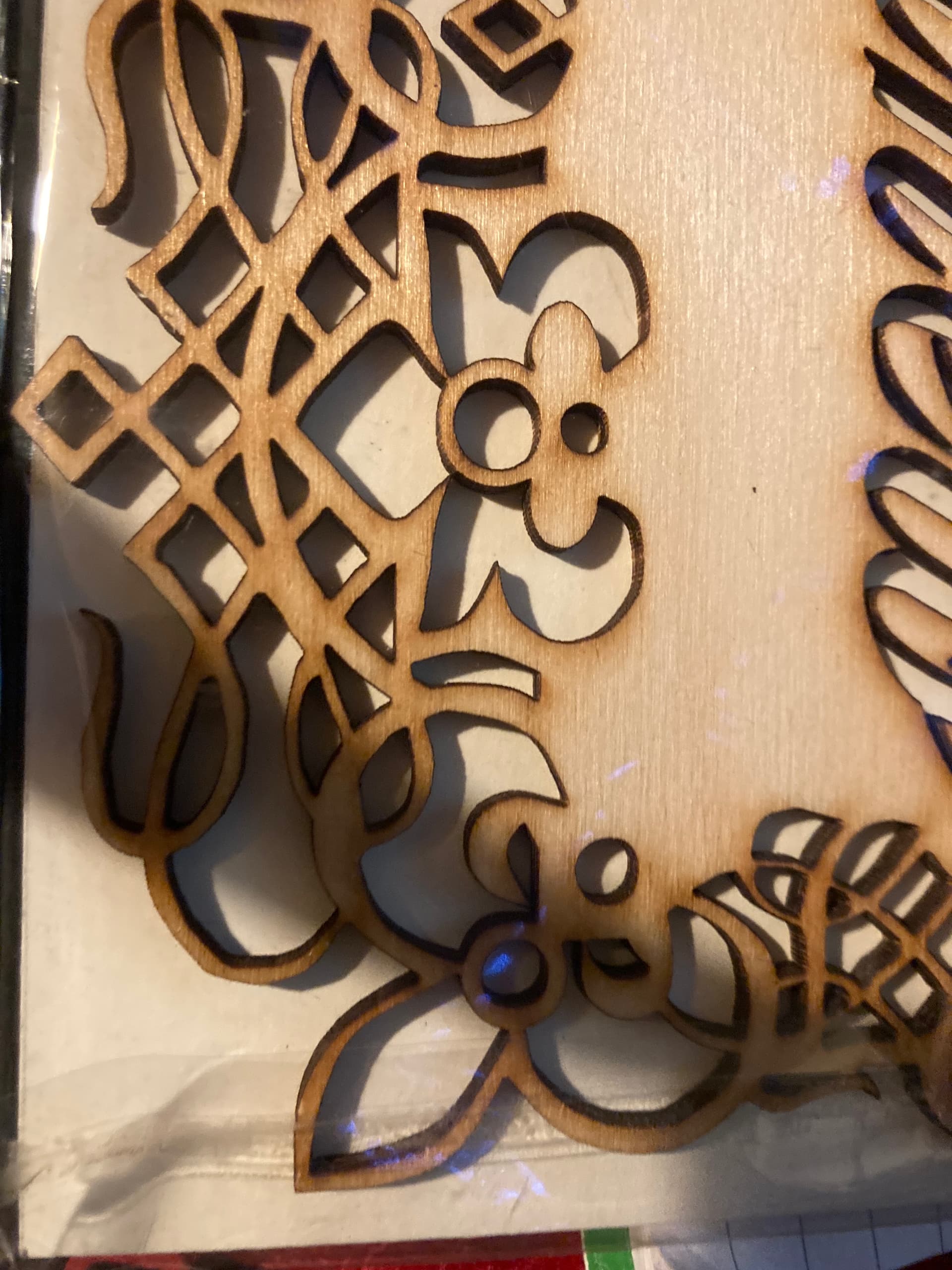

I’ve been trying to find out how to do these frame work edges within Lightburn and adjust I’m hitting a wall and I was wondering if somebody could give me some advice on how you do this sort of cutting have included a few images to let you know the sort of thing I’m trying to achieve any help would be really appreciated thank
Please ignore the daybreak picture. It’s the border in the pictures two and three

My problem is that I don’t know how to design that sort of framework into Lightburn so that it will cut that out or is it some sort of template file you download and then can importing to do the scrollwork

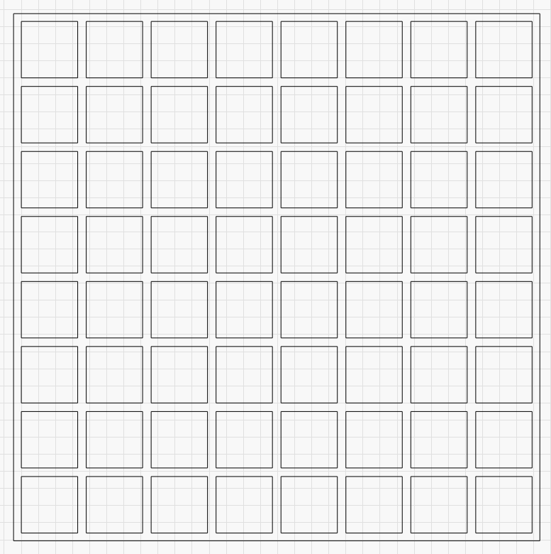

A simple first project you could do is to make a lattice shape of squares. This is essentially the same principle as the frame that you showed, just with a different complexity.
  1. Draw one small square
  2. Use the array tool to create duplicates across X and Y
  3. Draw a circle around all of them encapsulating them
See what happens when you change the cut mode of that layer from line to fill. Turn on Window->Filled/Smooth to make it more obvious. Try moving some of the boxes around. What happens?
