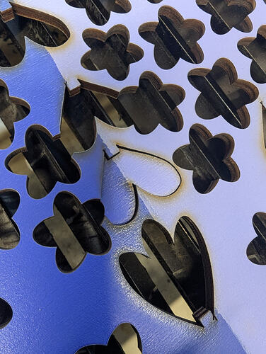

Up to now I’ve paid someone local to cut all the pieces I need but am now ready to get my own machine. My issue is that when I’ve done test cuts on a second hand machine using my material I’ve not been able to replicate the clean-ness of the cut. There is a shiny brown residue on the top surface around the cut lines. It can be mostly wiped off but as I’m cutting 100s of tiny pieces at a time I couldn’t mask / clean each one. Bottom surface is perfect.

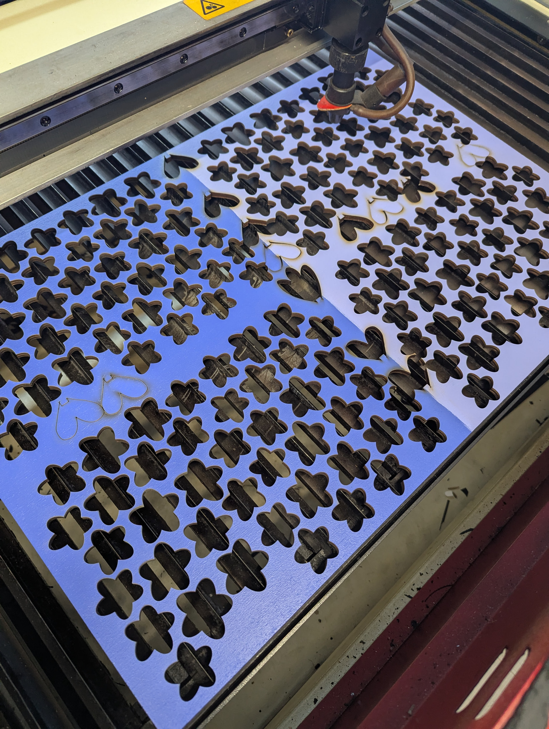

I want to make sure whatever I buy can get a clean, residue free cut on both surfaces. The image shows the shapes with brown residue that are the test cuts made on the LS6090 compared to the clean rows of shapes that were cut previously elsewhere. I tried lots of power / speed settings but no improvement.

Looks like not enough assist air to force the fumes down through the kerf.
A rule of thumb: whatever compressor came with the machine is the bare minimum required to put an “has assist air” item in the description. They’re typically repurposed aquarium air pumps with low pressure and limited airflow, with the bonus of more noise than you’d think possible for so little output. :grin:

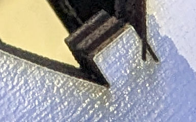

Unless the design has a substantial Overcut enabled, that puppy has severe mechanical backlash:
And whether you want to use the laser or tinker with an unfamiliar (and possibly orphaned) used laser.
…or an “accident” in design?

Ha not backlash thank goodness… this is a deliberate lead in and out on the design. With the laser that I’ve outsourced to previously, adding this lead in and out avoided a more noticeable burn dot!

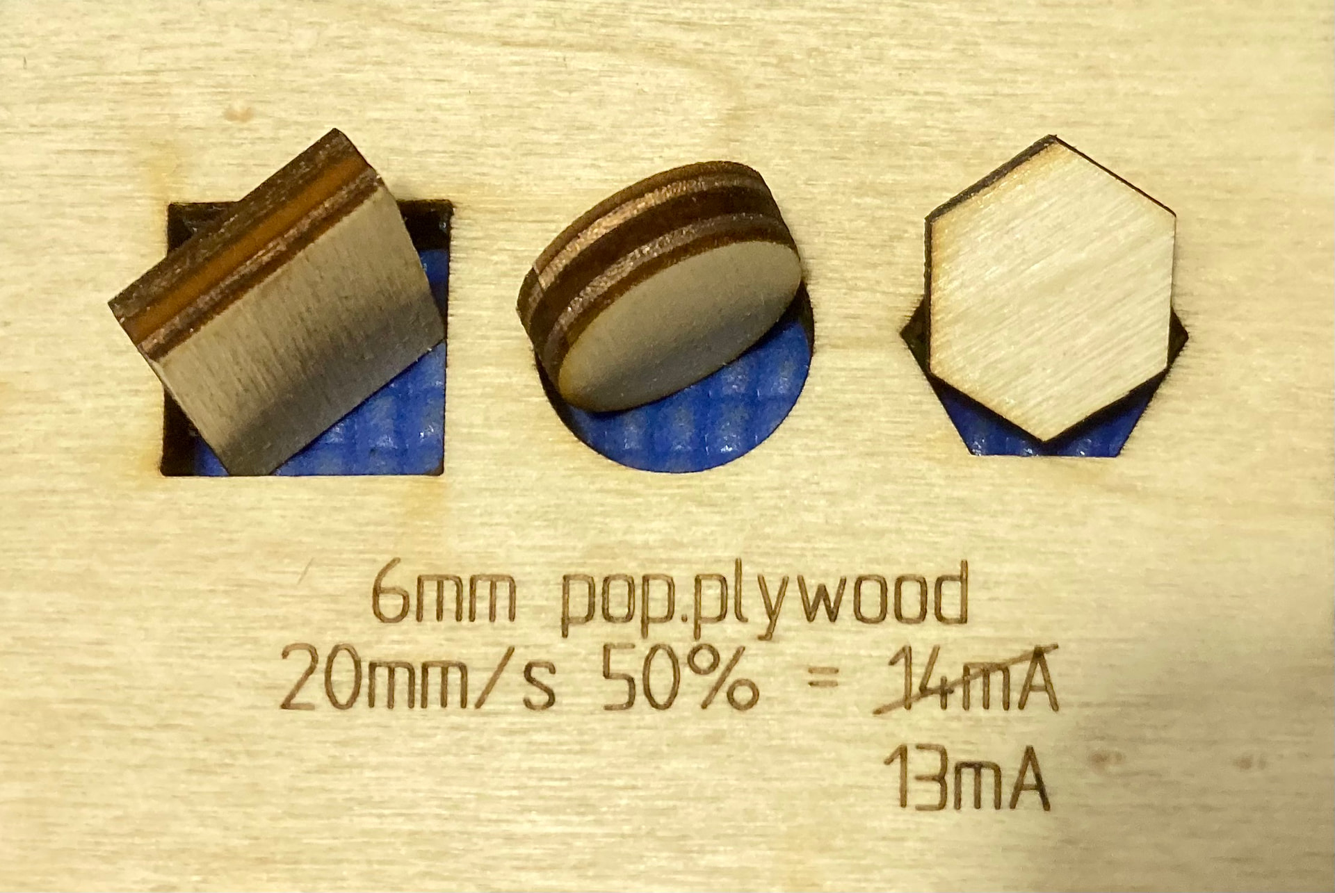

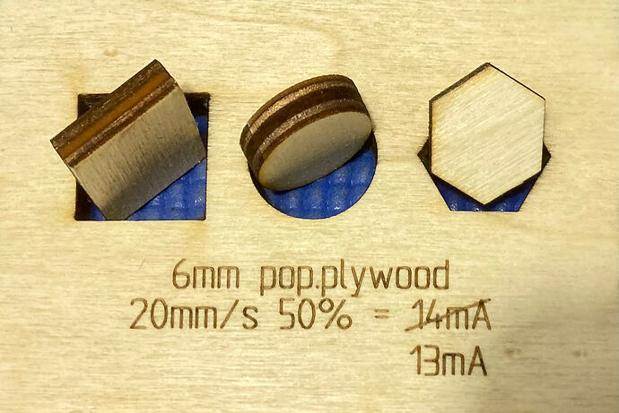

I cut 6mm poplar plywood with 20 mm/s and 50% power which corresponds to 13mA. It could be done faster but for me this is reasonably optimal. The color is a bit misleading, the cut edge is actually nice and bright.
Whether discoloration / fire marks is a problem for you, you must judge.
PS. there is of course also a quality difference with poplar plywood but it is usually nice and easy to cut.

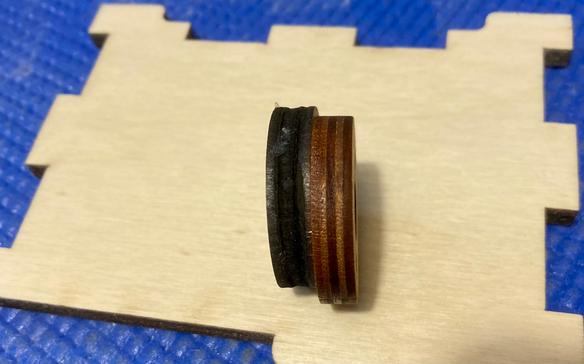

difference between exterior and interior glued birch plywood
