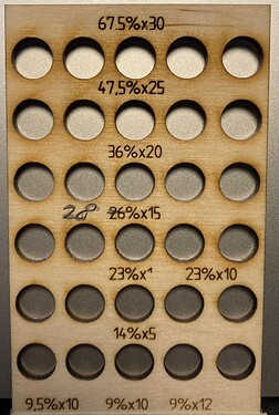

What is more crucial, in my opinion "is the combination of power and time.

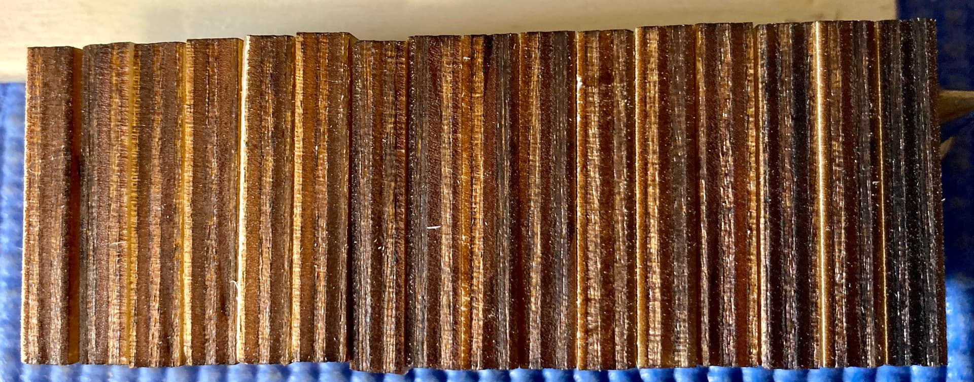

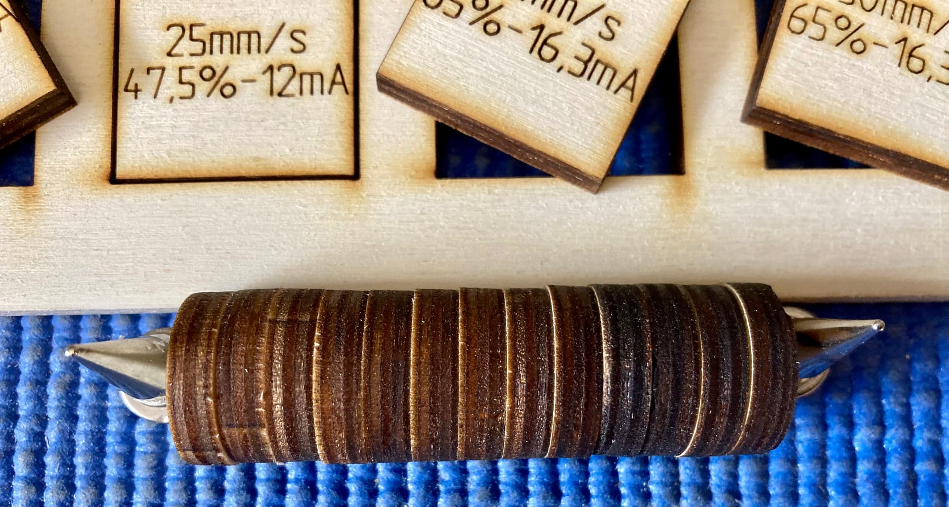

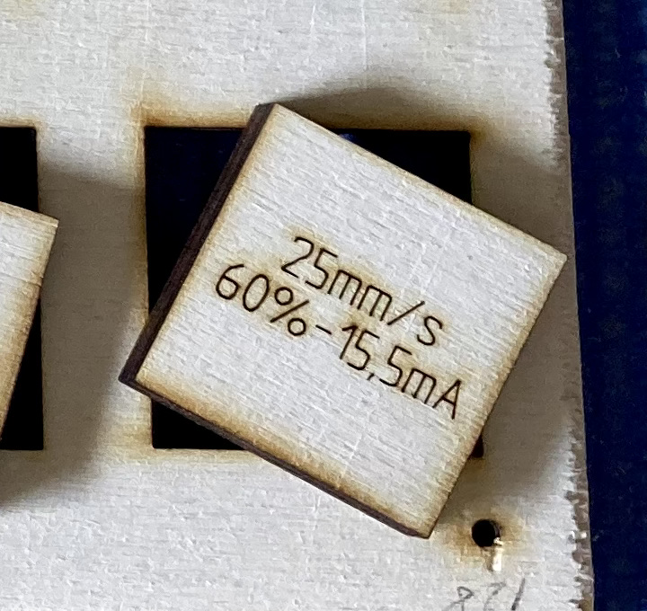

The picture shows a small test with 6 different combinations that I can use to cut 3mm plywood with.
(the bottom line of text is only a line / font power / time test)
The back is without fire / soot marks, I used my magnetic punk spikes and “normal” air.

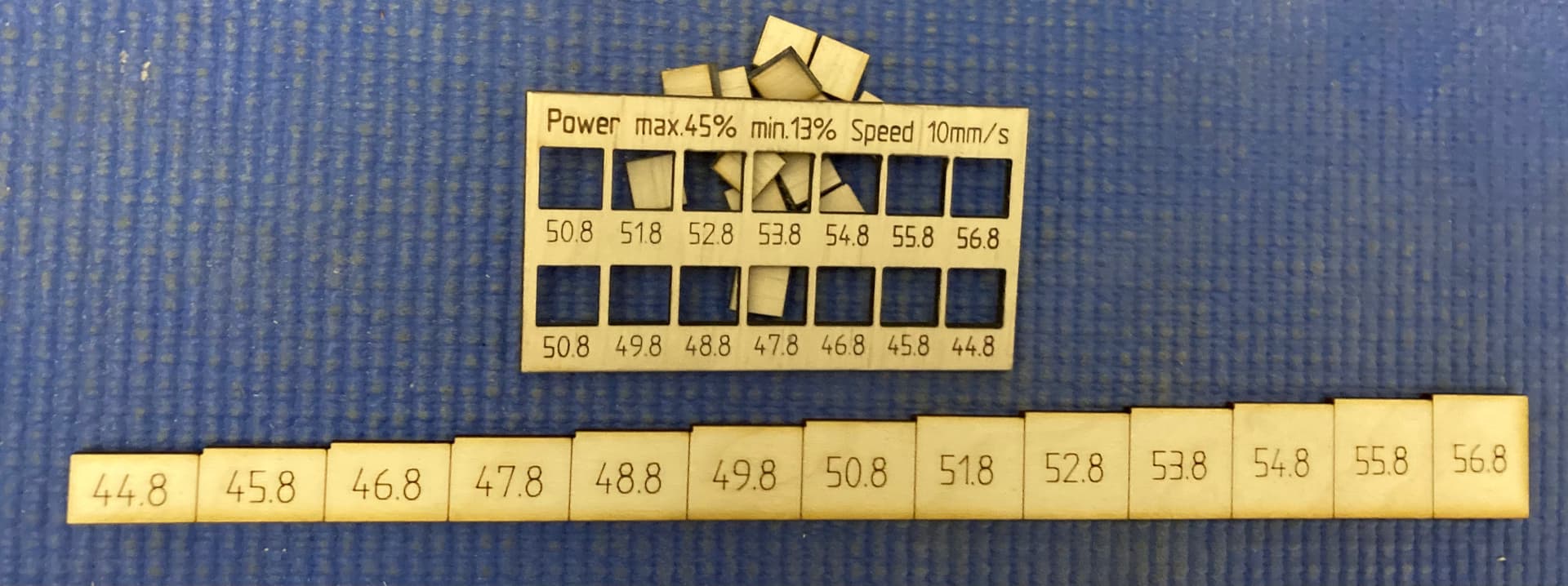

I have done (again) a little test :wink: to check what I wrote in my last post.
The focal point is on the surface of the 3mm plywood. It will probably be possible to continue in both directions, one or two mm more, but the usable 12 mm focus depth in this small experiment is impressive enough (for me).
But everything has its price, a beauty award I will not be able to win with the cuts and measure of the pieces also change along the way.
Within +/- 3mm there are no problems.

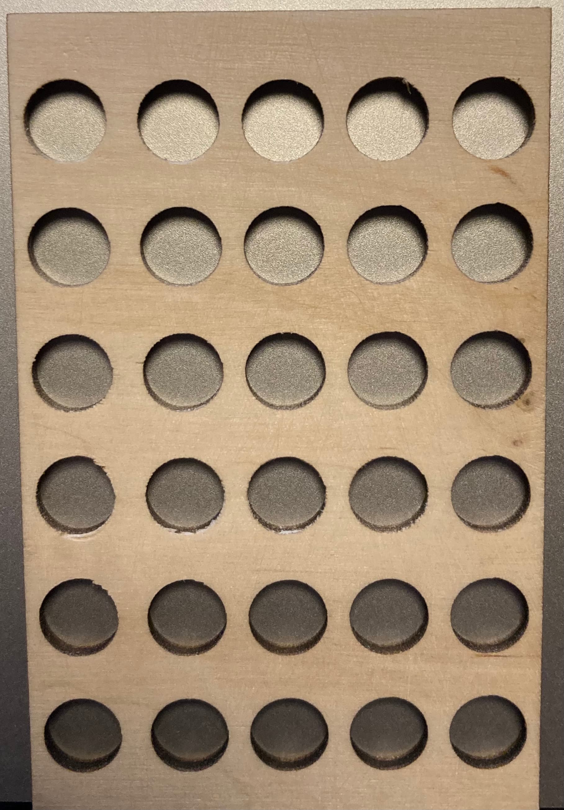

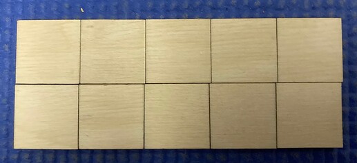

Test of 5mm mixed plywood (poplar + BB)
The day started with a video from Russ Sadler where he tries his hand at puzzles. Although I admire and respect Russ a lot, his suggestion how to cut plywood puzzles is not exactly my cup of tee. It is possible that if many puzzles were to be produced, his basic idea of ​​a suction and workpiece capture device could be developed. But there must be better and easier ways to do it.
However, today I did not manage to make puzzles, I have had a small production of “serious” items to supply.
I managed to do a material test in P / BB 5mm plywood.
The material is 5 layers, 3 birch and 2 poplar layers and weighs only 4.6g / cm2 (BB weighs 8.5g / cam2)
As with birch plywood, many variations of power / time are also possible with poplar plywood.
I chose a “standard” settings for me, for just this material I have in stock, which is higher than expected and also higher as needed. The reason for this is that even though pretty much all items fall out by themselves, there are some that hang in very thin birch wood fibers on the back. To make puzzles, it is not acceptable, there should be no finishing other than color processing if desired.
All subjects emit no soot on a white cloth although some look quite dark in the pictures, they are actually nicely light-brown.
I also tested different focus distances, 50.8, 53.8 and 47.8mm, measured to from the wood surface to the lens bottom edge. - It can be done, but the nicest result is achieved by the correct focus for a 2 "lens, (from the material surface to the lens).
The test is not entirely adequate but directional for me and the material I have today.

I have done the little test that I talked about, and the interesting thing is that at very low speeds and equivalent power, there is the least soot on the subjects. I have not optimized the font, it actually soots more than the cut itself. The back is completely clean, with all settings. I’ve used my punk spikes magnets on the perforated plate. If I had to make a lot of puzzles I would probably make a fakirbed with very thin pins at the same height and with very little distance to each other.
(3mm normal plywood)
