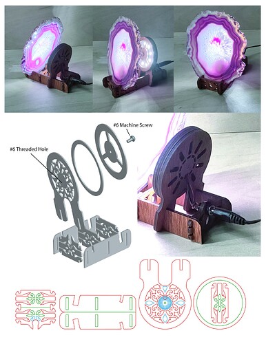

Agate LED back lighted display stand, snap together, LED 2.25” round, .120 birch

what LED light are you using. I really like this. you have a lot of great ideas

Well I will make a long story short, I sold LED’s for RV’s in the winter at Quartzsite Arizona for years (until covid put us out of business) and designed and had this 2.25” 9 led bulb made for me (had to buy 2000 min) its 12v.
So I designed this stand around this bulb.
The stand could be designed around any LED, if I was starting from scratch, I would find a 5v bulb that would run on 5v wall wart. Square is more available.
I have bulbs (9 LED round), converters, dimmer switches for this stand and could send you some.
