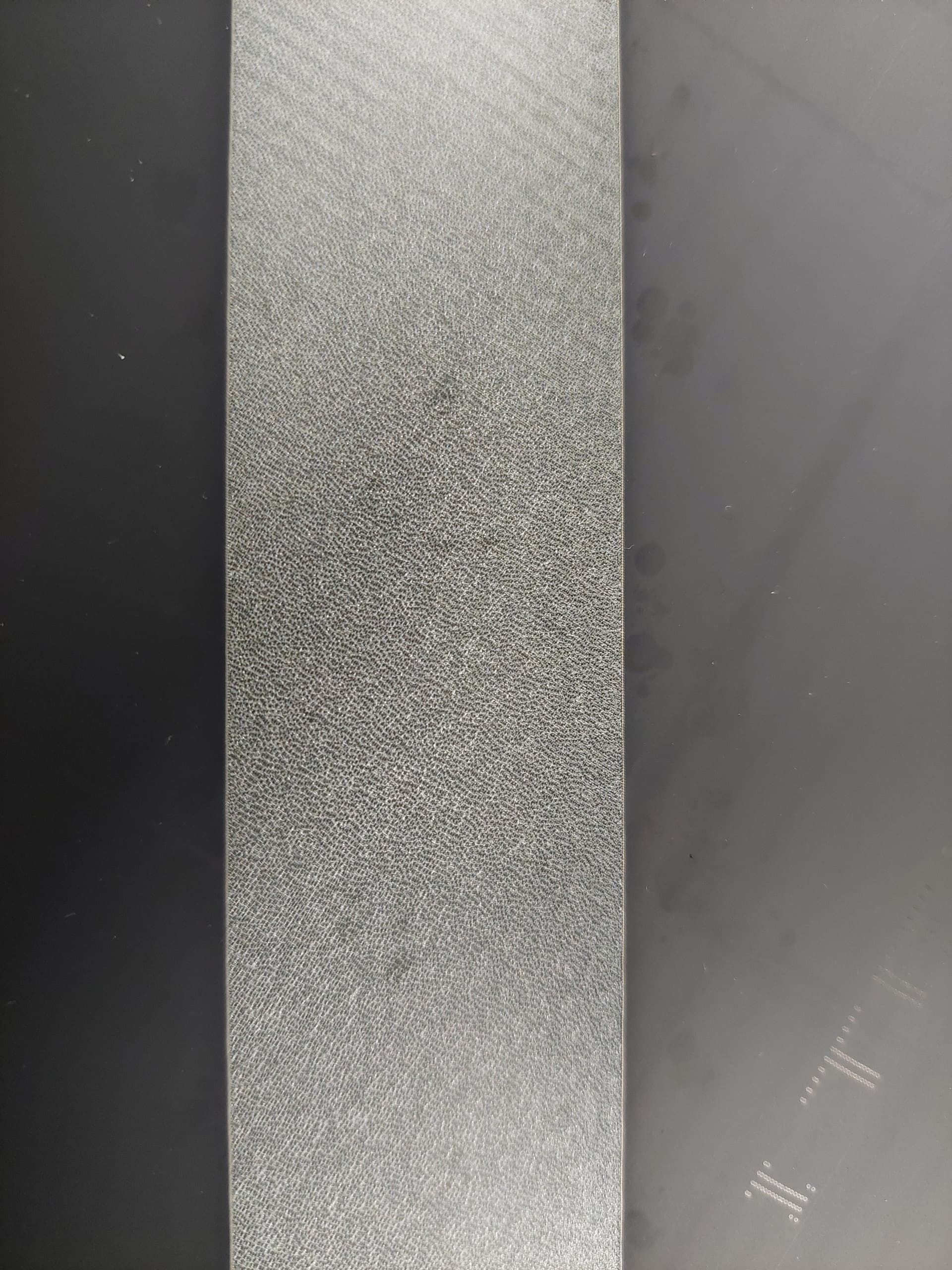

Is it possible my air assist is damaging the engraving on the mirrors/ glass I am working on?
I have noticed lately that the mirrors especially tend to get these spots of slightly different colored …texture, I suppose, on it, as if a drop of some liquid fell on it…or as if a brittle piece of the engraved glass has blown off.

Turns out i am to dumb to remeber I can do this FROM my phone. I am not sure how clear the ‘splotches’ will be though.

Are we looking at the front of the mirror in this picture? I assume the left side is the side that’s been engraved. And the darker diagonal streaks are the artifacts you’re talking about? Or are you talking about the darker spots on the engraved side?
How do you have your air assist setup? Is it aimed straight down through the lens or at an angle to the work surface?
that is the back of the mirror in this case. because of other work being done on it right now I cant flip it. th two black sides are the backing material and the big stripe is the “engraved” area. the darker spots in the engraved area are what I am talking about yes.

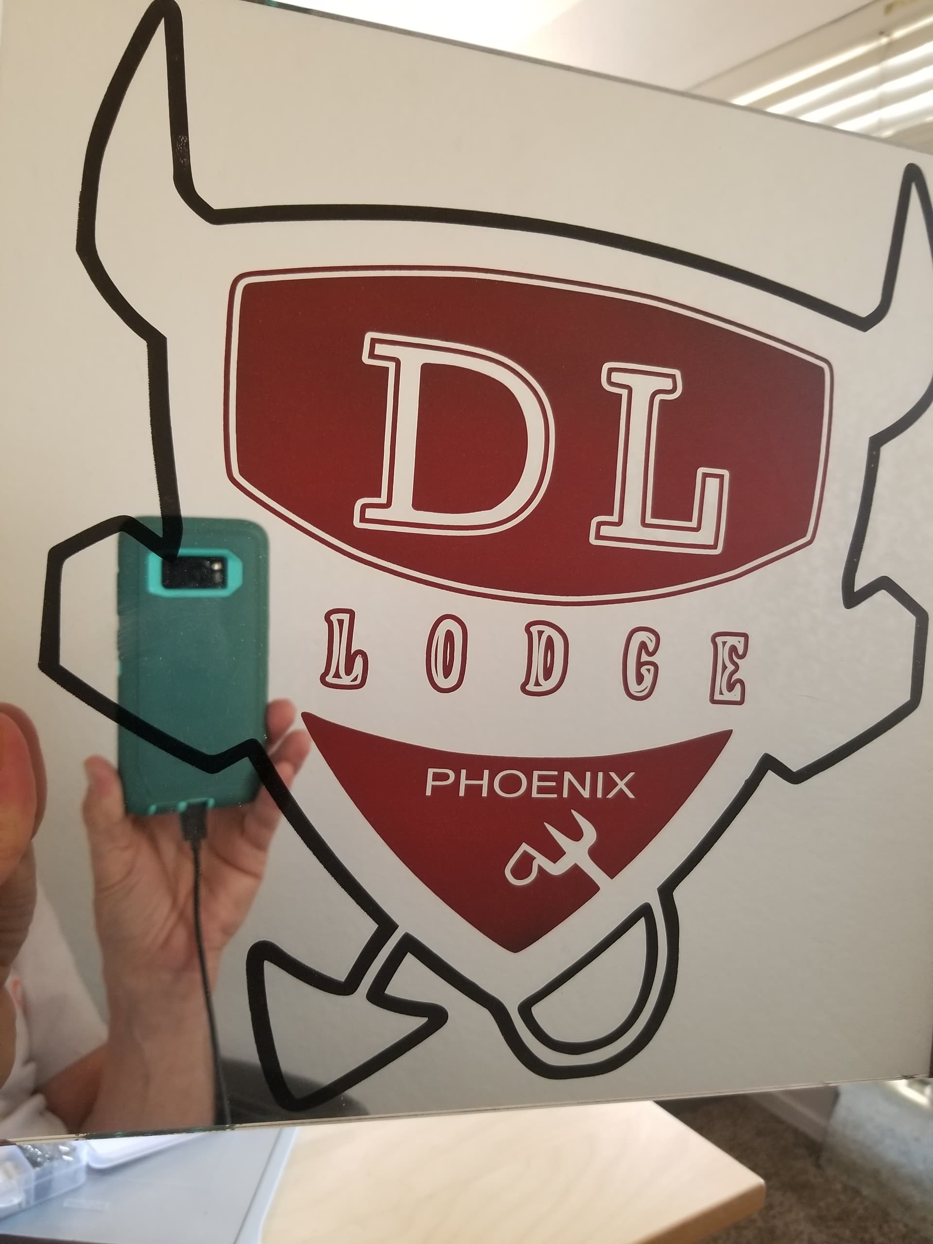

I’ve done this for a friend or something similar.
This is a closeup of a change in dpi. It’s offset a little, as it was taken out of the jig and returned.
I do this with a 2" lens and mid pressure (10 to 12 lbs). If I don’t do that, I have a buildup on the nozzle. I have tried this with the compound lens and mid pressure. The lens is too close/too low pressure as it coats the lens inside the nozzle. That’s why I use the 2" it being almost 19mm away and the compound about 11.
