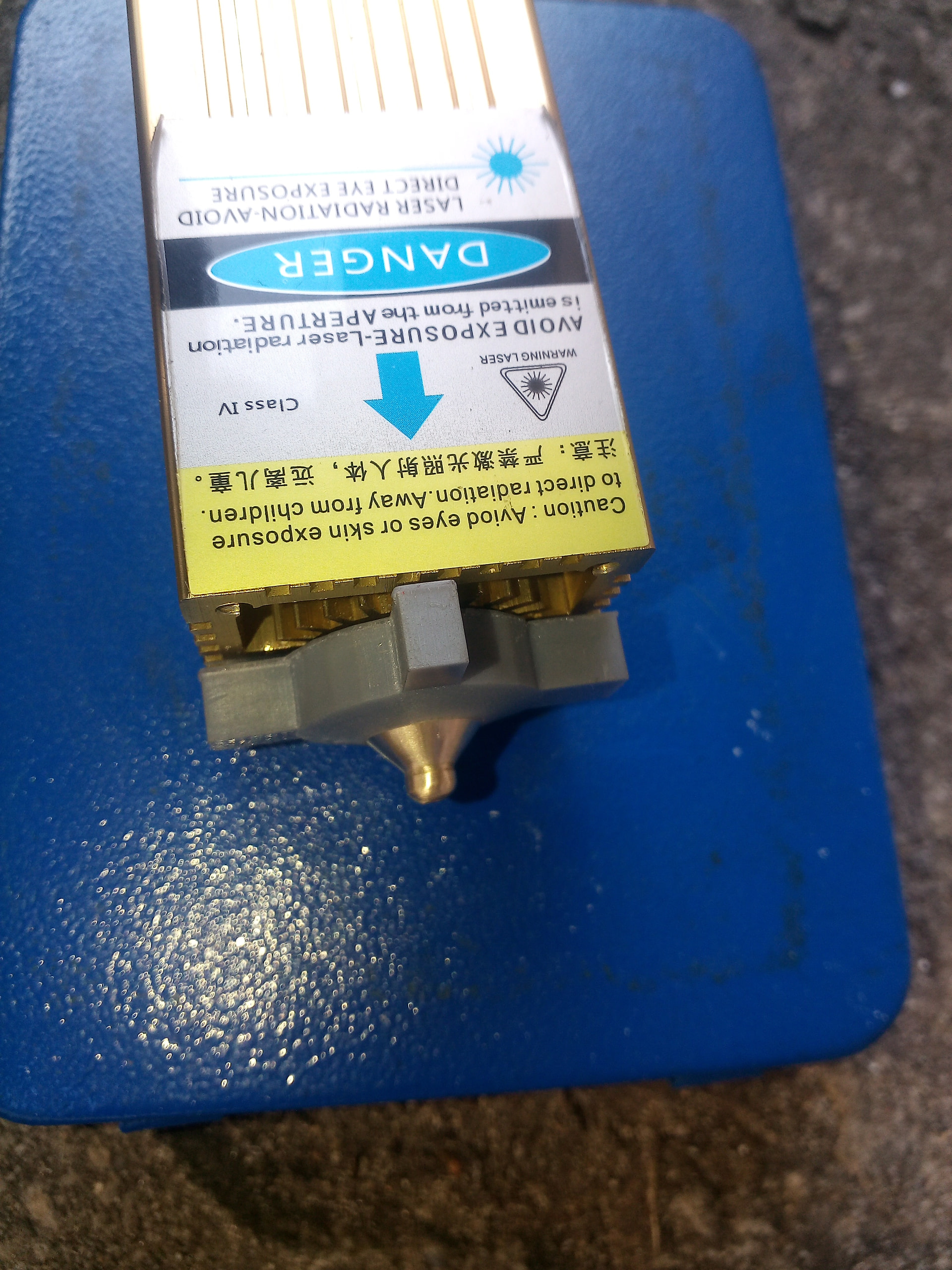

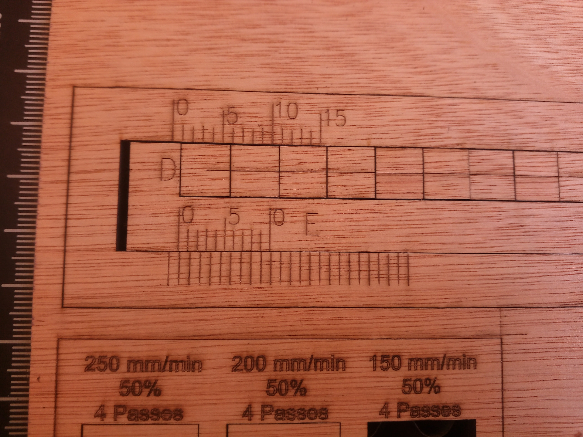

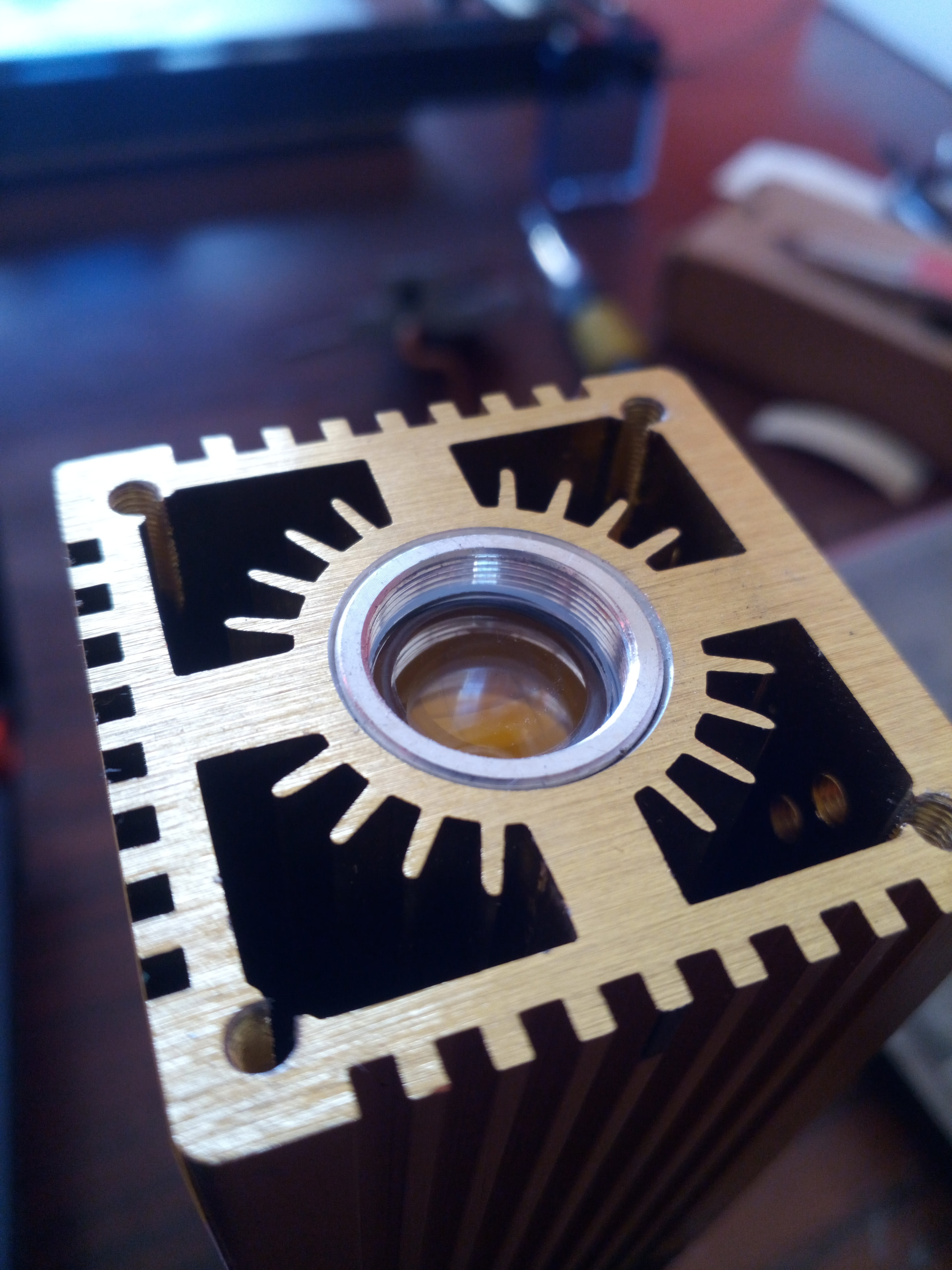

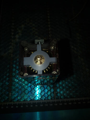

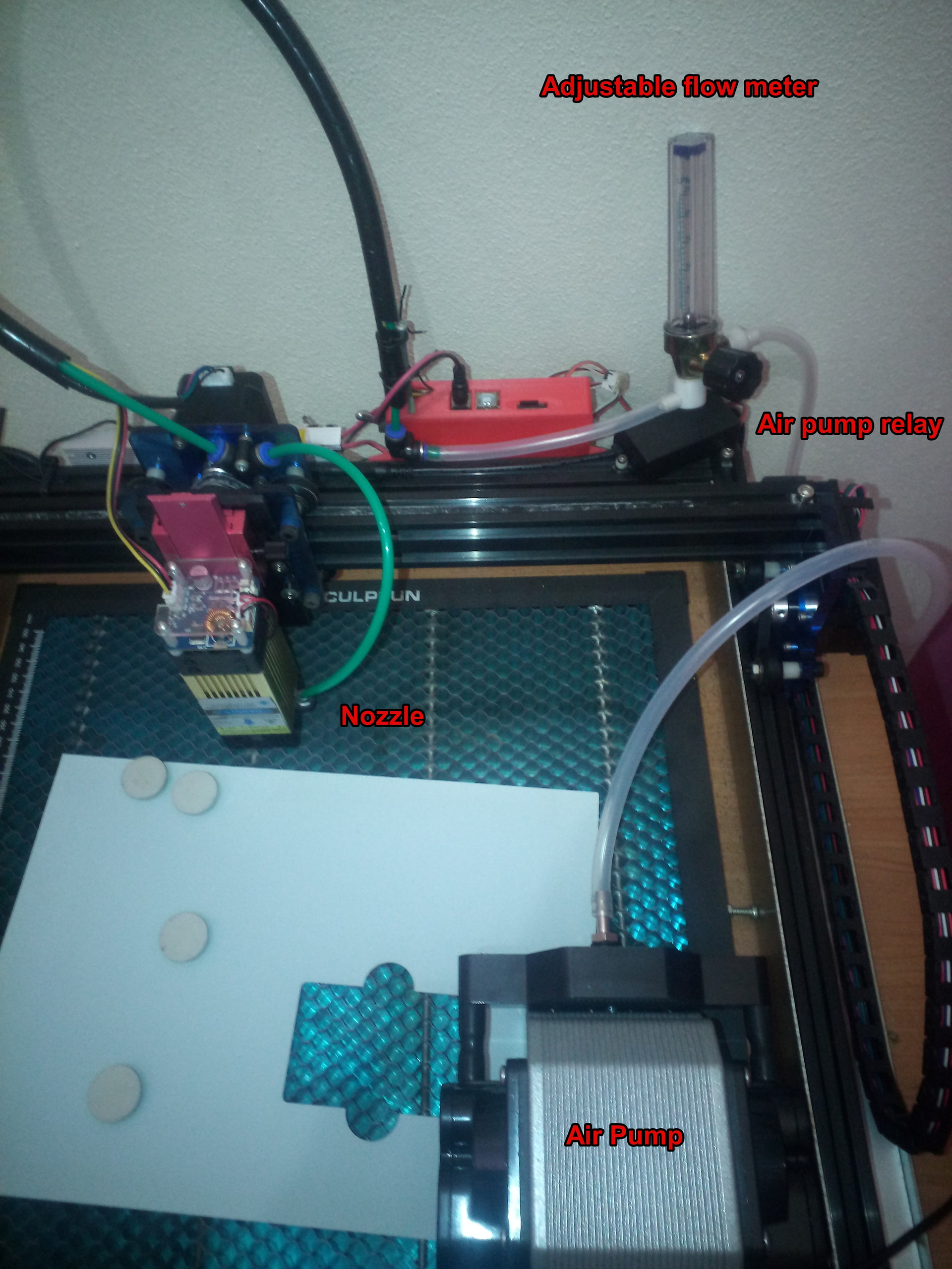

Here’s my two cents based on experience with solved air assist problems.
In my case, being a constantly evolving Chinese diode laser machine, the structure and distances are completely different (or can be), but using a conventional air assist compressor makes it essential to bring the nozzle outlet as close as possible to the material.
The nozzle outlet should not be too thin, which excessively restricts airflow, nor too thick, which prevents the air from creating the necessary pressure to create a jet.
The air assist compressor simply does not create enough pressure or flow to project a concentrated jet of air beyond a very few millimeters.
In my case, to protect the lens’s protective glass (which I can no longer find an equivalent for), I fabricated a nozzle (only because I have the ability and knowledge to do so), a 3D printed accessory (with the help of my brother, as I don’t have a 3D printer) to create a homogeneous air distribution, a switch (relay) that, through the board’s control, turns the compressor on and off, and an adjustable flow meter that allows me to manually adjust the minimum flow to keep the fumes out of the lens or a higher flow for cutting.
It’s a very basic system, but efficient enough for my needs.
For more professional use, this serves only as a tip/example.
With some simple automation and appropriate accessories, it’s possible to do very efficient things.
Furthermore, I’m sure that for cutting thick materials at speed, the use of an industrial compressor capable of delivering sufficient flow and pressure to generate an efficient air jet will be inevitable.
 ![IMG_20240203_113054](https://forum.lightburnsoftware.com/uploads/default/original/3X/0/7/0723241c5b754d5ca17acc4a9b9fab894088fe0d.jpeg)
 ![IMG_20240203_115857](https://forum.lightburnsoftware.com/uploads/default/original/3X/a/a/aa5f8ec53a5669bf570e2d1c241b6a5156120e8e.jpeg)
 ![IMG_20240930_213240 - Edited](https://forum.lightburnsoftware.com/uploads/default/original/3X/6/3/635accc3262d70597d5413fd65cfb58deaf3676d.jpeg)
 ![Imagem01](https://forum.lightburnsoftware.com/uploads/default/original/3X/5/a/5a6489250ce86c7eaa5fb0c427dd1af91a2663fd.jpeg)
 ![IMG_20220304_093232_5](https://forum.lightburnsoftware.com/uploads/default/original/3X/4/0/405c87d8a8c1866bf47abfbfaff0867075442c00.jpeg)

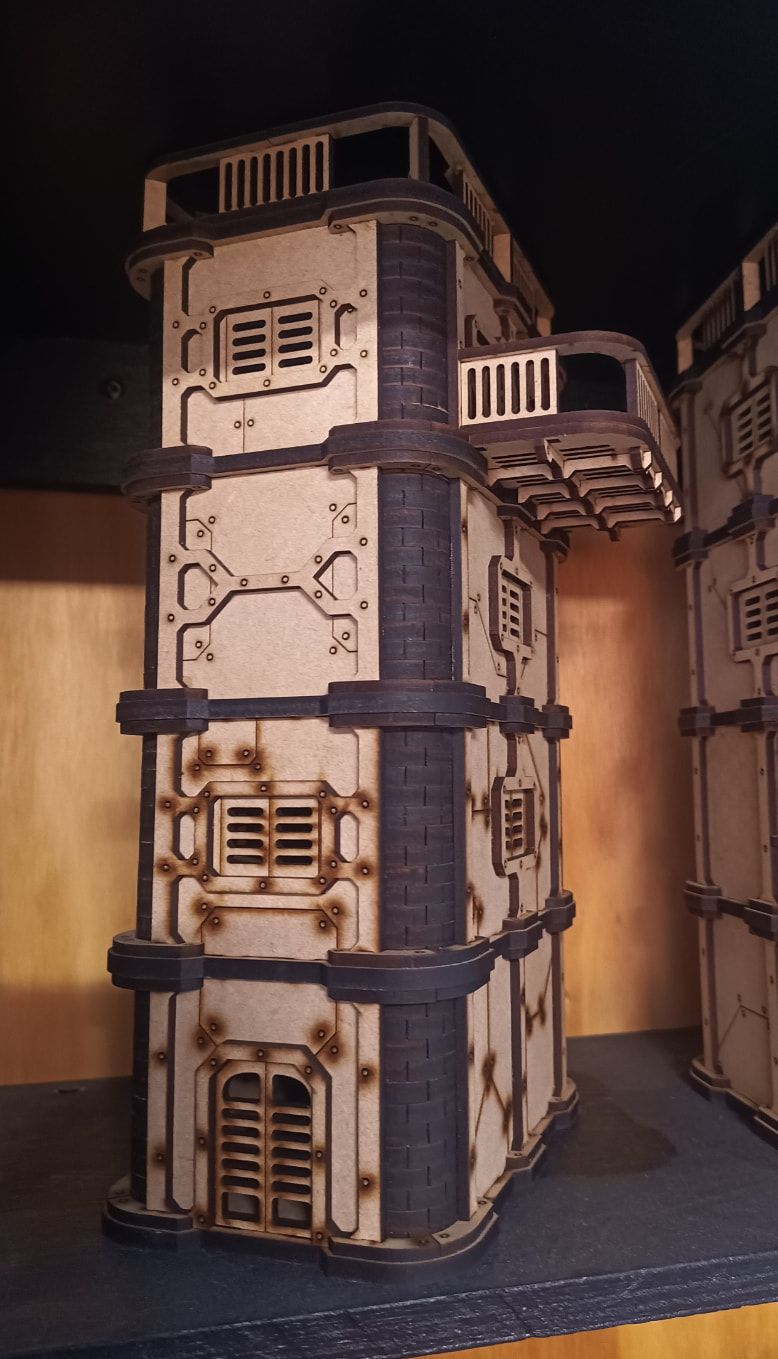

I’m going to throw this example in the mix. I was recently designing a model cutting MDF. Halfway through I switched from the air assist pump that came with it (neje e80 max) to using my shops compressor. This was to improve cutting depth/speed (which it did) by running 3-5 bar. But I noted as an added bonus, the burn marks were drastically reduced. You can easily see in my example where the change happened.
Processing: Screenshot\_20260224-090633.png…
<div class="post-metadata">
**Author:** ![Relleumdesign](https://forum.lightburnsoftware.com/letter_avatar_proxy/v4/letter/r/47e85d/32.png) [@Relleumdesign](https://forum.lightburnsoftware.com/u/Relleumdesign)\
**Post date:** [February 23, 2026, 8:46pm UTC](https://forum.lightburnsoftware.com/t/air-pressure-for-air-assist/187715/12 "2026-02-23T20:46:11Z")
</div>
Uhm…all I see currently is “processing…” the file.
Would be very interesting!
**Author:** ![dla06c](https://forum.lightburnsoftware.com/letter_avatar_proxy/v4/letter/d/97f17d/32.png) [@dla06c](https://forum.lightburnsoftware.com/u/dla06c)\
**Post date:** [February 23, 2026, 9:03pm UTC](https://forum.lightburnsoftware.com/t/air-pressure-for-air-assist/187715/13 "2026-02-23T21:03:16Z")
</div>
just refused to upload from my phone.
 ![Screenshot_20260224-090633](https://forum.lightburnsoftware.com/uploads/default/original/3X/3/4/34406e7b006a516514691939b9edca410fd233bb.jpeg)
**Post date:** [February 23, 2026, 9:33pm UTC](https://forum.lightburnsoftware.com/t/air-pressure-for-air-assist/187715/14 "2026-02-23T21:33:44Z")
</div>
Wow! That’s motivating to invest the work…thanks.

The process can be easily compared and observed when cutting acrylic.
It is the high density of the fibers/material in MDF/HDF that requires a relatively high energy when laser cutting.
MDF has a density of approx. 700kg/m3 (HDF up to 800kg/m3) where pine wood is typically approx. 450kg/m3.
If you want to avoid smoke marks when laser cutting MDF/HDF (and acrylic), you must avoid condensation of the vapors on the material itself. Either very strong and concentrated extraction and/or a lot of compressed air on the material itself around the kerf gives the best results, here in my case.
