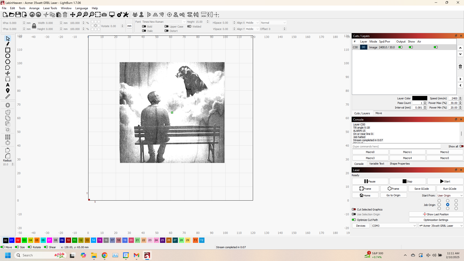

I am getting Alarm 15 and the device stops. My Acmer P1 3.5W says it can print up to 130MM x 130mm, but I’ve reduced my image to much smaller than that. I have checked cables and reset to device by holding the power button for 15 seconds. Here is the Console message:
Waiting for connection…
0.000>
ok
[OPT:VMZHI,199,511]
Target buffer size found
ok
Project loaded in 25 milliseconds
Starting stream
Layer C00
Tilt angle X:18
ALARM:15
On or near line 0:
Job halted
Stream completed in 0:07
QC V1.9.
Grbl 1.2h [‘$’ for help]
[MSG:‘$H’|‘$X’ to unlock]
[MSG:Caution: UnlockeI
I have attached a screen print.
Alarm 15 is not a standard alarm defined in the grbl firmware. Get in touch with the manufacturer to provide information about the alarm definition. It’s an Acmer specific alarm.
This might be a clue…
