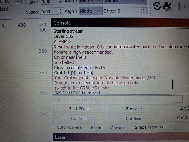

After a year of using Lightburn and cutting many 100’s of jobs I’m starting to get the error :
“ALERT 3 - Reset while in motion. Grbl connot…” etc
The documentation says this means the laser is losing connection with my computer. However, nothing has changed in a year with any of the hardware after 100’s of jobs.
This now happens with almost every job I do, stopping the job and mostly wasting the material.
Some things I’ve noticed:
  • This has only started happening when I upgraded LB to version 1.7.04
  • It happens when the vertical axis gets quite high. Although there’s no friction at that point when I manually move the head back and forth so that might be a coincidence?
  • The USB cable has worked for 100’s of jobs and in very good condition.
  • TS2-20W
  • Windows 10
This issue is so bad and so prevalent it’s essentially made using my laser impossible to use. I have the feeling it’s not actually the connection (USB) that’s the issue.
Does anyone else have this issue and nailed it down to something other than a USB connection?

Consensus around here is try another cable. Rather than saying “it can’t be the cable”, test it. Just because something worked for years doesn’t mean it hasn’t failed now.
It could also be the power supply for the laser failing. Try running a job that fails consistently with power at 0. If it doesn’t produce the error, try again at 50% of normal power, then at normal power. If it only completes at low or no power I would say you need a power supply.

Since your console has no bad characters, I doubt you have a usb issue. If you look at the output after alert 3, it’s the firmware title. It doesn’t appear you have homing enabled on your machine?
Most likely you are resetting the controller some way, this causes an alert 3 and generally re-boots the controller.
This is usually occurring from a power loss or a brownout condition where the supply voltage drops too much to be tolerated. It can also occur with a failing usb connection.
It also advises that it occurred around line 0, that makes it a bit more easy to figure out as it’s usually referencing the first line of code. Also that it probably completed no code before the error.
However I’m not sure if I totally buy into either scenario mainly because you’ve done 100’s of jobs and all of a sudden you get errors. This sounds like a hardware problem → controller or power supply.
I’d suggest removing the plug from the head module and running the job a few times to ensure it’s working. If it works you likely have a supply issue.
If it still fails, might be smart to enable show all in the machine console window. We can then see what instruction it’s choking on.
