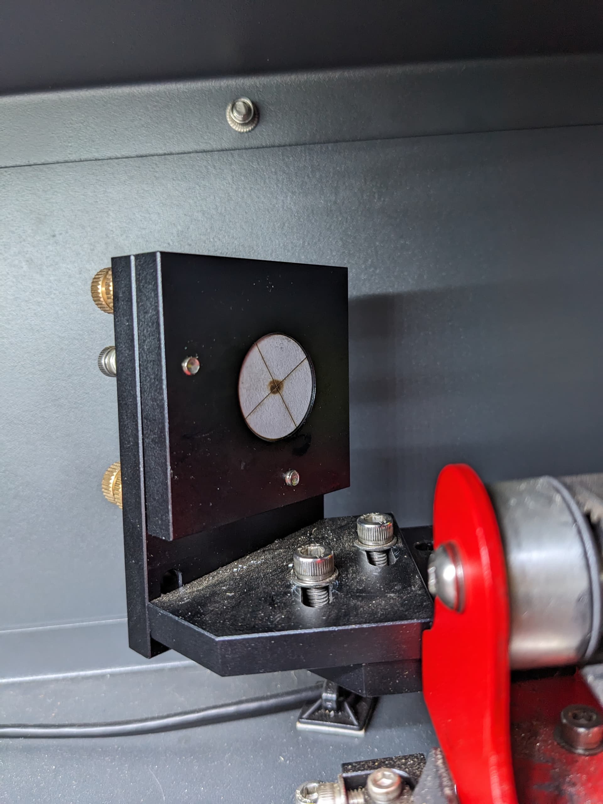

See below, this is mirror two top left

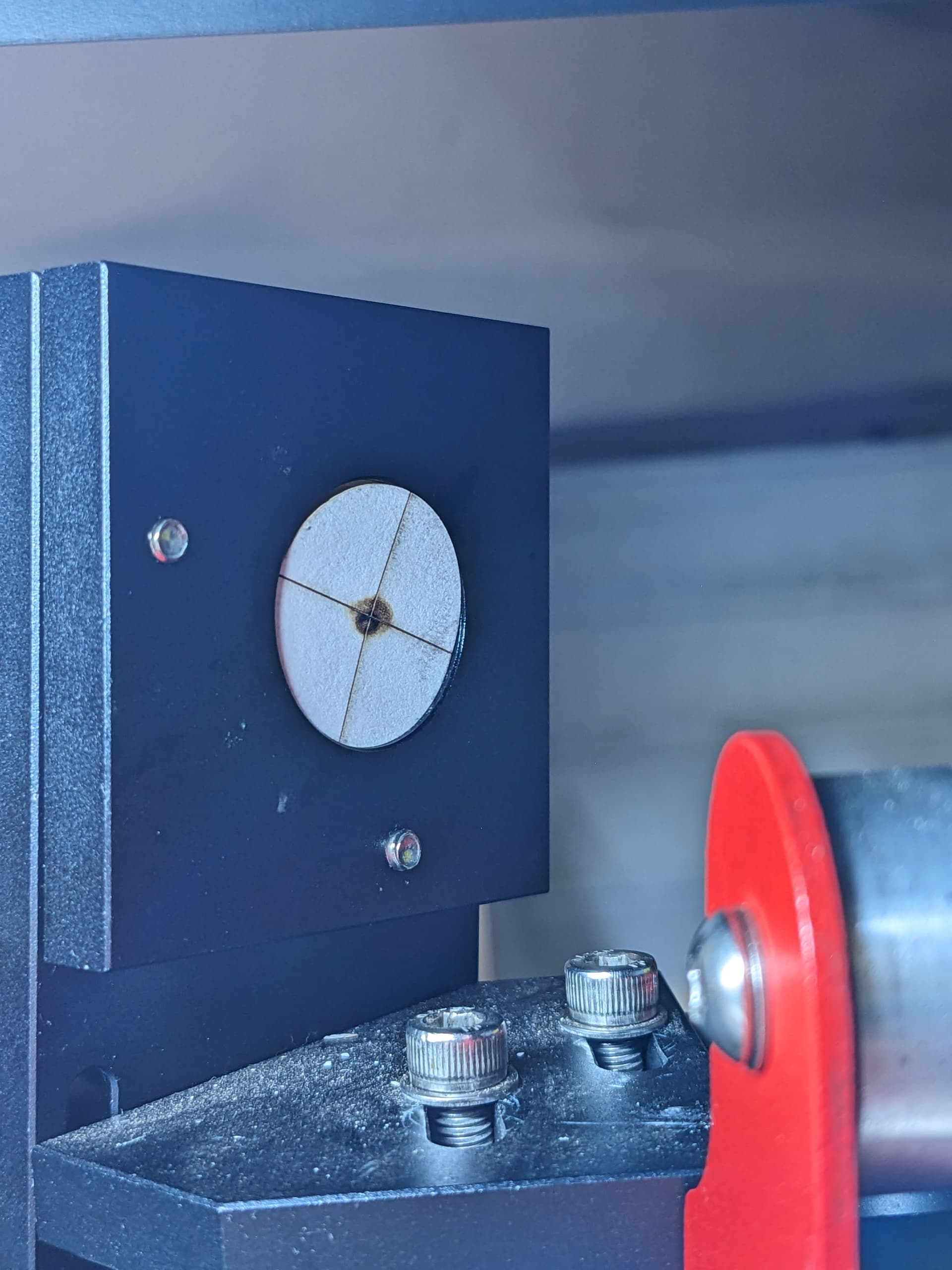

This is mirror two bottom left
Then on the laser head from m2 to m3 it’s off by 2mm when comparing results from top right to bottom right.
How is M2->M3 from top-left to top-right? And the same for bottom-left to bottom-right?
Ok so here we go. Spent all day doing this… so basically m1 to m2 is pretty bang on it looks like it may be very marginally out by 1mm or less.

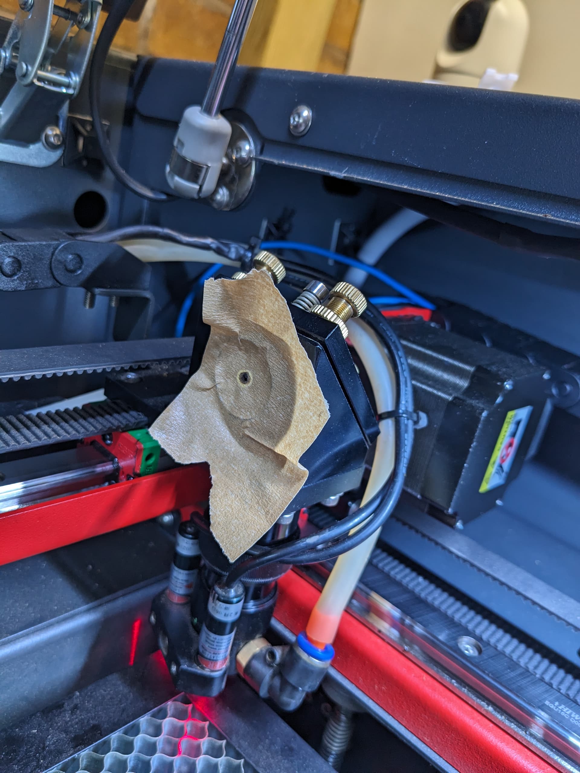

This is it :
First pulse top left
Second pulse bottom left

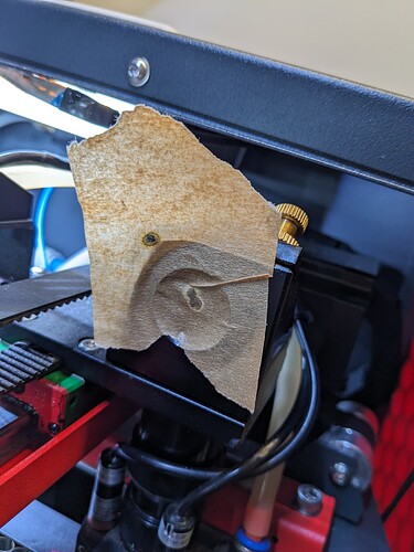

Then we have m2 to m3 which is top left (pulse) to top right (pulse), see how it’s perfectly on top of each other.
Next I did the bottom left (pulse) and bottom right (pulse) and you see how it’s slightly out.
Would this simply be due to m1 to m2 mirror being very slightly out?

This image didn’t come in.
This is possible.
If you optimize for bottom-left and bottom-right without changing M1, does top-left and top-right go out of alignment?
