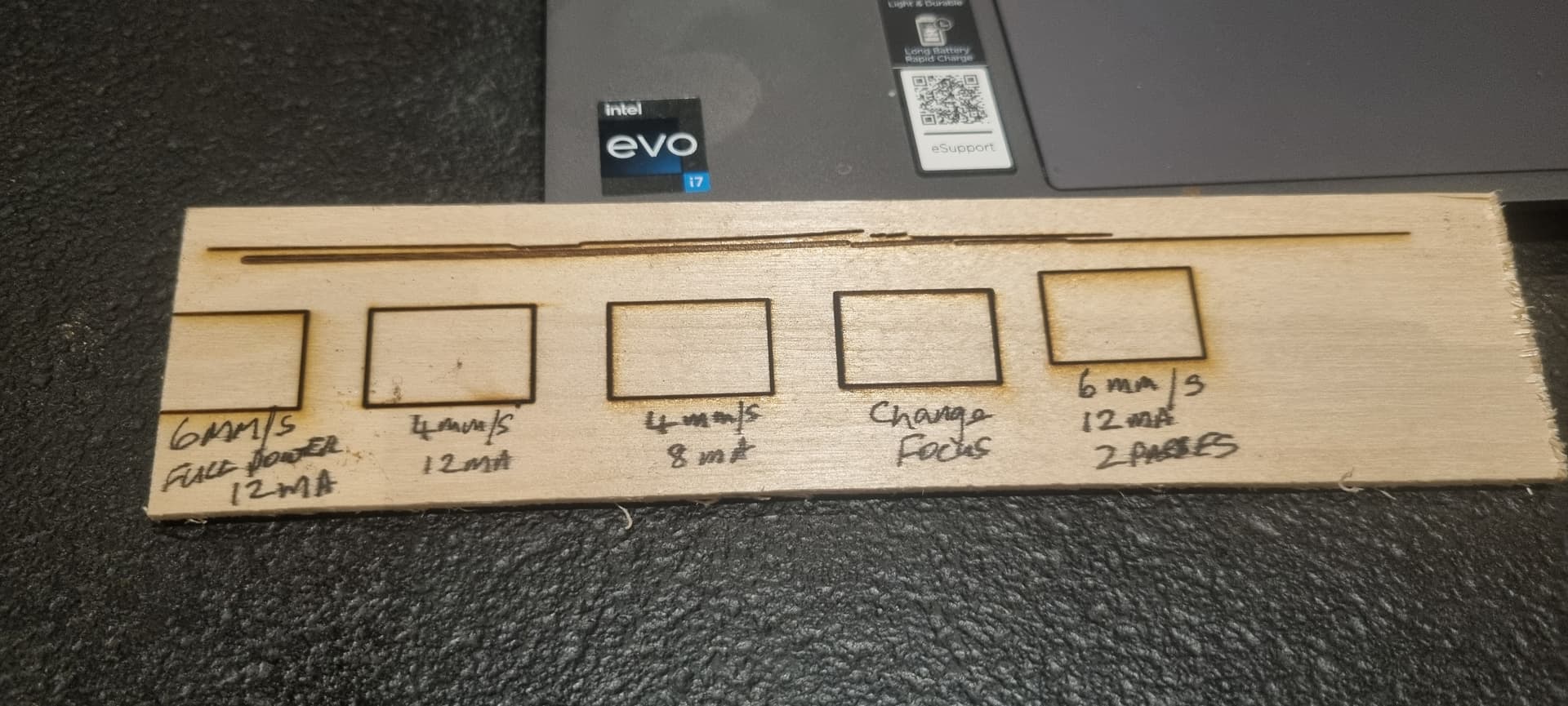

My K40 has been gathering dust for some years and I have now completely stripped it all out and built a new x y bed using 2040 profile and 6mm perspex cut out on my cnc router. I now have a workable area of 550 by 320 mm. Also new MKS DLC32. New mirrors etc and all aligned and focused. However when running at 14mA I seem to get a “nice” burn but no penetration. I’ve tried slow speeds and several passes on 3mm ply but no cut through. Is my tube knackerd?
Can we see some examples of what your laser did to your material?
Does your machine have an air assist?
I have temporarily used a very large inflated balloon for air flow…seems to work. The rightmost rectangle has 2 passes at full power (12mA) and shows no sign of cutting through.
