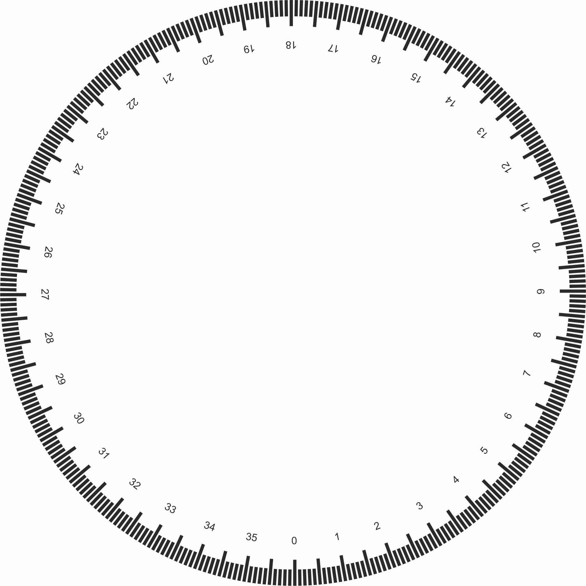

Hi everyone,
I’m trying to mark a degree scale around the edge of a flat disc using a fiber laser with a LMCV4-FIBER-M controller and a rotary chuck attachment.
Setup:
- Disc diameter: 180 mm
- Lens: F163, working field 110×110 mm
- Scale: major ticks every 5° (7 mm long), minor ticks every 1° (4 mm long), numeric labels every 10° (tangential, counting 0 / 1 / 2 / … / 35)
- Note: labels are section numbers 0–35, not degrees
Since the disc is larger than the working field, I need to mark it in segments, rotating the chuck between passes.
I previously tried EZCad’s Power Ruler plugin, but it causes EZCad to freeze or crash.
My questions:
1. Am I correct that the right approach in LightBurn is to use Repeat Marking together with Variable Text — one pass per tick group, rotating the chuck between passes?
2. In EZCad’s Power Ruler, you had to enter the workpiece diameter so it could calculate the arc length per degree. Where is that configured in LightBurn when using the rotary setup?
Any help or documentation pointers would be greatly appreciated. Thanks!

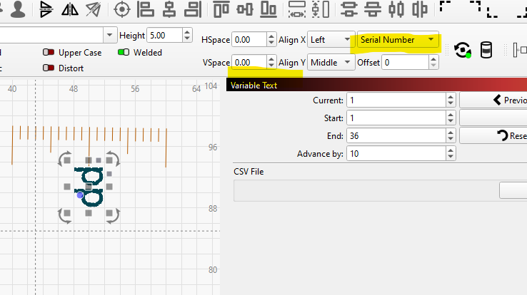

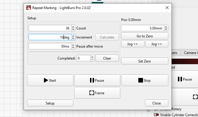

Play around with repeat marking and variable text
Similar application here but on the outside. Works good for dials and stuff like that. Quick example, you would need to tailor to your specific needs.
 ![image](https://forum.lightburnsoftware.com/uploads/default/original/3X/9/1/919831baa77d46bed48a20607a783bdd8321828d.png)
 ![image](https://forum.lightburnsoftware.com/uploads/default/original/3X/a/7/a7e2d9da96ece216ee43f0799d460735e42ce55d.png)

Another way to do this would be to just draw a straight ruler and use rotary marking. If the ruler is 360mm long and the bottle circumference is set to 360mm the marks will be the same as degrees when it’s run on a turntable. Select all the ruler marks and run them with a small split size so each one is done individually with a move in between. Then select all the numbers and run those separately with a wider split size.

More then one way to skin a cat. No matter what the cat ain’t happy.
The nice thing about the way I suggest is it is not so dependent on getting a hyper accurate measurement. It will always turn 360 degrees and always print 36 scales so the accuracy is self correcting instead of compounding.
