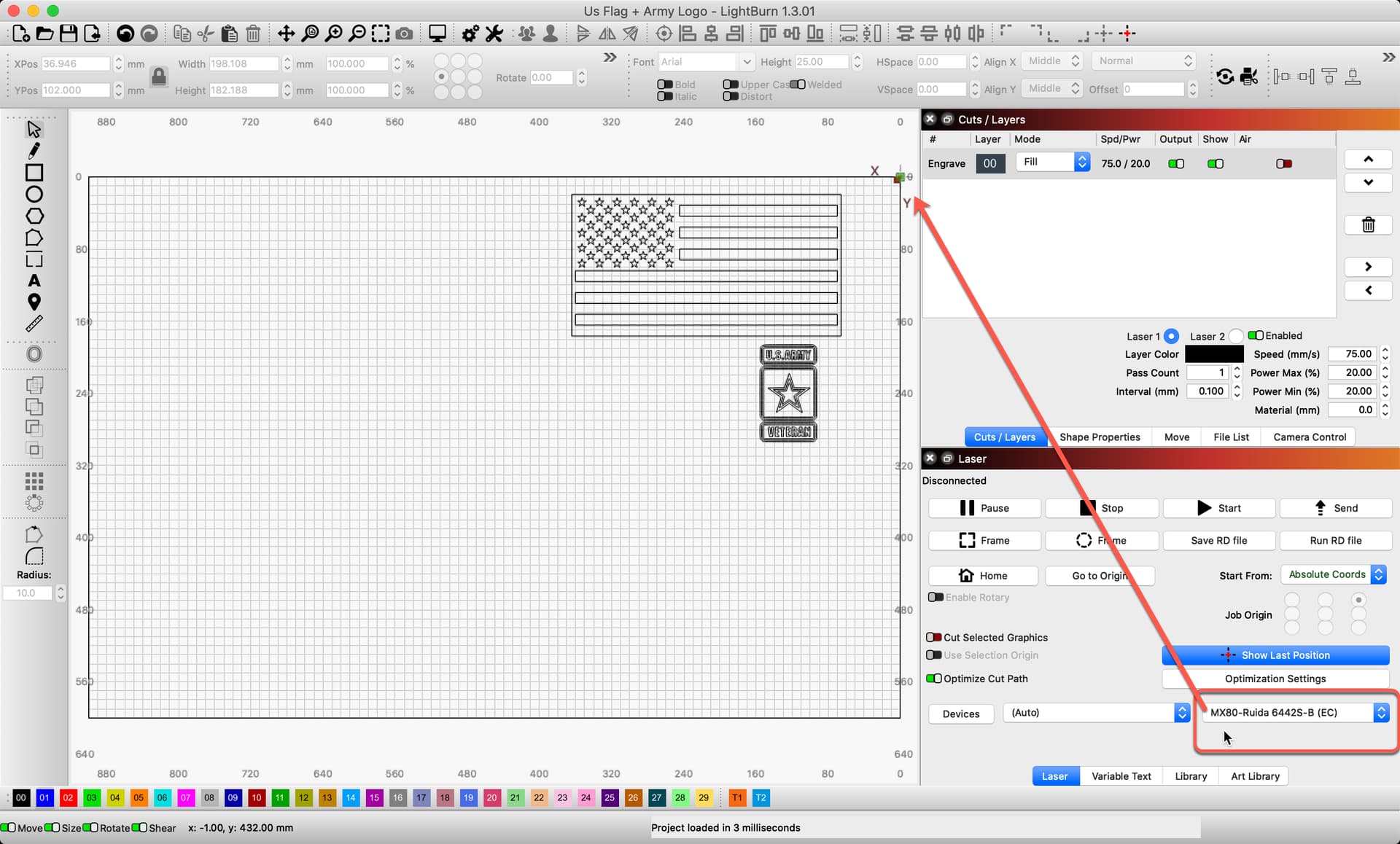

Automatic flipping of loaded projects
Anyone with more than one laser knows that loading a file designed with a different origin causes designs to flip or mirror. This version of LightBurn will automatically flip loaded project files to the correct orientation, regardless of where the machine origin is. (Note: you have to choose the device first, then load the file)

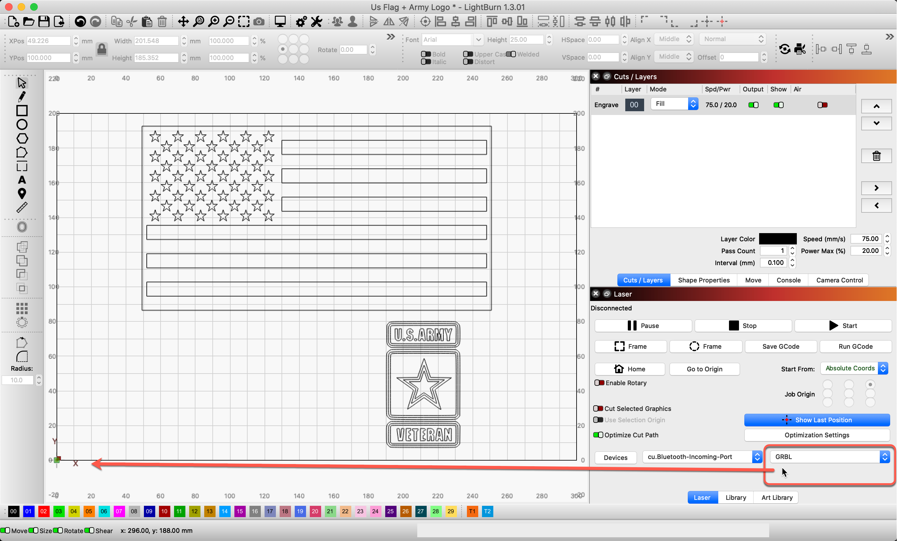

Here I show exactly what the same LBRN file opened after changing the device selected.
GRBL Device
Ruida Device
