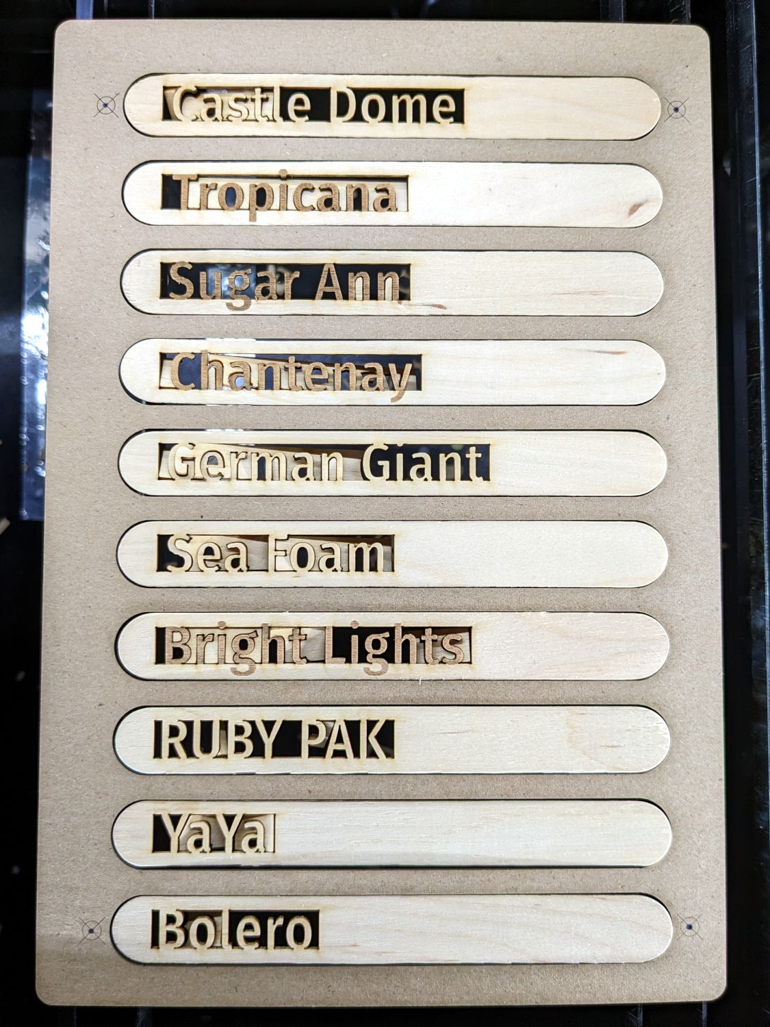

[Make a (cardboard / chipboard) fixture](https://softsolder.com/2023/04/25/craft-stick-plant-markers-laser-fixture/) covering the machine platform with cutouts for as many sticks as will fit. This fixture held ten markers, because that’s a nice number:
[![](https://softsolder.com/wp-content/uploads/2023/04/pxl_20230421_235406800-craft-stick-markers-fixture-first-fill.jpg) ](https://softsolder.com/wp-content/uploads/2023/04/pxl_20230421_235406800-craft-stick-markers-fixture-first-fill.jpg)
The template matching that fixture guides the text placement:
[![](https://softsolder.com/wp-content/uploads/2023/04/craft-stick-plant-markers-fixture-layout.png) ](https://softsolder.com/wp-content/uploads/2023/04/craft-stick-plant-markers-fixture-layout.png)

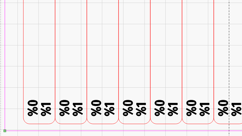

Those involved few enough markers that I did them by hand, but I used a [CSV merge](https://docs.lightburnsoftware.com/2.1/Reference/VariableText/VariableTextFormatting/#mergecsv) for [another set](https://softsolder.com/2022/05/18/omtech-60-w-laser-plant-markers/):
[![](https://softsolder.com/wp-content/uploads/2022/05/plant-markers-variable-text-template.png) ](https://softsolder.com/wp-content/uploads/2022/05/plant-markers-variable-text-template.png)
If you know you’ll need, say, ten markers for each type of plant, use the same CSV `Offset` in the `%0` (or whatever) text field for those ten template locations. Alternatively, just duplicate the line ten times in the CSV file.
