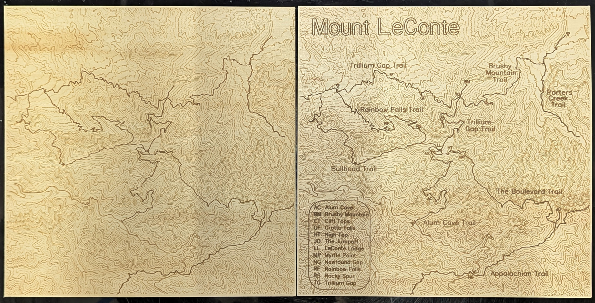

One of my favorite places to hike is Mount LeConte in the Smokies, and when no better ideas came to us, my wife and I decided to spend our anniversary on another mostly-hiking trip. We’re actually going to stop for a night at the Len Foote Hike Inn in Georgia (a 5-mile hike from the top of Amicalola Falls), then spend a week staying in Gatlinburg and hiking multiple long hikes, and to cap off a perfect plan, we snagged a cancellation spot at LeConte Lodge (the primitive hike-only spot right on top of Mount LeConte).
I’ve apparently made it my tradition to make some sort of… gifts, I guess… to bring up to the Lodge and share with the staff, other guests at our table, and so on. Last November, it was a rather significant amount of fiber-laser-engraved slate (coasters and several 8- and 12-inch square trail maps), but given the short lead time (and perhaps a desire for a bit lighter pack), I figured this trip’s medium would be basswood plywood.
Given the size I was thinking of (12"/300mm squares) I wanted to do something a bit different than just a simple trail map (as nice as those are). My first concept was a cut-and-stack 3D “sculpture” made by laser-cutting elevation contour slices. It could potentially be a two-laser process, cutting the slices on the 100W CO2 gantry laser and then engraving them on the CO2 galvo, even.
I downloaded the 1m-resolution digital elevation data from the USGS via The National Map web site. I could then load all those files into QGIS to combine them into a single elevation layer. I could then use QGIS to extract contours from that layer using various and sundry parameters.
Trying multiple contour spacing options, it was obvious that making a sliced and stacked model wasn’t going to be something I could do easily or quickly, but making a flat engraved trail map with elevation contours seemed feasible and likely to make a nice result. Spacing the contours every 125’ of elevation gave a pleasing distribution, and if I varied the strength of the engraving, I could burn the major contours at 500’ increments with the intermediate ones set such that they fade as the slope goes upward.
I pulled the trails from OpenStreetMap data, which I downloaded and then culled to the required segments in QGIS. I also included Newfound Gap Road, as it ties together two trailheads (and has a loop and a little Godzilla hiking the Appalachian Trail). I then exported each set of contours, the trails, and the road as separate SVGs. I loaded those into Inkscape in order to use the Hershey Text plugin to make the trail labels. (The map title is just the National Park Typeface as a standard font.)
Finally, I loaded the very large SVG from Inkscape into LightBurn, which handled the rather excessive path data with aplomb. (LightBurn actually handled it much more responsively than Inkscape.) I set four progressively faster speeds for the four sets of contour lines, plus additional settings for the road, trails, and labels, all at 100% of my CO2 galvo’s 30W:
  • Contour 000: 375mm/s
  • Contour 125: 750mm/s
  • Contour 250: 1500mm/s
  • Contour 375: 2000mm/s
  • Trails and Title: 100mm/s
  • Road: 200mm/s
  • Labels: 200mm/s with two passes

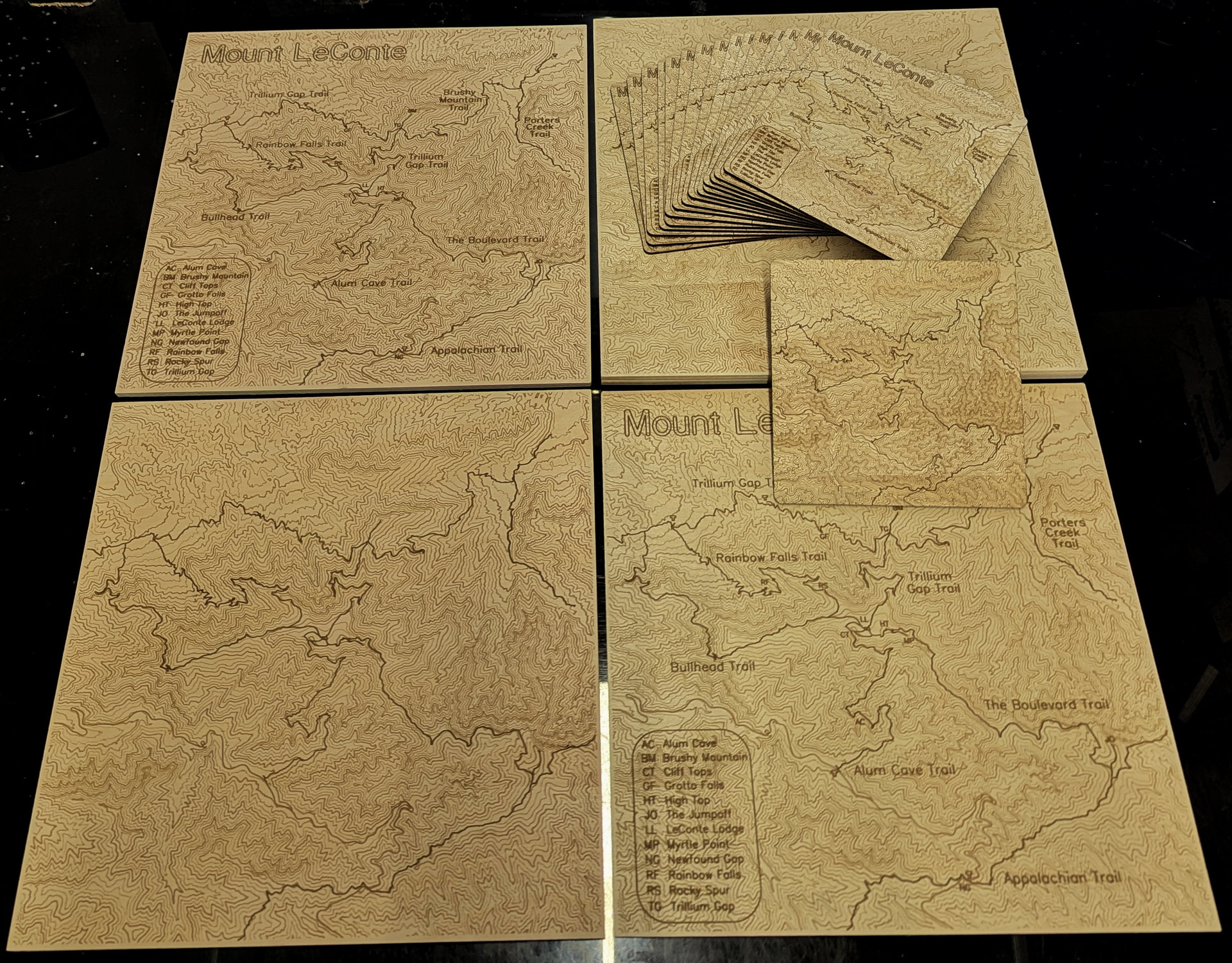

I was happy enough with the results I got using a 400mm f-theta lens on my upgraded CO2 galvo (20mm galvo head and 6x beam expander, IIRC, up from the 10mm/3x combo it was originally). I could do a full 12"/300mm engrave in 2:26 for the side with labels and 1:49 for the plain contours-and-trails side.
I ended up making five with 1/8" basswood plywood and a pair with 1/4" basswood plywood. (I also prototyped on 1/16" basswood plywood, but it wasn’t much cheaper at all than 1/8", and it was very floppy.) Of course, 12"/300mm squares a bit large for a general hiker to pack in their bag, so I figured I should make some 150mm/6" ones, too. For that, I just cut a few 1/8" pieces into four 150mm squares each (with 5mm rounded corners, since that’s so easy to do in LightBurn). I cut the squares on the 100W CO2 gantry laser while I was engraving on the CO2 galvo, so that was nice. (The engraving took the CO2 galvo about 80 seconds for the labeled fronts and just under a minute for the plain backs, using a 210mm f-theta lens for higher detail.)
It was fun to play around again with USGS and OpenStreetMap data in QGIS, and I rather like the results. (I intentionally didn’t clip out contours behind the text for this set, but if you wanted a gift-shop-style extra legible version, that would probably be a thing to do.) Anyway, it was a fun project, and one of these days when MillMage supports carving relief from heightmap data, I’ll have to try it out for another run of to-scale terrain relief models (and if I can eventually use my CNC router’s diode laser to engrave the trails right onto the surface without my old hacks, I’d be in maker heaven, hehe).
