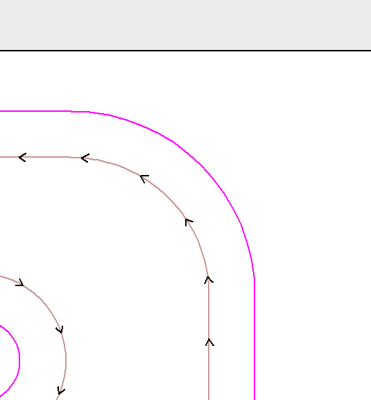

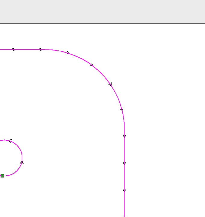

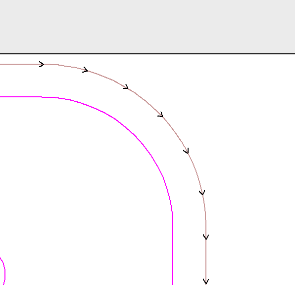

Hello,
Another software I use let’s you choose to cut on the line, inside the line or outside the line.
You can do this by setting a kerf offset for your tool, in device settings for example, then when you set the “Line” settings there would be an option of where to cut and the kerf setting would be applied automatically.
I’ll attach examples.
Would also be nice to see the actual profile with the cut line in the preview window.

Already exists, except it doesn’t show you how the offset applies to the original shape.
Don’t see how it already exists in that link?
Unless you’re referring to applying a kerf offset manually. I’m talking about it applying it automatically by selecting either on the line, inside the line or outside the line when creating the toolpath. So the “line” settings would have those three options in the settings tab, your kerf would diameter would already be set in the device settings and that would be applied by selecting one of those 3 settings.
Yes I get it you can already set it manually but I’m talking about making the software better by having this done for you.
Make sense?
