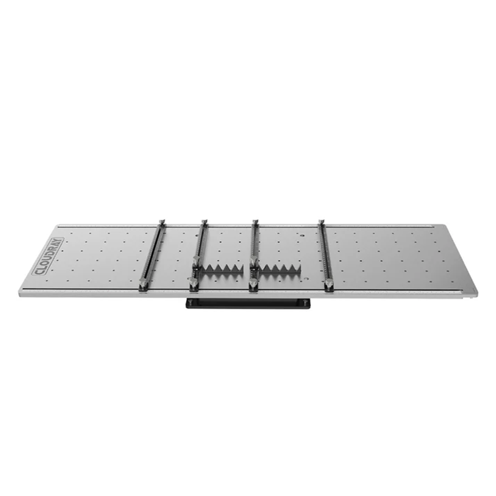

Someone here is really excited about getting this for the makerspace, but I don’t know what it’s going to do for us. It’s 1m with 700m of travel expanding the enclosure and footprint quite a bit. Does Lightburn even support this?
It’s not guaranteed to line up seam-free here, because the F-theta lens and galvo isn’t perfectly distortion-free.
I’m just baffled what the use case would be to justify it.
> **[Working Table](https://www.cloudraylaser.com/collections/working-table)**
> The worktable seems to have nothing to do with lasers. When laser engraving, often due to environmental restrictions or workpieces, you need the worktable to help you fix the workpiece for engraving.One-dimensional Workstation: Z-axis...

I’m not sure, but it appears to require another driver for the table. They are working on a flying head type of machine that may be better as it’s a gantry with a galvo fiber mounted to it.
> [@Does Lightburn support a flying galvo configuration?](https://forum.lightburnsoftware.com/t/does-lightburn-support-a-flying-galvo-configuration/172502):
> I was hoping someone with Lightburn could answer us about this product. It’s a flying galvo head or a galvo on a gantry machine. It’s supposed to [go to Kickstarter this month](https://www.kickstarter.com/projects/accelaser/accelaser-hd1-worlds-first-dual-laser-with-flying-3d-galvo?ref=8gjw7y). Is it really Lightburn compatible ?.. claiming they have been in touch with Lightburn during the development, any comments? Wonder how some of this is implemented, such as LIDAR Z control, and assume gcode? Here is a quick video on two machines.. Originally posted by @HalfNormal on the Markers forum. [[EVE…](https://www.youtube.com/watch?v=q7zNaJnNbks)
I suspect the software for this is directed at certain products. xTool has something similar and it’s not supported by Lightburn.
Unless they talk directly to Lightburn development team, I’d assume it isn’t compatible.

Seriously I love my XY table, leave the table in place all the time and leave the rotary mounted at one end (unless I have something really long), and then just motor it back and fourth under the lens when needed. Lots of room for jigs and clamps and stuff. I don’t like the price on that cloudray table, an IndexX is less than that and looks a little beefier. Nice low profile though. Looks well thought out. I ASSUME it is motorized and runs off the rotary axis, didn’t really see that in my quick read through.

If you are going to get it, get it from the person Cloudray ripped it off from. [Maxce IndexX Set - Maxce | laser marking accessories](https://maxce.com/product/maxce-indexx/) its also cheaper from the guy who invented it.
Lightburn works fine with the Maxce indexx
If you look at the the Maxce website it will show, it uses, how to set it up etc..

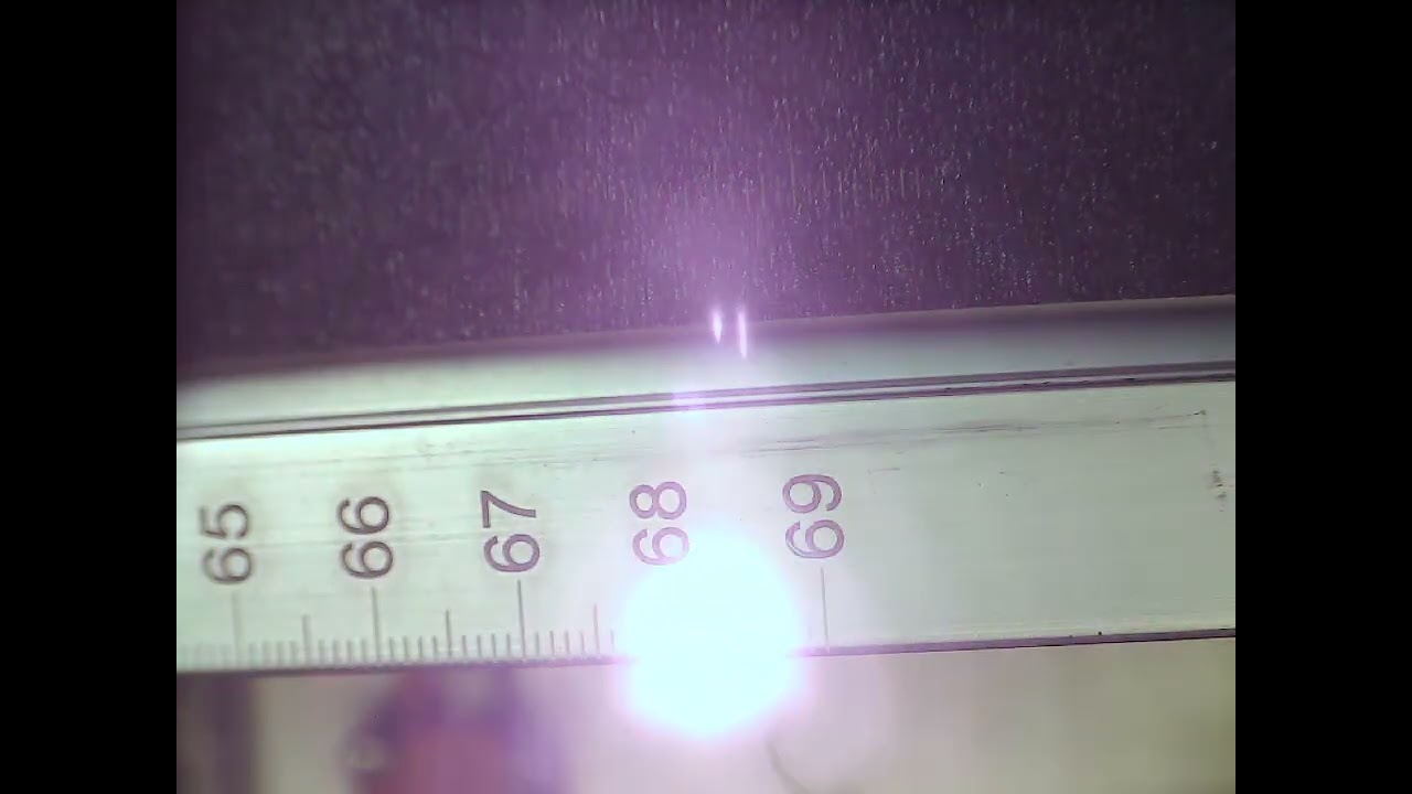

I’ve gotten pretty accurate results with repeat marking, split marking, etc with the older versions. The new versions we can up the split size over 100mm to take advantage of larger lenses, old LB split maxed at 100mm not thinking we would be rocking tables. Neither the math or setup changes between flat and round. Just terminology.
[![](https://img.youtube.com/vi/Qv1ThdLHyR8/maxresdefault.jpg "Ruler on a linear table") ](https://www.youtube.com/watch?v=Qv1ThdLHyR8)
