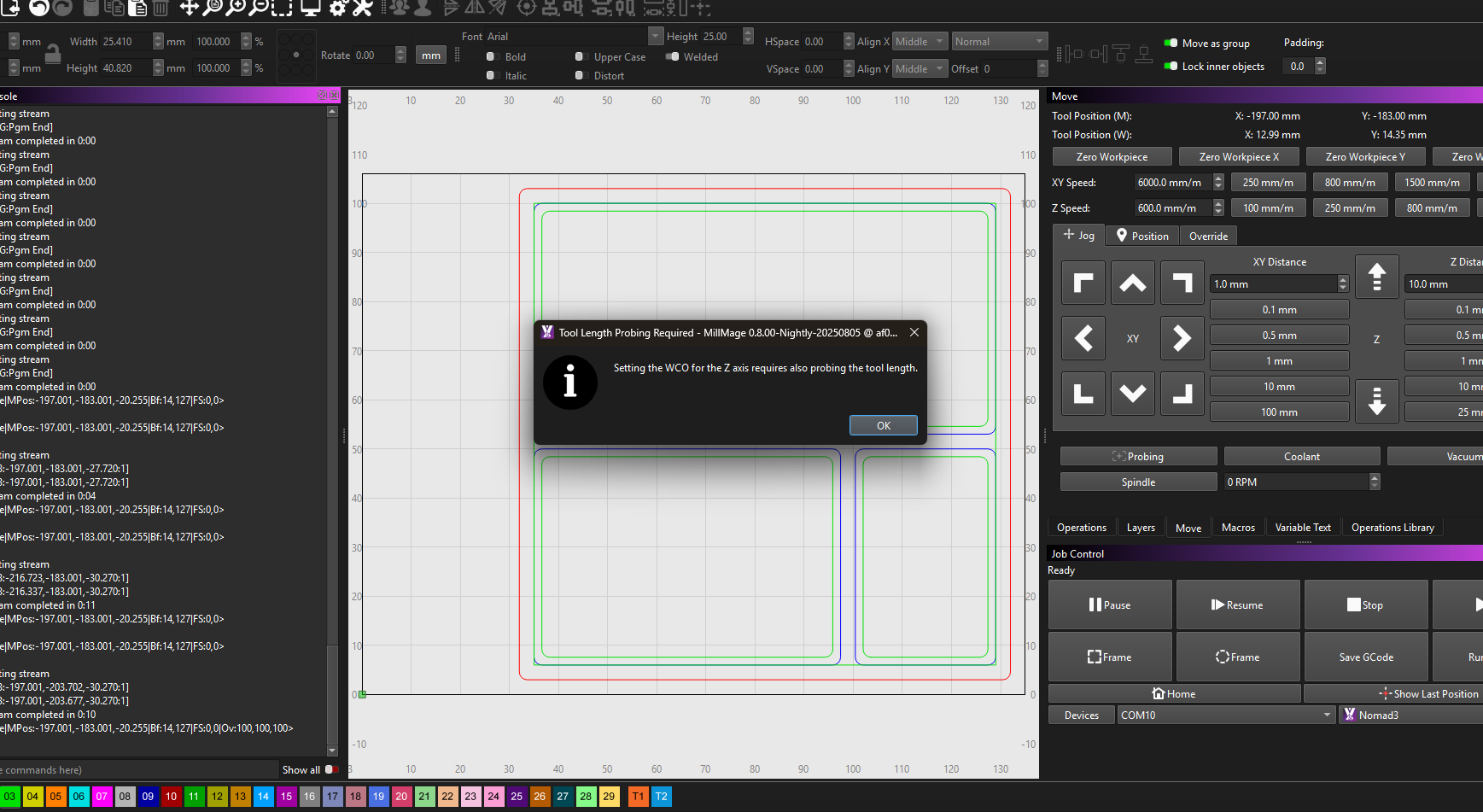

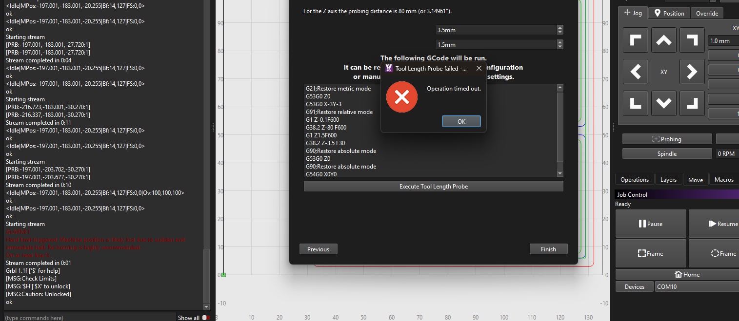

I’m able to go through the Carbide puck probing process successfully on the Nomad³ on today’s nightly and get the same “Setting the WCO for the Z axis requires also probing the tool length.” dialog afterwards. When I run the Tool Length Probe, the tool is moved away from the puck and towards Zmin, triggers the Z axis endstop sensor and errors out with the “Hard limit triggered” message in the console, and with the “Operation Timed Out” dialog pictured immediately afterwards. I’ll write this up on our side tomorrow. Do you get the same message?
Are you able to run the Tool Length Probe routine without hitting the Zaxis hard limit message and resulting stop?
Edit: Changing this line in the Tool Length Probing Custom GCode block lets the Tool Length Probing process proceed without hitting the Z-axis hard limit error.
G53G0 Z-1
This is what I’m using now for the Nomad³ Tool Length Probe Custom GCode. Once you enter your probe configuration, change the G53G0 Z0 value to Z-1 in both lines. With that change the Nomad completes the probing processes without hitting any of the endstop hard limit errors. YMMV, but I’m curious to see if this works for you as well. I’ve ran this on our nightlies, RC4, and RC5.

G53G0 Z-1
G53G0 X-3Y-3
G91;Restore relative mode
G1 Z-0.1F500
G38.2 Z-150 F500
G1 Z1.5F500
G38.2 Z-3.5 F50
G90;Restore absolute mode
G53G0 Z-1
G54G0 X0Y0
