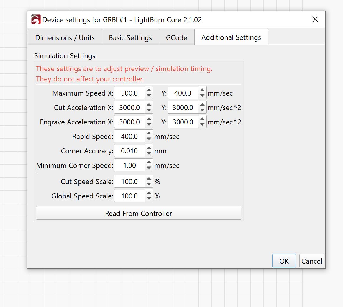

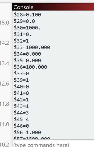

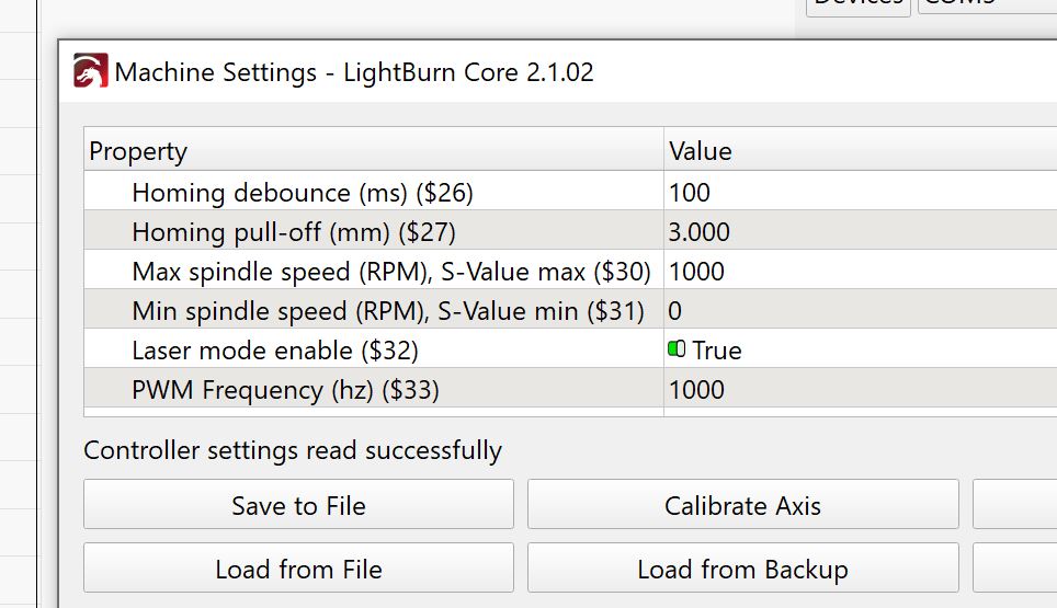

My problem im sure is me few years ago i up dated my ortir 5 watt laser with a lu2-10a 10 watt laser was never happy the way it cut not twice the power or spped it finaly crap out crack outer lens bubble on inner lens yhought maybe i just got a dud bought after market no longer on website perhaps counterfit so got new from amazon said suppy from ortur same thing have to go 25 mmpm to cut 3.5 mm plywood at 100% power i have screen shot some of the settings i think have something to do with it please help if anyone needs to look at differnt setting let me kno

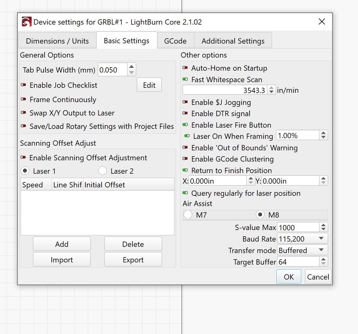

misstake on my part id have set to in/min i did find this

The additional settings tab only governs the Preview/Sim timing (used for job time estimates) it does not affect your laser output. I’d recommend verifying your units via @parsec’s referenced post here: [PSA: Unit Settings Changes in LightBurn 2.1 – LightBurn Software](https://lightburnsoftware.com/blogs/news/psa-unit-settings-changes-in-lightburn-2-1?_pos=1&_sid=ec607ebec&_ss=r)
