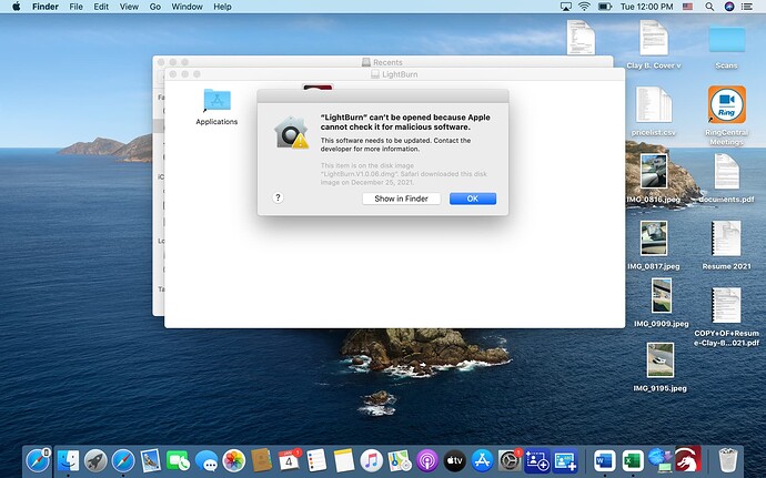

When I try to download to Safari, I get a message that says " cannot check for malicious software" and will not let me proceed.
Screenshot please.
We have installation instructions for MacOS:
https://lightburnsoftware.github.io/NewDocs/Installation.html#macos-installation
It still will not let me download.
There’s a video linked there. You must copy the LightBurn app into your applications folder first, and run it from there by holding Control+click, and choosing ‘Open’. If that doesn’t work, it’s possible you’re on a newer version of MacOS where they’ve changed it yet again, and have to go to your security preferences to allow it.
For clarity. You have already downloaded the file and have opened the .dmg file. From there is where you follow Oz’s directions.
