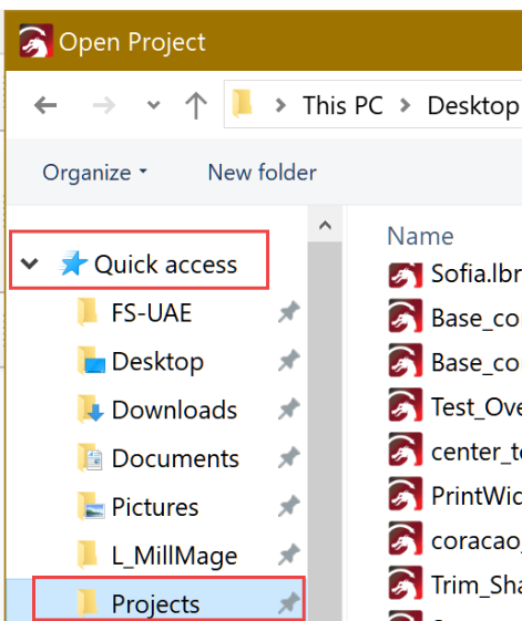

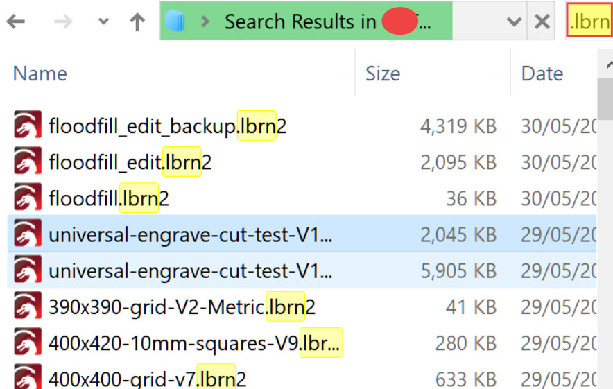

Just a few tips here:
> [@Just updated to 2.1](https://forum.lightburnsoftware.com/t/just-updated-to-2-1/189920/8):
> You already tried that sorry. Try importing the laser device .lbdev file and test. Also do a search in the computer for .lbrn files to find where they are. Just so that you know always where your files are I´ll let here a tip from LAhobbyGuy: Also you can pin a folder to Quick Access: So when due to any “quirks” Lightburn doesn´t find the files you can easily find them:
