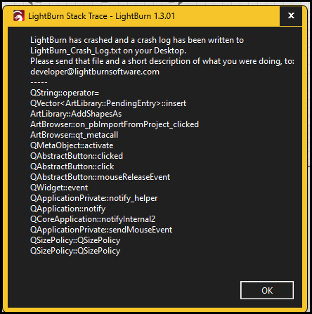

Hey, I’m new to LightBurn and I keep getting these errors every time I try to import a second graphic to the Art Library. Sometimes, the software will crash, but most of the time it keeps saving the graphics as an error symbol. Any suggestions?
 ![Screenshot 2023-03-09 152131](https://forum.lightburnsoftware.com/uploads/default/original/3X/3/4/34715f18c2bda4fe322a4ac7924f52af33de8ba6.png)
 ![Screenshot 2023-03-09 152304](https://forum.lightburnsoftware.com/uploads/default/original/3X/2/5/25b22863a07a504e9619e0b21a057800e451f846.png)

Are you able to share the file that you’re having a problem importing? I can try to recreate the issue here.

Try creating a new Art Library and loading there. Perhaps some sort of corruption.

I’ve even tried to do that and the same thing happened.

I wouldn’t normally recommend but it’s an easy check. Try reinstalling LightBurn. You can just install on top of your current installation. See if that makes a difference.

I just tried it this morning, unfortunately no difference in the error. I had deleted all previous .lbart files and made a new one. It worked when I selected all of the graphics and imported them in the new .lbart file, but after that, I couldn’t save more than one graphic in that file.

Question, are you possibly storing the .lbart files in a cloud drive or NAS storage? If so, that could be contributing to these issues.
Otherwise, do you have a series of steps that will reliably create this problem?

The problem seemed to be that I was saving the files in a cloud drive. I saved it to my “downloads” and it fixed the issue. Thank you so much! 😄
