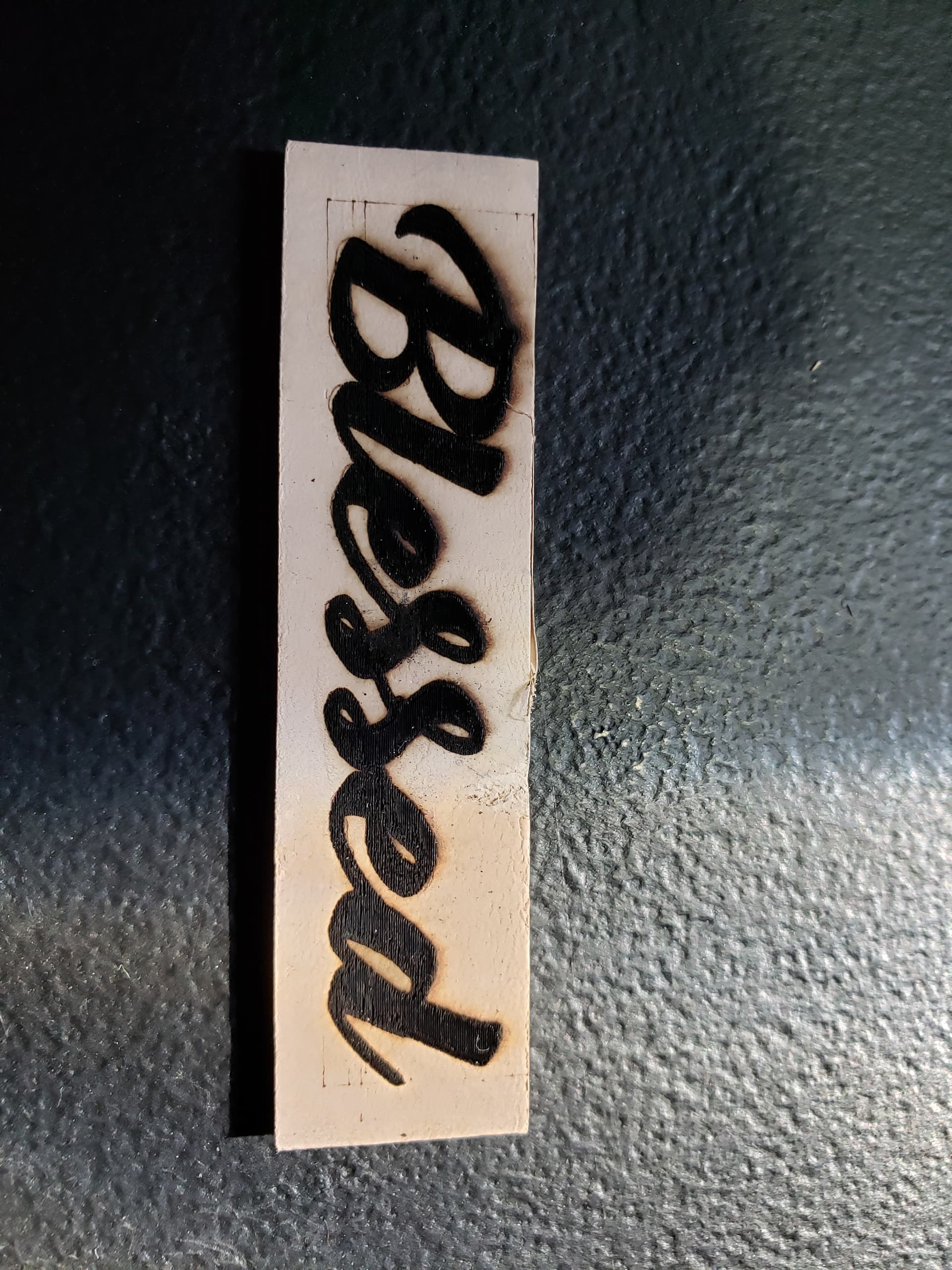

Dear Lightburn,
Recently I upgraded my laser to a Sculpfun S9. Immediately I started getting artifax around the text or image when I burned it See enclosed image. Note: I checked the preview and did not see the artifax there.
My controller is a Ardino Nano 328P card using Grbl ver 1.1H and my Lightburn setup is GRBL using ver.1.0.06.
Here are my GRBL values:

In the image you can see a thin line framing the text .
Hopefully you can help me fix this. Note I never had this problem with my previous laser.

Enable laser mode.
$32=1
Thank you berainlb
That seems to have fixed the problem. I am testing it now
