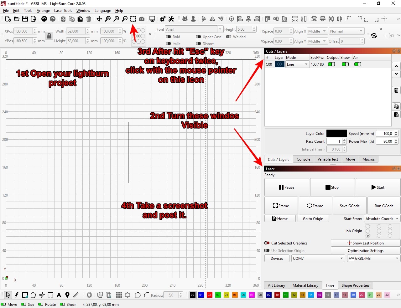

I have been using my Falcon2 diode laser happily for some time. I now have a problem framing my projects for some reason. I load a project on to the work area of LightBurn I then Select it as usual and when I command the Laser to frame it moves from the home position to the centre of the end of laser near the emergency stop button and the if frames only 5 Inches in the X direction and 3 inches in the X direction.

A screenshot of the project made it easier to point you in the right direction…
Based on the current information, I would say that the “Start From” setting is present in the “Laser” window under “Absolute Coords”.
If this is not the case, open the project with the “Laser” window visible.
Make sure nothing is selected by pressing the “Esc” key twice.
In the toolbar, click on the dashed square (right side of the magnifying glass) or, if your operating system is Windows, use the shortcut Ctrl+Shift+A.
This should show everything in the workspace, even if it has been set to “not visible”.
Take a screenshot and post it here so that anyone who can help has some more information.

ESC key (on keyboard) not in toolbar. Sorry if I don’t make myself clear.
Don’t worry, we are here to help you!
Let’s try with a drawing :wink:
