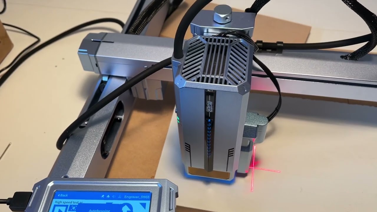

Auto focus quite working, worked great, then it will stick at the bottom, top or middle. When you turn the round knob at the top it will start, but will not complete. With this issue it will not home either.

Something like this?
[![](https://img.youtube.com/vi/f6VaqrRwKJo/maxresdefault.jpg "Ikier K1 Pro Max Autofocus issue") ](https://www.youtube.com/watch?v=f6VaqrRwKJo)
Then it is likely that you need to replace the z-axis motor.
If it is the same software as ikier then you can look at settings on the screen and change the setting for autofocus to off. Then it till home in on x-y without z-axis, even using lightburn. It is a workaround so you can focus manually and use the machine until the z-axis was fixed.
