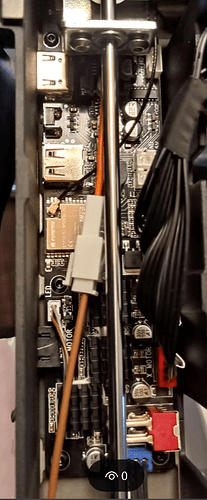

I have just gotten an Atomstack A12 pro. I changed the settings so that it connects to my wireless network. I tried to connect to the laser with a webbrowser but it only says: “no handle”. I tried to update fluidnc through the webinstaller (it said it could update without losing files) after that I could connect to lightburn on port 8080 now. However the webinstaller wants a config.yaml would anyone have one for an atomstack A12pro/S12pro/X12pro ?
Grbl V1.058 [‘$’ for help]
[VER:V1.058.Nov 16 2023:]
[OPT:HLSW,512,2048]
 ![Atomstack A12 pro mainboard](https://forum.lightburnsoftware.com/uploads/default/original/3X/b/b/bb2ac0a0bffbc55fb77422b62a0334f18cd5fb79.png)

Check this one and adjust per your setup:
> **[fluidnc-config-files/contributed/LS\_ESP32 at main · bdring/fluidnc-config-files](https://github.com/bdring/fluidnc-config-files/tree/main/contributed/LS_ESP32)**
> Configuration files for FluidNC. Contribute to bdring/fluidnc-config-files development by creating an account on GitHub.
Also:
> **[fluidnc-config-files/official at main · bdring/fluidnc-config-files](https://github.com/bdring/fluidnc-config-files/tree/main/official)**

I think that machine has ESP32S3, that micro is not supported by FluidNC. I’ve been looking into it for my machine.
