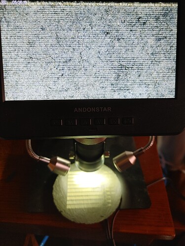

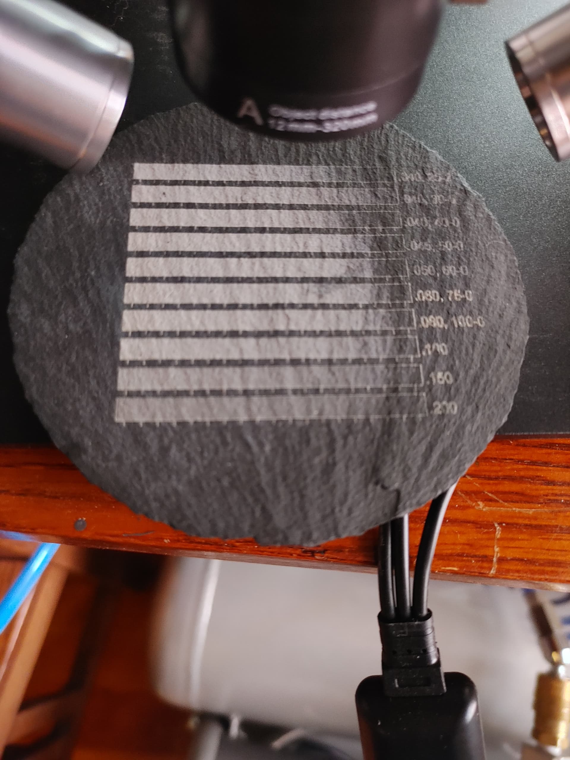

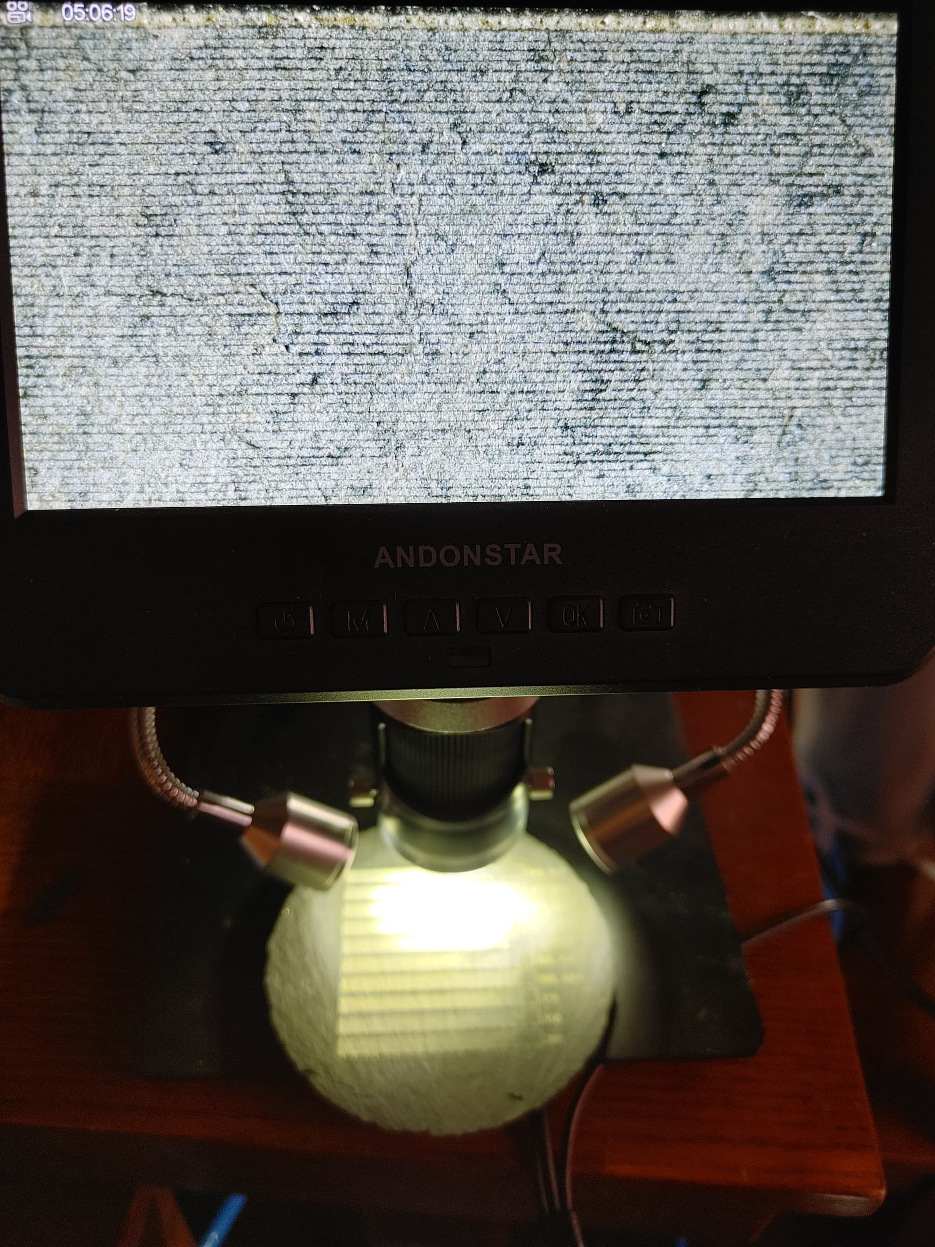

One set of MANY tests… I don’t trust mfg specs but I do trust my eyes.
.040mm is on the screen. Notice the gaps.
The effect on the slate changes as power increases. Wider burns as power increases. Full effect (white) produces about .06-.07mm lines but that leaves plainly visible gaps/stripes in darker shaded areas. The .040 is my compromise interval for greyscale…slight overlap at highlights and slight gaps at lowlights. That skull above was not dithered so could have been run at .06, but it was a test as well and turned out real nice anyway (IMO).
Edit: this is NOT from the Ikier. That machine can do .1mm on slate, on a good day. This is from the 5W Algo

Ok, can’t argue with that… with that small of an interval it’s going to take longer to run…
Did you think about a slight de-focus to fill it up a bit?
