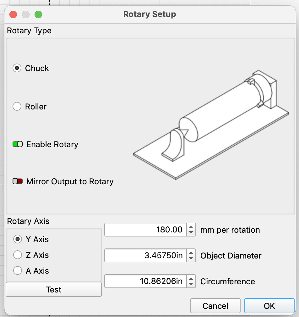

Hello All,
I’ve spent a couple of hours trying to figure this out. Please forgive me if this has been addressed. I really did try to figure this out. 🙂 But i’m beyond frustrated at this point.
I’ve been using my Atomstack R1 Rotary Chuck for about a year now. Last week, it stopped turning. My laser was trying to run the job, but the chuck was stationary. I assumed the wire was shot or the rotary was just done. I purchased a Atomstack R8 Chuck to see if that was the issue.
So I’ve been working all morning on this. BOTH cables (from the original R1 and the new R8) produce the same results. The chucks turn but have a VERY loud grinding noise and vibrations. This exact thing happens on both. In addition, I have a Roller that I’ve never had issues with but that now does the same grinding noise.
NOW - I have a Creality Rotary Chuck and when I connect that, it works perfectly.
I have a Creality Falcon 2 Pro. Running from Mac.
If anyone can help me, I’ll gladly buy you a coffee. 🙂
Sorry if this is long, but if there someone who can help me, I want to provide all of the info I can. Oh,
 ![Screenshot 2025-10-30 at 12.11.21 PM](https://forum.lightburnsoftware.com/uploads/default/original/3X/3/6/36cd8376b0ae25f704338513f0acb076cc83027e.jpeg)
 ![Screenshot 2025-10-30 at 12.11.05 PM](https://forum.lightburnsoftware.com/uploads/default/original/3X/e/e/eee179d62d3a1bd85e7d0afbf1ecaf8e45b5b4f9.png)

> [@yeslek](#):
What happens if you unplug the Rotary and hook the Yaxis motor back up?
Are you plugging the rotary into the Yaxis cable or into the controller board?
That **Alarm 9** happens because the rotary has no limit switch. It can make multiple rotations. You must turn off **Auto-Home** in Lightburn and/or set GRBL parameter to **$22=0** (don’t forget to set it back). I made a couple of Macros for this on my machines.

Hi Mikey,
Thank you so much for taking the time to help me. I’m so ignorant when it comes to this program.
I did have it set okay. Have done a lot on the machine and the rotary cutter, but i must have messed something up.
I disconnected the rotary and put the 4 prong into the machine. Shut it down and brought it up and got this:
Homing
error:5
Homing cycle is not enabled in your Grbl settings.
inquire\_info-\>power:60W ,CV50-LASER-60W-Release V3.0.5 20240325-0950
Now my “home” is the top/right instead of bottom left. I’m so so upset about this.
Would it be worth it for me to delete Lightburn and then reinstall it?

YAAASSSSS! I was so happy that worked! Thank you thank you thank you!
I’m going to give the rotary thing another try. Maybe with it reset, it will work!
You’re the best! I’ll try and check in soon!
<div class="post-metadata">
**Author:** ![yeslek](https://forum.lightburnsoftware.com/letter_avatar_proxy/v4/letter/y/a8b319/32.png) [@yeslek](https://forum.lightburnsoftware.com/u/yeslek)\
**Post date:** [October 31, 2025, 4:35pm UTC](https://forum.lightburnsoftware.com/t/atomstack-rotary-issues/184414/20 "2025-10-31T16:35:53Z")
</div>
Well, it’s working! But the Atomstack is doing the same thing. The grinding and sputtering.
thelmuth suggested that I may need an adapter, but I’ve never had to use one prior. And it literally stopped working overnight. I completed an order of etched glasses the day before with zero issues.
I don’t know why it would stop working.
I’m still getting Alarm 3 and 9 in Red.
ALARM:9
Homing fail. Could not find limit switch within search distance. Defined as 1.5 \* max\_travel on search and 5 \* pulloff on locate phases.
ALARM:3
Reset while in motion. Grbl cannot guarantee position. Lost steps are likely. Re-homing is highly recommended.
[Next page](https://forum.lightburnsoftware.com/t/atomstack-rotary-issues/184414.md?page=2)
