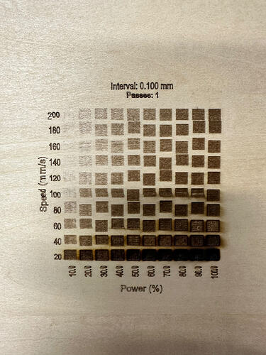

Why would my test grid look like the picture shown? This is my first machine so I’m completely new and got a fairly cheap machine (Swift 7w) but it seems to be working great until I try to run the test grid. I think it might be due to slight warping in the material (3mm basswood) if that’s the case then obviously I know what to do but what else could cause this if that’s not the
 ![IMG_1454](https://forum.lightburnsoftware.com/uploads/default/original/3X/b/b/bb472bd66bc13ec1390277bc0f220eb756cd4140.jpeg)

There are problems in the mechanics, mostly in the y axis. Maybe go through this guide: [Guide to mechanical adjustments and maintenance](https://diode-laser-wiki.com/documentation/guide-to-mechanical-adjustments/) and check for errors.
